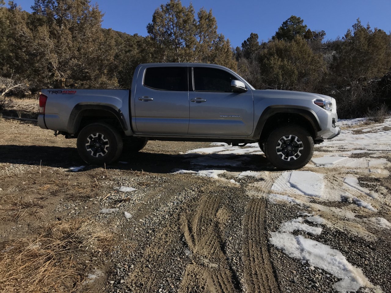

    F: OME 888 / with OME nitro chargers
    R: OME Dakar Medium / w/ OME nitro chargers
    Stock UCAs
    No spacers or blocks
    Sits a tad high in the back and Gained ~ 2.5 + all the way around.
    I'll keep the wheels as I like them. Still wearing out the stock tires but eyeballing 265/75/16. 255/85/16.

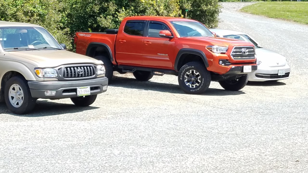

    How she sits now.

    Time to ditch those side steps and save up for some new rubber on those rims.

    I agree 100%, but , being the frugal person I am, I have a hard time getting rid of tires that are perfectly good. When they wear out...thats a different story.

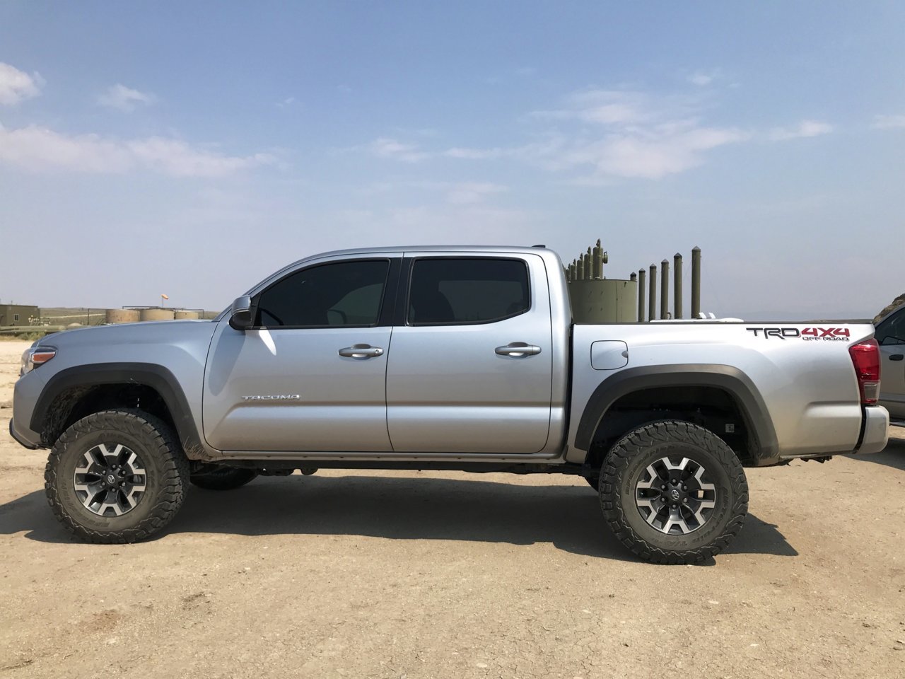

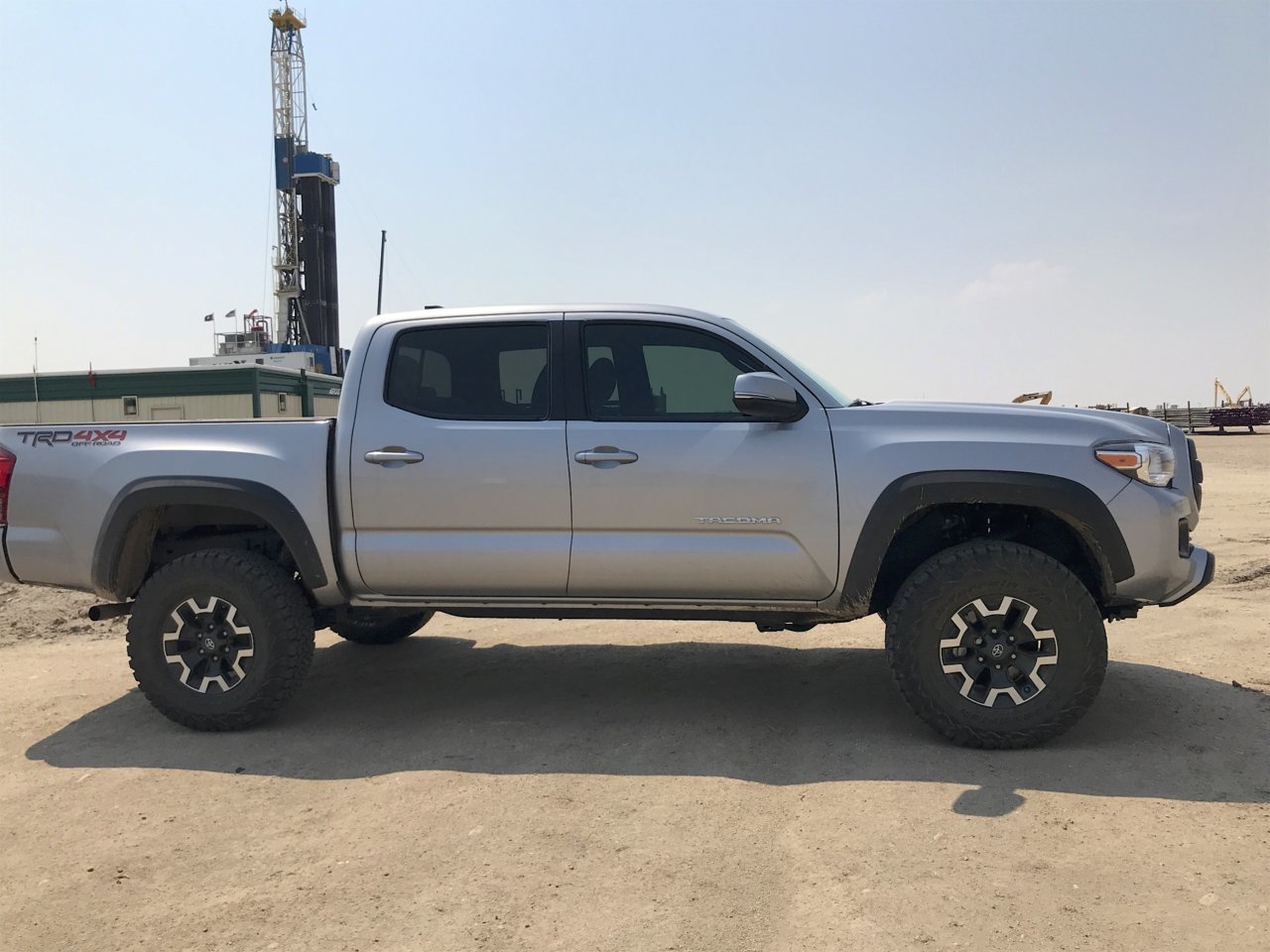

    with 888 coils / Nitrocharger up front and the Dakar Med. leafs on 90021 shocks, the ride is firmer, or more damp than stock. It just feels planted and in better contact with the ground. In uneven terrain it is actually more compliant than stock. I can get the back end to squat after 500lbs. Very happy with the whole package.

    I went with the 265/75/16. Perfect package: see photos below.

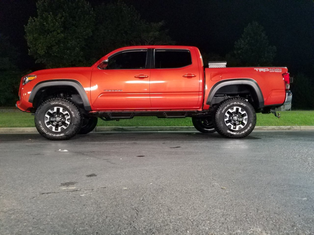

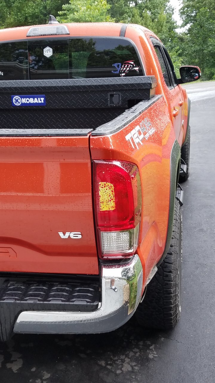

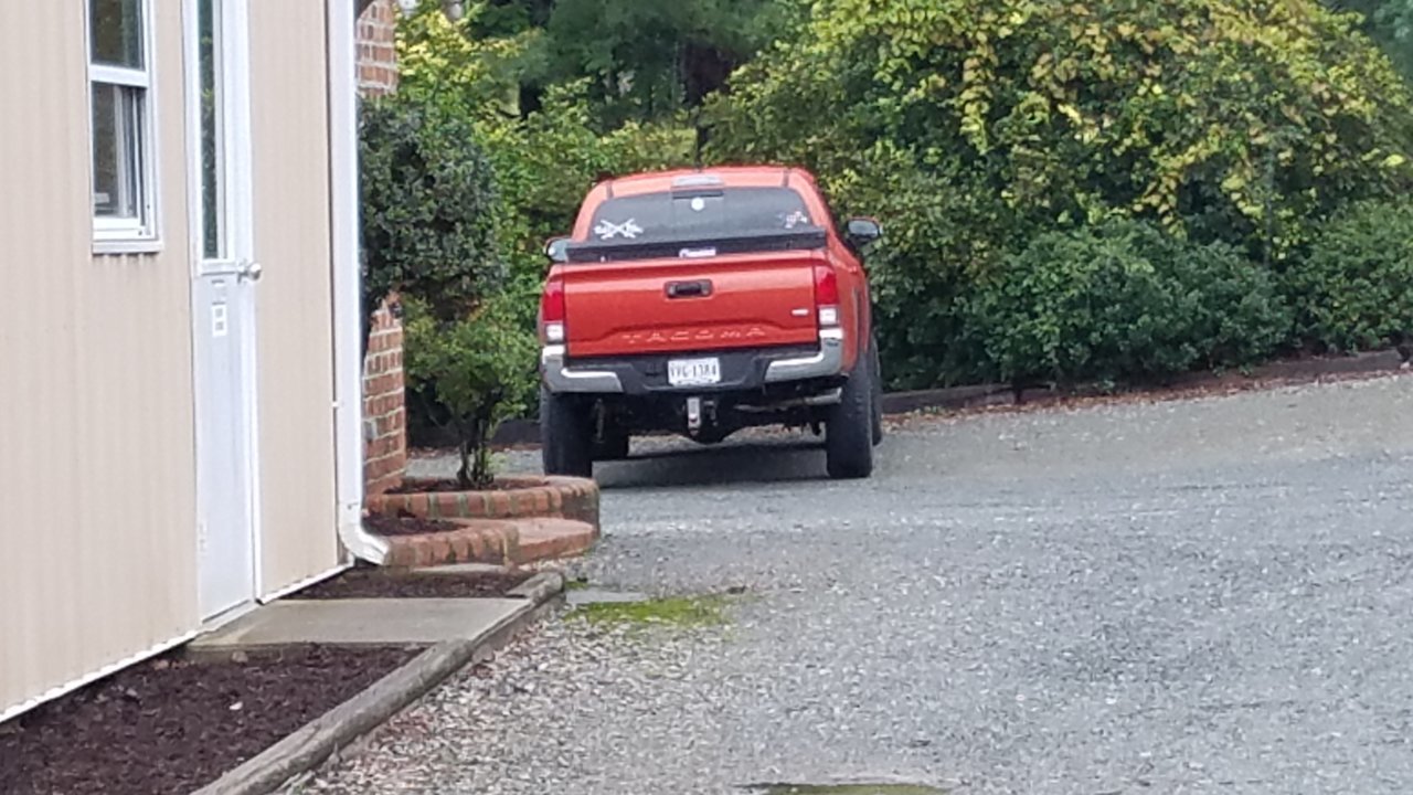

    3 inch all around, 265/75r16 with 1,25 spacers.

    Was wondering if I should go with 285/75r16 insted
