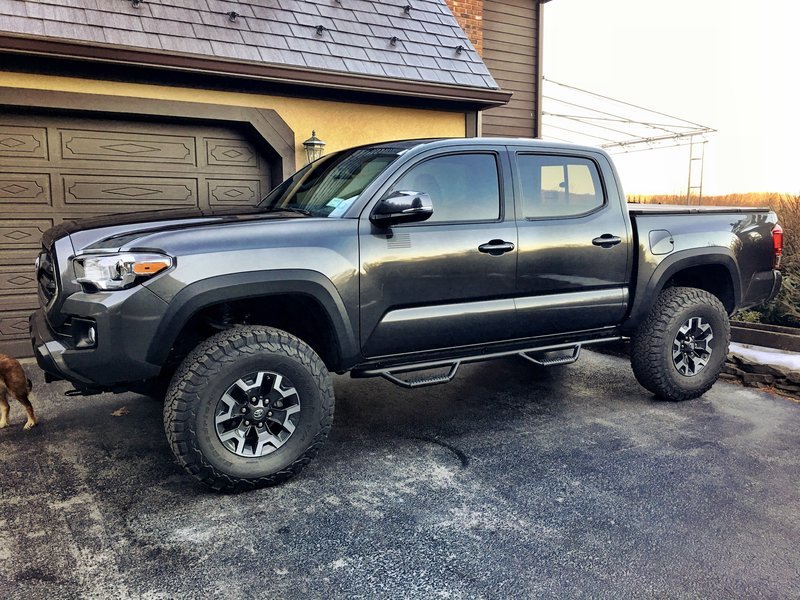

    Blake
    2016 Tacoma TRD Off-Road Double Cab
    285/75/16 on stock OR rims with a 3/2 leveling kit. It only rubbed at full lock. I added 1.25" wheel spacers and now there is no rubbing ever.

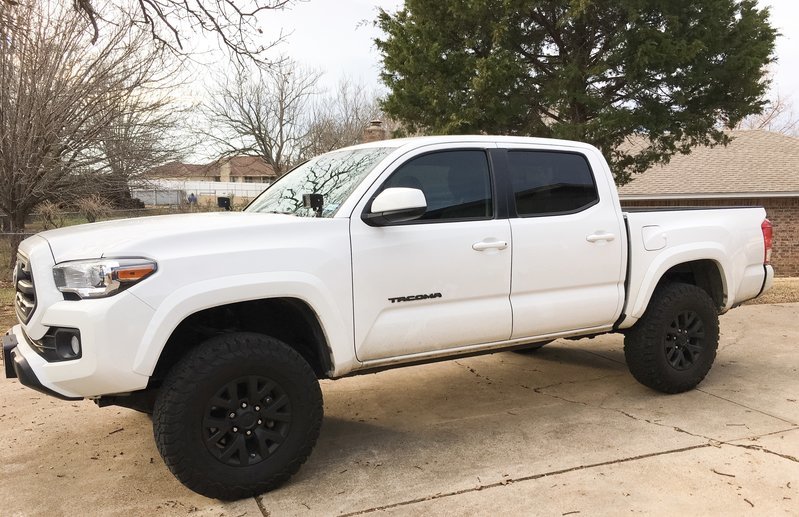

    26
    Alex
    2016 SR5
    This is my twin DFW truck lol
    I want to run bigger tires on the stock wheels. But I only leveled the front with Bilstein's. Do you have e any rubbing?

    No no rubbing at all. True lift is
    About 2.75 bilsteins all the way around
