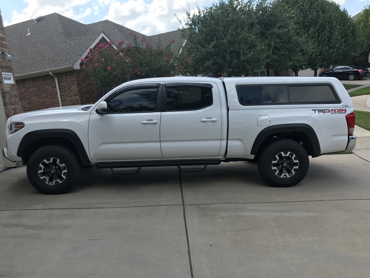

    Just ordered the OME Nitrochargers with 887 coils and Dakar leaf springs. Not going to be able to change the stock tires out immediately but not a big deal to me. Really do not want get new wheels but when I am able to get new tires, looking at 265 75r 16's. Anyone have pictures of a similar setup on their truck?

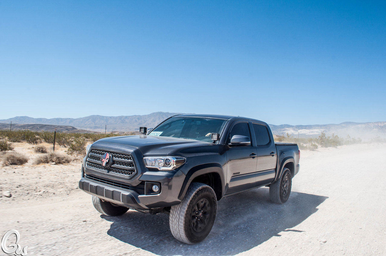

    HERS MY 16 TRD OR DCSB 4X2 WITH 2" FRONT LIFT NO REAR LIFT WITH FALKEN WILDPEAK AT3WS 265/75/16

    Did you get the AT3W P-rated or the LT load-E? I use my truck for daily driving/commuting 100miles a day and think the Load-E will ride too rough. Gonna buy the Falken, but I am interested in your opinion!

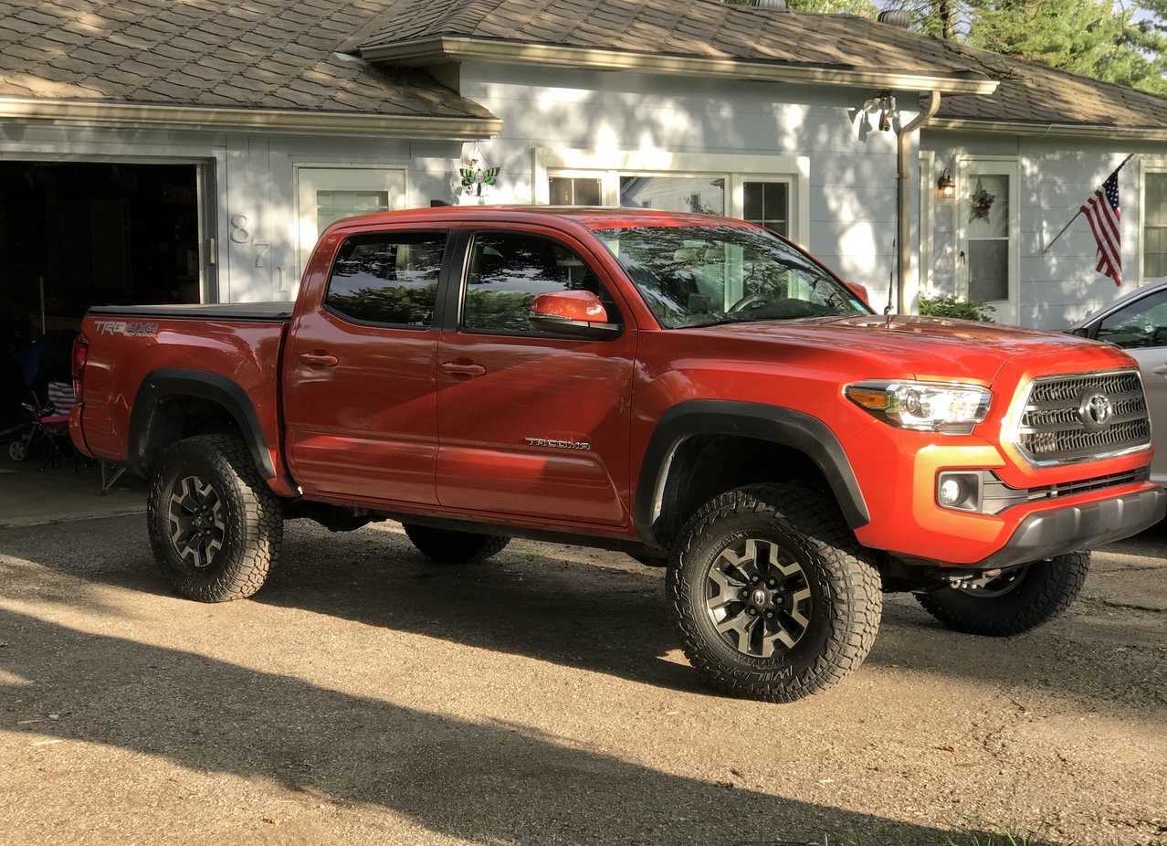

    16 trd or, 6112's in front, icon aal in rear, falken atw3 265/75r16 SL

    i have the LT and they ride good (i keep about 150lbs+ of tools in the back and run the tires at 34cold 37-38hot

    im gonna do 6112s up front and 5160s in back... how do you like the ride of the 6112s? softer harder?

    It's a little firmer than stock, but rides and handles great. Also hit some rough forest roads yesterday and was quite impressed by how well it took the bumps.

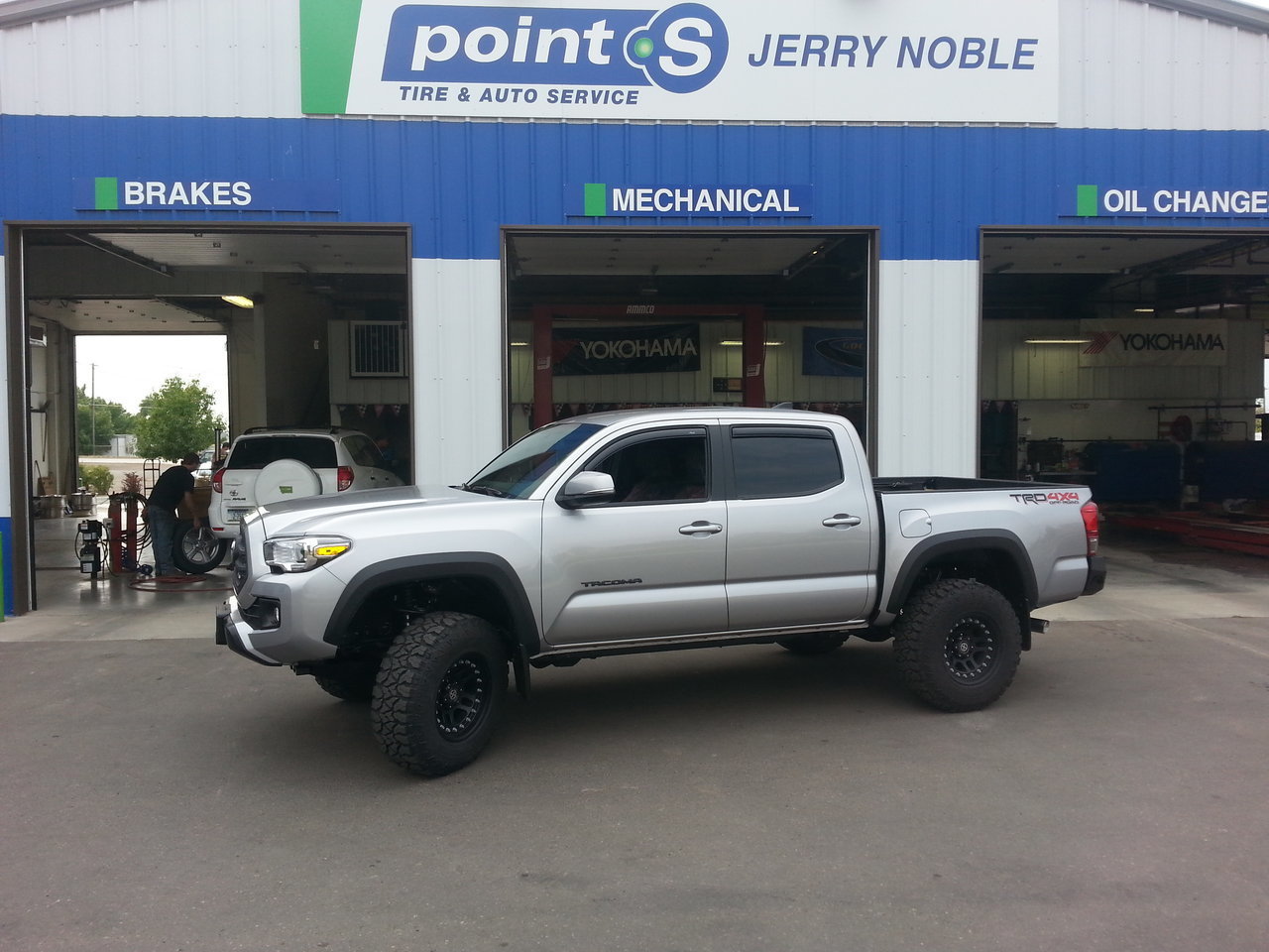

    2nd gen Bilsteins set at zero, OME 888's and HS 3 leaf progressive w/factory overload left in. Sitting on 265/75/16's with ATX AX195's -12 offset wheels.20170810_164323.jpg

    looks great, love the rubber. i'm thinking about those for this winter. how are they holding up? i've never run falkens

    What #notch did you have your 6112 set to?

    Have mine set on 5, and put a 1/4" spacer on drivers side for the lean. I already had the spacer on hand so decided to use it, otherwise would have gone 6 on drivers side and 5 passenger.

    GREAT SO FAR... 10K MILES ON THEM AND THEY LOOK GOOD
