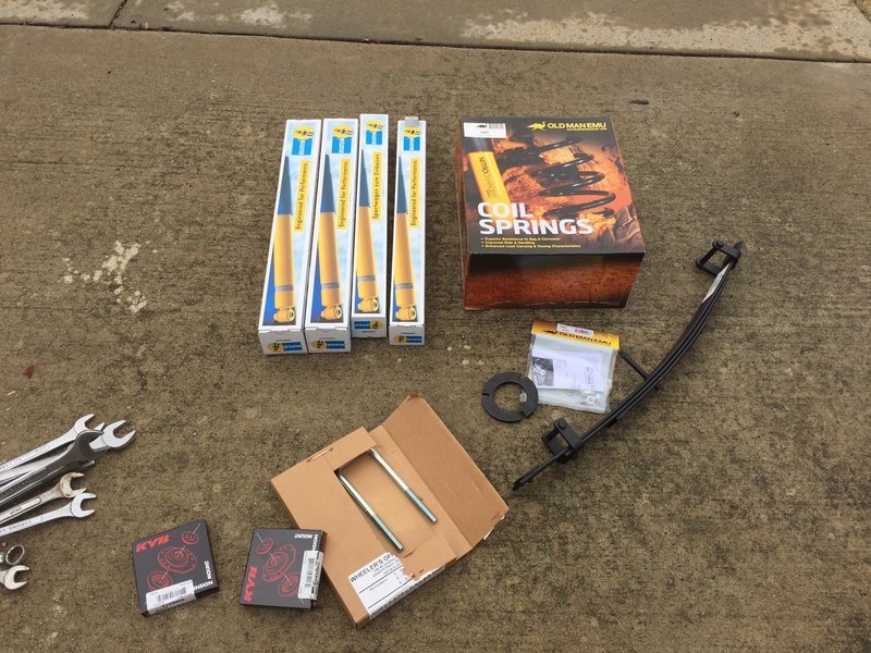

    Here's the lift components:
    - Bilstien 5100's all around. Set at 0" (lowest setting in the front)
    - Old Man Emu (OME) 2885 front coils. (no plan for a aftermarket bumper or winch).
    - Wheeler's multi-leaf add a leaf 1.5" set 3 leaf progressive
    (should help maintain a smooth ride in the rear, single add a leafs I was told tend to be more stiff and bouncy in the rear with no towing or additional weight)
    Additional components for purchased the lift:
    - New KYB front coil isolator's (KYB part number SM5413)
    - Old Man Emu FK29 Driveline carrier bearing drop kit
    - Wheeler's 1/4 Thick single strut top plate spacer (polyurethane, Driver's side only to prevent taco lean)

    Parts costs:
    Purchased from Wheeler's off-road
    - Bilstien 5100 front x2 175
    - Bilstien 5100 rear x2 160
    - OME 2885 coil's 167.20
    - Wheeler's multi-leaf add a leaf 1.5" 159.95
    (comes with new U bolts)
    - Old Man Emu FK29 Driveline carrier 12.35
    - 1/4 polyurethane top spacer x 1 7.50
    - KYB front coil insulators x 2 20
    - Shipping 60
    Total 762.23

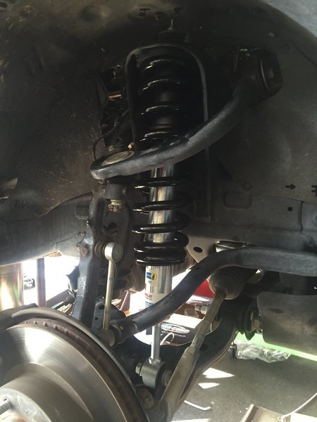

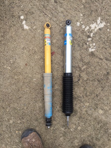

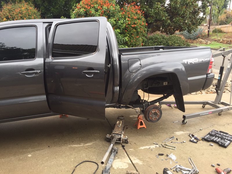

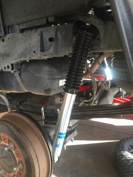

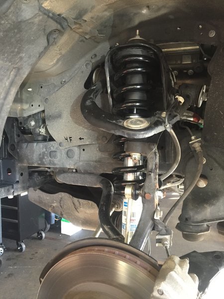

    UPDATE: Thank you all for the comments and advice!
    Yeah she has no clue. She's visiting her parents for Christmas and will be back Monday. I'm planning to just drive her by her own truck parked down the street and say "oh hey look its a tacoma like yours but lifted the way you want" And she'll say "Oh! please stop!" then after she oogl'es over it for a while, BAM the magic words "Merry Christmas Babe!"
    I had not heard of the sway bar spacer till just now (it was inevitable I would overlook something in the project) but that looks like a good idea. Are you saying it is really only necessary for lifts 3in or greater?? I took measurements of my fenders on the 4 sides before and will do it after I take it for a short drive to let everything settle tomorrow and before I get the new wheels to see how much lift this has achieved initially.

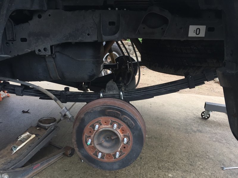

    Anyways, things went well today just a little slower than I had expected, Rain and some lack-of-the-right-tool issues caused a few road blocks.

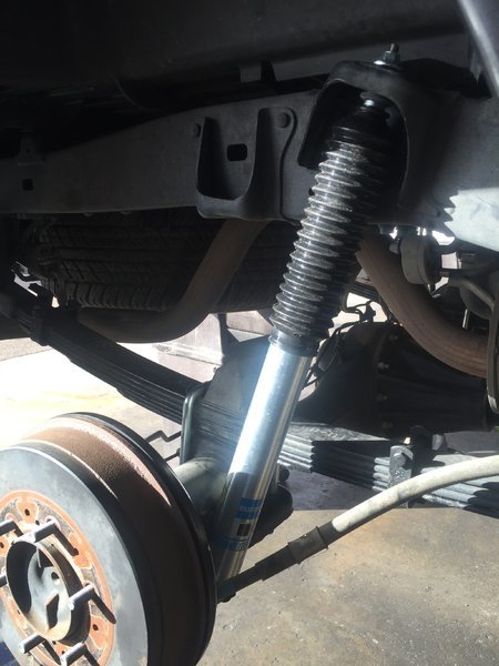

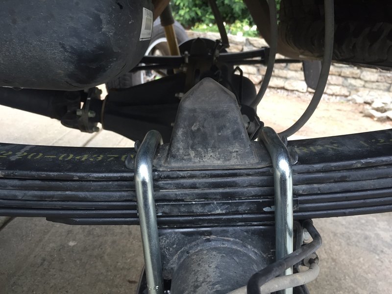

    For the new U-Bolts on the rear add a leaf pack you need a very deep well socket (which I had to go buy) in order to torque them down due to the excess bolt coming through. (The stock ones were also just a bit to short to reuse, so I was stuck in the middle). Also just a heads up some WD40 is majorly helpful in getting the bottom on the rear shock into the shock mount on the axel.

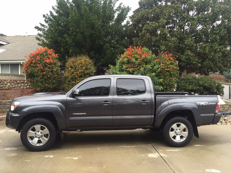

    Here's the before and the progress so far. The rear leafs went in without much of an issue, The new leaf pack looked like it was going to contact the stock spring retainer on rear portion of the leafs so I was planning on having to cut it off but it cleared by a 1/4in. I'm planning on finishing the front tomorrow morning before the tires and wheels get put on at 1pm. Will continue to update.... Should have close to a final product tomorrow.
    Cheers
    New Wheeler's add-a-leaf progressive 3pack installed. Almost is to long for the rear stock leaf retainer. The parking brake braket was attached on the old bottom leaf (now removed) but you can still see it hanging there (grey metal piece) on the brake line. I cut it off, the brake line looked solid and there was no way to reattach the bracket without undue tension on the line.
    Needed to go buy an extra deep socket to torque the U-bolts

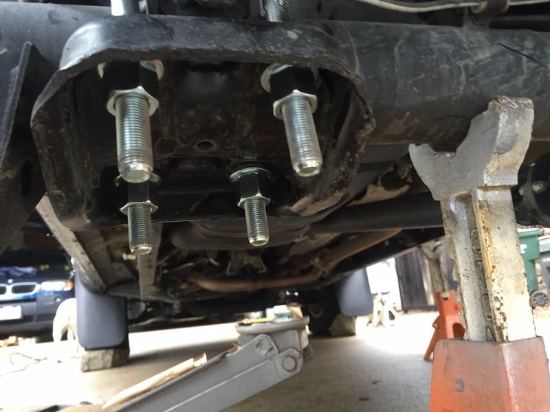

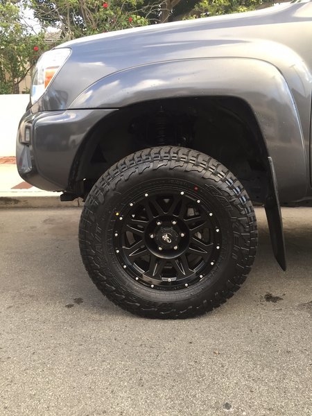

    Update: the front shock and coil install went flawlessly. The jack method on YouTube worked perfectly. Even though the truck is a 2015 I am glad I opted for new coil spring isolators. While the rubber on the old ones looked fine, the deep indent made it seem that the new coil would have to seat perfectly into the old impression marks or there would be gaps or it would not settle level. It makes sense to me that the new coils will settle better into fresh rubber. Could make no difference but for an extra 20 bucks it worth it. I also opted to add the OME drive line lowering kit. From eye balling the drive shaft before and after it definetly looks straighter with the lowering kit while before there was a slight angle at the joint. Again may not make a difference but it makes sense that the more you can keep things close to factory specs the less problems you will have down the line with vibrations and premature wear on parts. It drives like butter At 80mph even without an alignment yet. No noticeable vibrations, squeaks, or noises.
    Heres the pre lift measurements, measured from the ground straight up the center of the wheel to the bottom of the fender. Vehicle was on level ground
    Driver front 34 3/8
    Passenger front 34 7/8
    Passenger rear 35 3/4
    Driver rear 36 1/8
    Post lift before driving or moving the truck.
    Driver front 38 3/8
    Passenger front 38 3/4
    Passenger rear 37 1/2
    Driver rear 37 3/4
    Post lift after driving 50 miles
    Driver front 37
    Passenger front 37 3/4
    Passenger rear 37 5/8
    Driver rear 37 7/8
    Drivers front with 1/4 polyurethane spacer.
    Passenger front
    Passenger rear
    Driver rear
    At the tire shop installing the wheels and tires

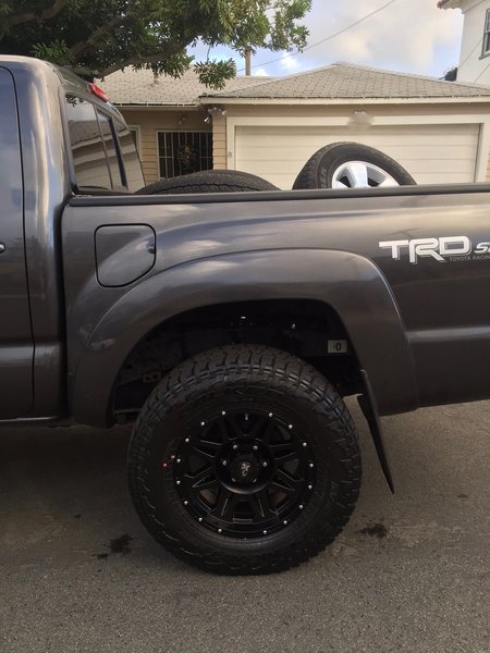

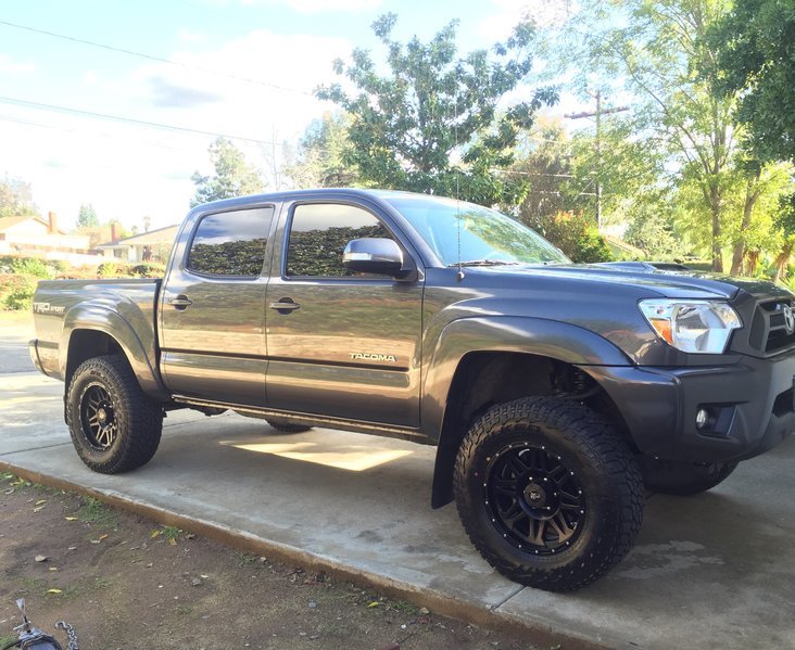

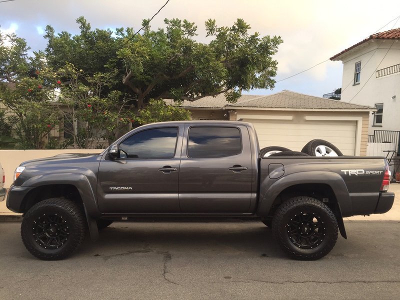

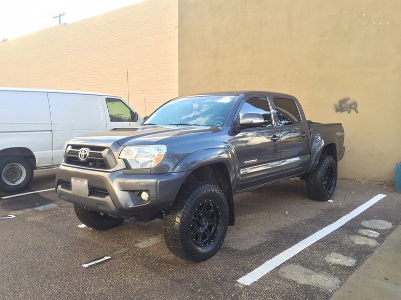

    Here's the end result, it's raining so I'll have to take better photos but all in all I think it turned out great.
    Everything went into spec with the alignment I was told. Had minor rubbing at full lock on the small front mud flaps so the shop took those off and now no rubbing. I may try to trim them and put them back on.
    Thank you again to everyone who contributes to this forum!
    Merry Christmas
    TOTAL SPENT: 1934.07
    I forgot the new lug nuts (duh....) 50.25 at 4 wheel parts
    Pro Comp 24 - piece 12x1.5 Chrome Lug Nut Kit with extended shank
    Blew the budget by 34.07 but I guess you can't win them all.
    Merry Christmas everyone!

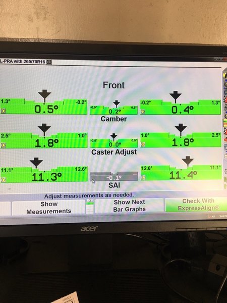

    Alignment after the lift, wheels, tires. With stock Upper control arms (UCA).
    Before
    After

    Anyone know what the ideal camber caster ranges should be post lift? I was told it was in spec, but then I've read that the caster should be somewhere around 2.3 or so?? Anyone have experience with this?

    I have the same lift as you on a 2014 trd sport 4×4. I went with jba uca's and they got my alignment back in spec with 285/75/16 tires.

    Sweet thanks, I'll take a look at the jba UCA's. Do you know what your caster is set at now?

    Sweet, thanks man! 2.3 is what I've been reading is the right setting. Any insight into why the 1.8 would be considered "in spec" at the alignment shop?
