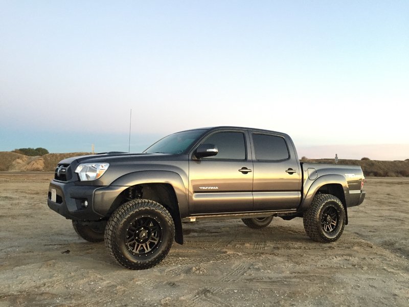

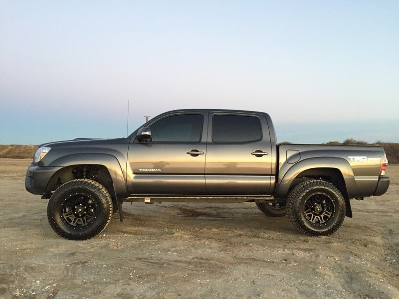

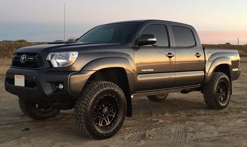

    Finally took some better pictures today... Here is the final product.

    Looks great!!! This is pretty much the exact setup I've got coming next month.

    So what does she think about it??

    She loves it! She didn't believe me for a solid 5min after I told her it was her truck she was looking at.

    I also went with the same combination you have but I am a 4x4 and got about 2.1 in front(give or take). I went with 285/70/17 cooper tires though

    That looks awesome! Did you have to do additional trimming for those tires?

    Looking good. 4" of lift on 885 seems to be extreme. Can you take a picture of the bottom of the coils? I'd like to see how it's seated.

    I was surprised also, a half inch of that is from the new tire size. But I will take some photos of the bottom of the coils.

    minor trimming at the back of the fenders, cant even notice.

    I agree, we need to see how the coil is seated. 885 coils should onlly give about 2.5inch max on a 2wd. Unless you moved your setting on the 5100s at .85 or 1.75 which will preload the shit out of the coil

    I'll take pics of the bottom of the front coils tomorrow, but I can confirm already the 5100's are set at "0" and the ends of the coils are seated properly against the bottom bracket and not rotated.
