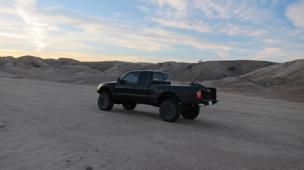

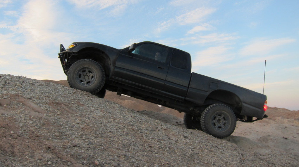

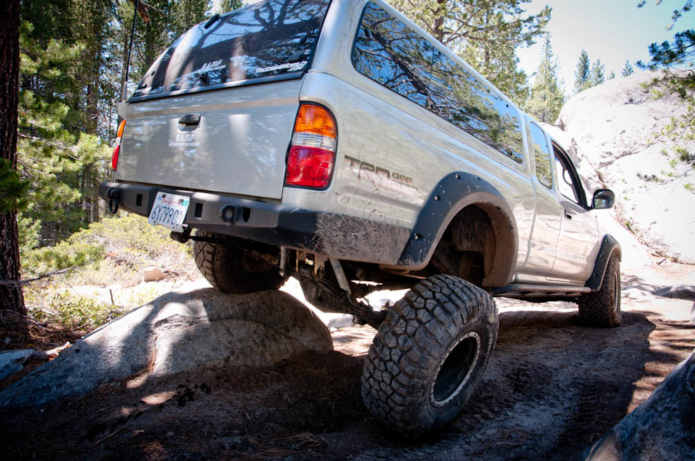

    I'll play :D
    Model Year: 2002
    4x4 OR 2wd: 4x4
    LIft Intalled: FOX extended travel coil overs and ALL pro expos in the rear
    Wheels Installed: 15"x10" BS 3.75" Offset -44mm
    Wheel spacers?: nope
    Tires Installed: Three 33x12.50 Duratracks and a BFG MT
    Plastic Triming need: All of it and about 5lbs of sheet metal and I still rub like hell :eek:
    Body Mount Trimming or Rubing: Nope got a 1st gen :p
    Picture If You Have One: Just a few

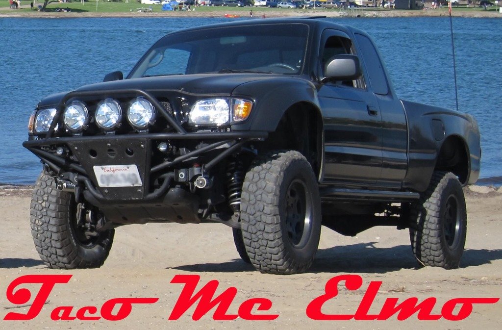

    Model Year:2002
    4x4 OR 2wd:4x4
    LIft Intalled:2.5 inch lift in front 1.5 in back Fox shocks with RR
    Wheels Installed:Amercian racing chamber teflons 16x8 4.5 BS
    Wheel spacers?:n/a
    Tires Installed:BFG Mud Terrain 265/75/16 32 inch
    Plastic Triming need:LOL Running Fiberglasss with 3 inch rise
    Body Mount Trimming or Rubing:Trimmed cab mount pinch weld
