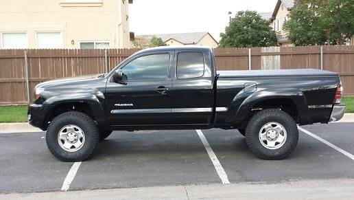

    2009
    2WD Prerunner
    6 Lug
    Icon Stage 3 Ext Travel
    Stock Steel Wheels
    285 75 R16 Toyo ATII's
    Icon Tubular UCAs
    No Trimming
    No Rubbing

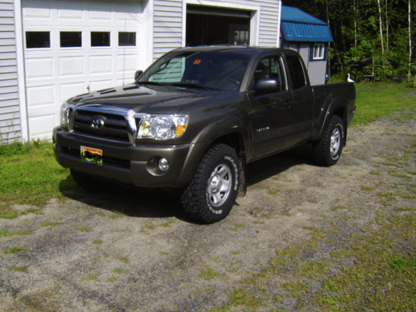

    Here's a picture of my wheels being lifted by my tires. :D :stirthepot:
    265/75R16 Duratrac LRC's on factory steelies and suspension.
    Some rubbing from the side lugs on the UCA when I stuff a front wheel in a tight corner.

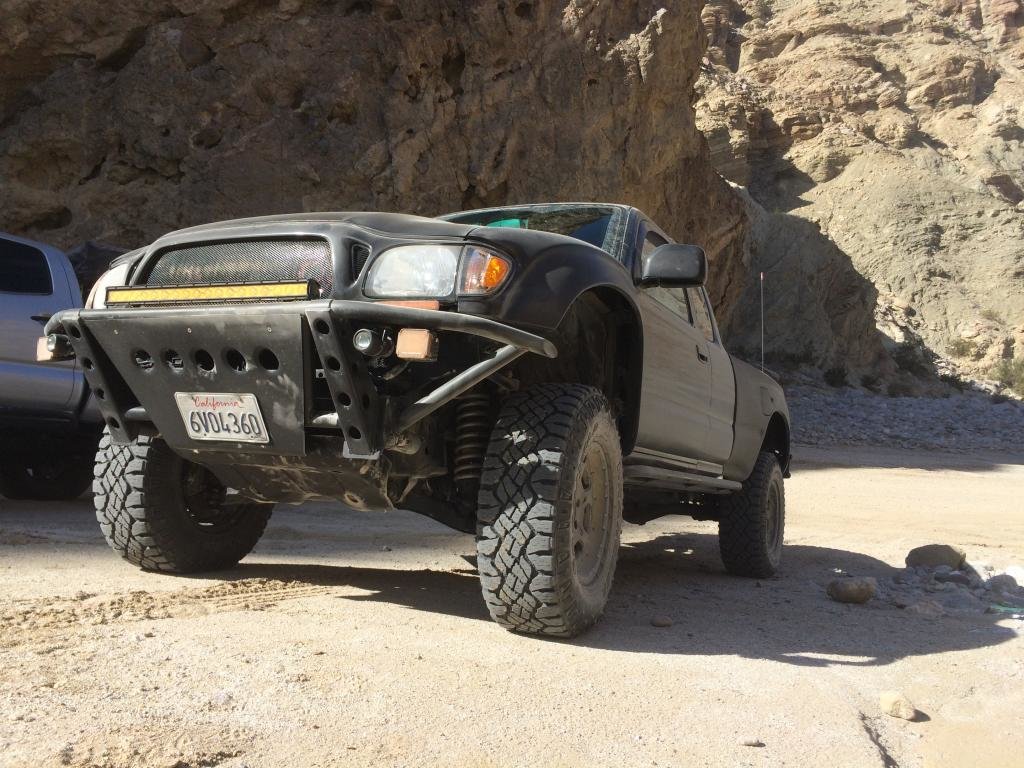

    Updates:
    265/75/16 Goodyear Wrangler Duratracs Load range C with 15k miles mounted on 16x8 American Racing Chamber Teflon wheels with longer lug nuts in black from wheelers offroad.

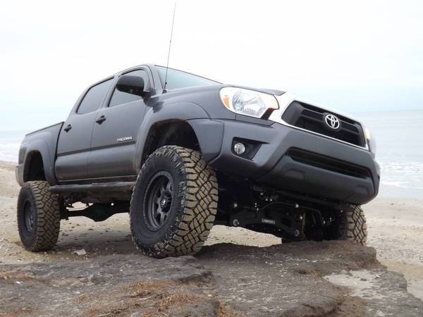

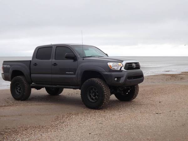

    6" BDS DB, 37", Dirt King, Total chaos UCA's w/ Heims, Fox c/o's, 4-banger fenders, 37" Nittos, 4.88 w/ rear ARB, AP Expos, 17x9 Method beadlocks, cab mount relocation, "Insain fab" tub, 5% tint, 10" Rockford Fosgates, Magnaflow 18" custom catback exhaust, AFE intake, Trail Gear bumper, Crown brake lines F/R
    Model Year: 2011
    4x4 OR 2wd: 4x4
    5 or 6 lug: 6
    Lift Installed Ex: DB or long travel, spindle, brands, lengths, etc: 6" BDS W/ fox #650 spring rate
    Wheels Installed: 17x10
    Wheel backspacing: 4.5
    Wheel offset: -24
    Wheel spacers?: front only (1.5") to clear tie rods
    Wheel TPS?: yes
    Tires Installed: 37x12.5 MTR
    UCA: total chaos w/ heim joints
    LCA: stock
    Front Bumper: trail gear
    Plastic trimming needed: yes
    Body Mount Trimming or Rubbing: cmc/pinch weld/hammer
    Additional: front fenders cut 2.25 rears 2"

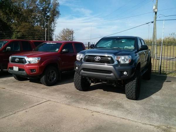

    I had forgot about this thread.
    I've had my lift for a little while now, three months or so. See what you think....
    Model Year: 2014
    4x4 OR 2wd: 4x4
    5 or 6 lug: 6 lug
    Lift Installed Ex: 6 in DB Fabtech w/Dirtlogic shocks
    Wheels Installed: 17 in Fuel Trophy's
    Wheel offset: -12
    Wheel spacers?: Hell No!
    Wheel TPS?: Yes
    Tires Installed: 315/70/17 Goodyear Duratracs
    UCA: Stock
    LCA: Stock
    Front Bumper: Stock (for now)
    Plastic trimming needed: 3-4 inches of inner plastic fender well
    Body Mount Trimming or Rubbing: None Fabtech limits steering to alevate
    rubbing issues or bump steer.
    Picture If You Have One:
    Next to a stock 2014 TRD OR
