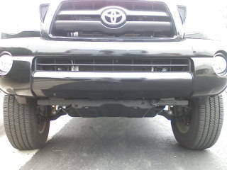

    got it lifted yesterday... im very happy with the ride. sorry for the crappy pic i just took it with my phone.[/url][/IMG]

    Looks good but now your gunna need some bigger tires!

    I USED THE TOYOTA TSB IN THE REAR AND A TOYTEC 3" SPACER IN THE FRONT... BRAAAP= RIDING IN GENERAL, I HAVE A 250SXF AND 200 XC-W SO I GET THE BEST OF BOTH WORLDS HAHA. OH AND YES IM LOOKING AT GETTING BFG A/T 285-70-17'S BUT IM BROKE NOW SO ITLL HAVE TO WAIT

    thats the same set up i was looking at getting, let me know when you get the larger tires because im not so sure they will fit the rear

    i was under the impression from othe members the issue was with the front and a three inch lift would take care of it. the 285/70-17 are 33" tall and the lift claimed it cleared 33's. im sure some one has a set up close to ours maybe they can help.

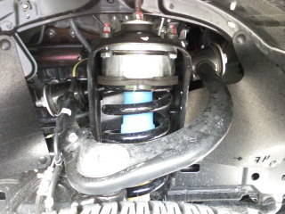

    I think the issue is that 285s won't fit on stock rims--also some minor trimming will be required with new rims and 285s. I can't remember if the A-arm is a problem or not. Spacers would solve that anyway--there's a thread round here about this someplace that I read a few days back.

    Guess you wouldn't be having any trouble with the A-arm--my bad. Nice set up!

    but those tires still wont fit on stock rims????

    Nope, stockies are only 7.5" or 7" I forget which, but either way....

    what is the largest i can get??

    So far as I know 265/70/17. 32s or so. Sucks I know--I want bigger too, but have no problem with the look of the wheel, so I'd be spending alot of money on wheels so I can spend more on another inch or so of tire....
    I have heard of one person who put 285's on stock wheels, but I don't know that I'd try it myself since all the other folks here have said no way.
