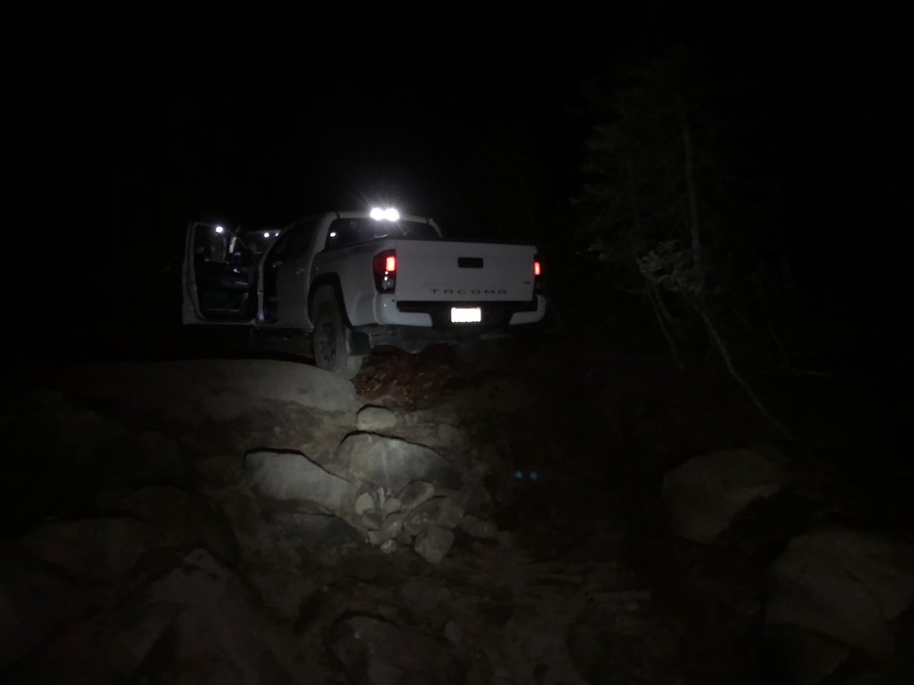

    That's 2 votes for using the spring to lift and not the shock. That's probably what I'll do then. As far as rubbing goes, I'm fully prepared to cut whatever I have to, to prevent rubbing. I'm ordering a pelfrey bilt bumper. That should alleviate any rubbing forward of the tire. As far as the upper control arms, any advice on what I should get. Are the stock rims crap? Should I trash them and get a rim that won't require me to have to add a wheel spacer. Should I be piecing all this stuff together or is there a kit out there? It seems what I'm trying to achieve would be pretty common. Minimal lift to fit larger tires while maintaining good on and offroad performance.
    I mainly drive on roads if roads look like this. ;)
