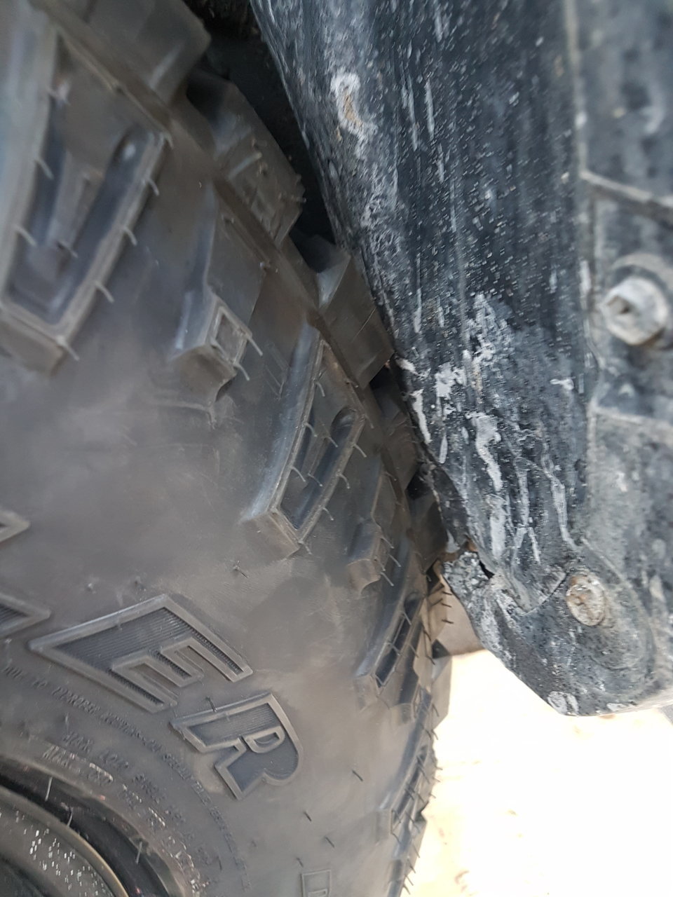

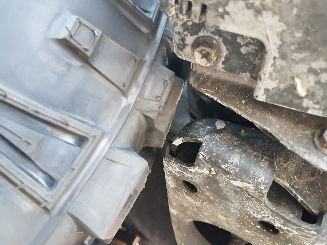

    So just throwing it out there I have a 2.5 lift in the front on Fox.
    I can't even turn.
    This might be from the extended length bringing the wheel out a bit more though.

    ...I never said do spacers. Spacers will make it harder lol
    My stance is wider and makes it a bitch to fit cause I'm hitting pinch weld
