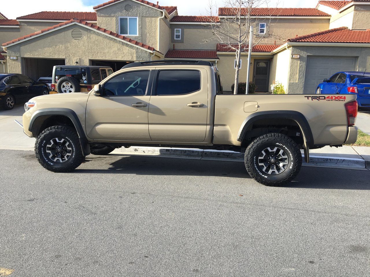

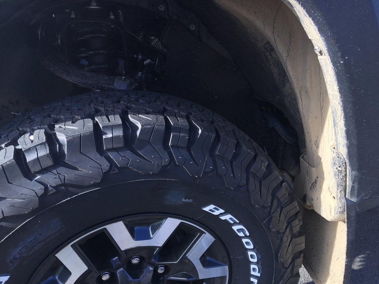

    Have not done that trail, but agree 33s run and look better in 285.
    I have 285/75R16 on a 1.75” lift with no rubbing. I did my homework/math though and picked the right wheel (4.5”backspacing) that hardly rubs anything and then did a minor cab mount chop.
    Did a flex test (using forklift =]) on full turn and no issues

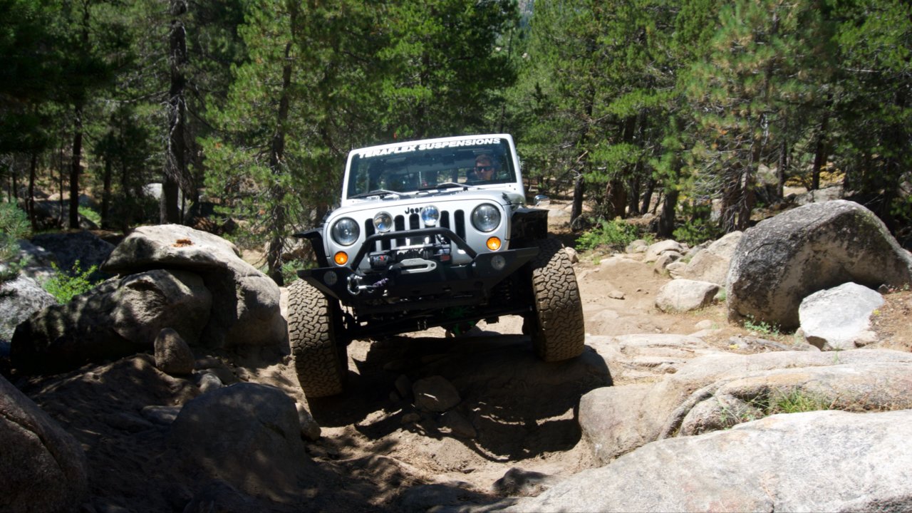

    Yeah it’s a really fun trail! I ran it south to north though. Good job getting through with a basically stock truck. That trail has some tricky spots/ rocks. I personally thought it was harder (more fun as well) than slickrock.
    Good luck with the bigger tires. Not sure what size I’ll go with for my tacoma. Really love my 35’s now..here’s that same obstacle.

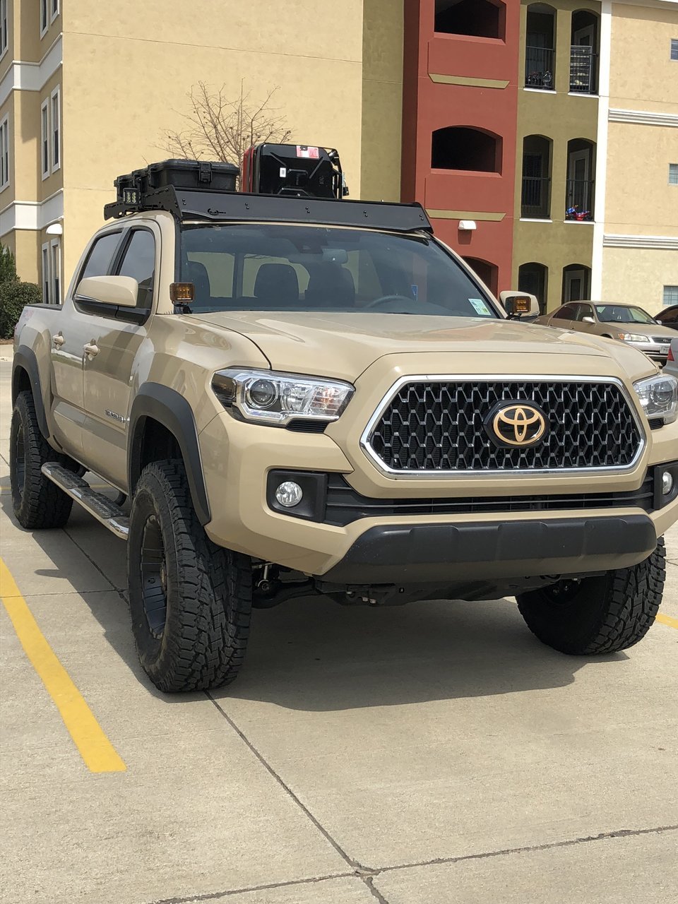

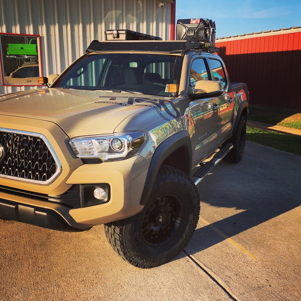

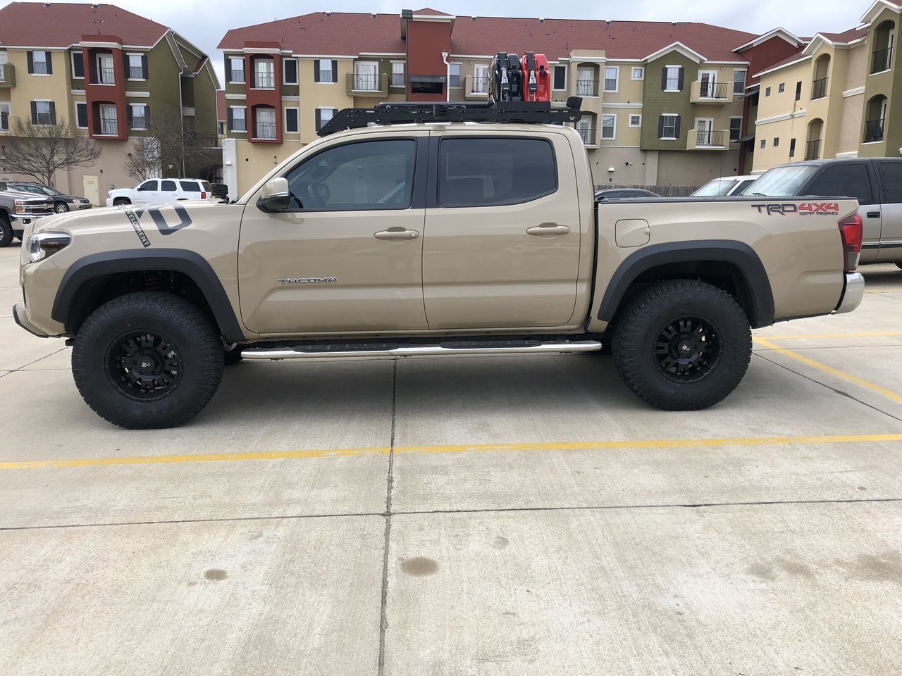

    I just did this to my truck.

    I'm guessing LR stands for light racing. Are those by SPC?

    Total chaos > spc

    I just went with pro comp 5001 series 16x8 4.5 backspacing.
