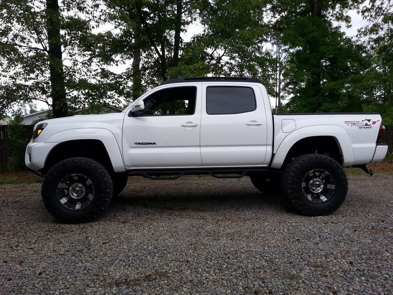

    Hey, I was gonna try and lift my 2012 prerunner and put some bigger tires on it. I'm sorta new to the whole truck scene and was wondering if anyone could tell me everything I'd need to buy to do such a thing. I also wanna try and make it look sorta like the picture I attached.

    Pre Runners are a piece of cake buddy don't stress it. Skip all of the spacers etc and get the Mactrac spindles for 4" of lift in the front and then you only need 2" of lift in the back to level the truck. There are a million options for lifting the rear but ultimately a new leaf pack is the best answer. As you go about this remember that the truck has a 2" + rake lower in the front so you half whatever you do in the front to have the back sit level...hope that makes sense ?

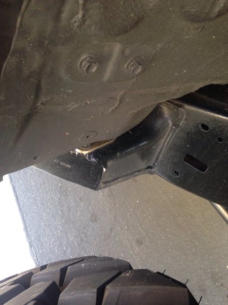

    " cab mount chop " the cab mount is one of the biggest problems in the front wheel wells of Tacos, 4Runners and FJ's...cause' they all the same truck from the doors forward. Here is what my CMC looks like :

    Nah any decent shop can do it very quickly, the cab mount is just cut off and then capped
