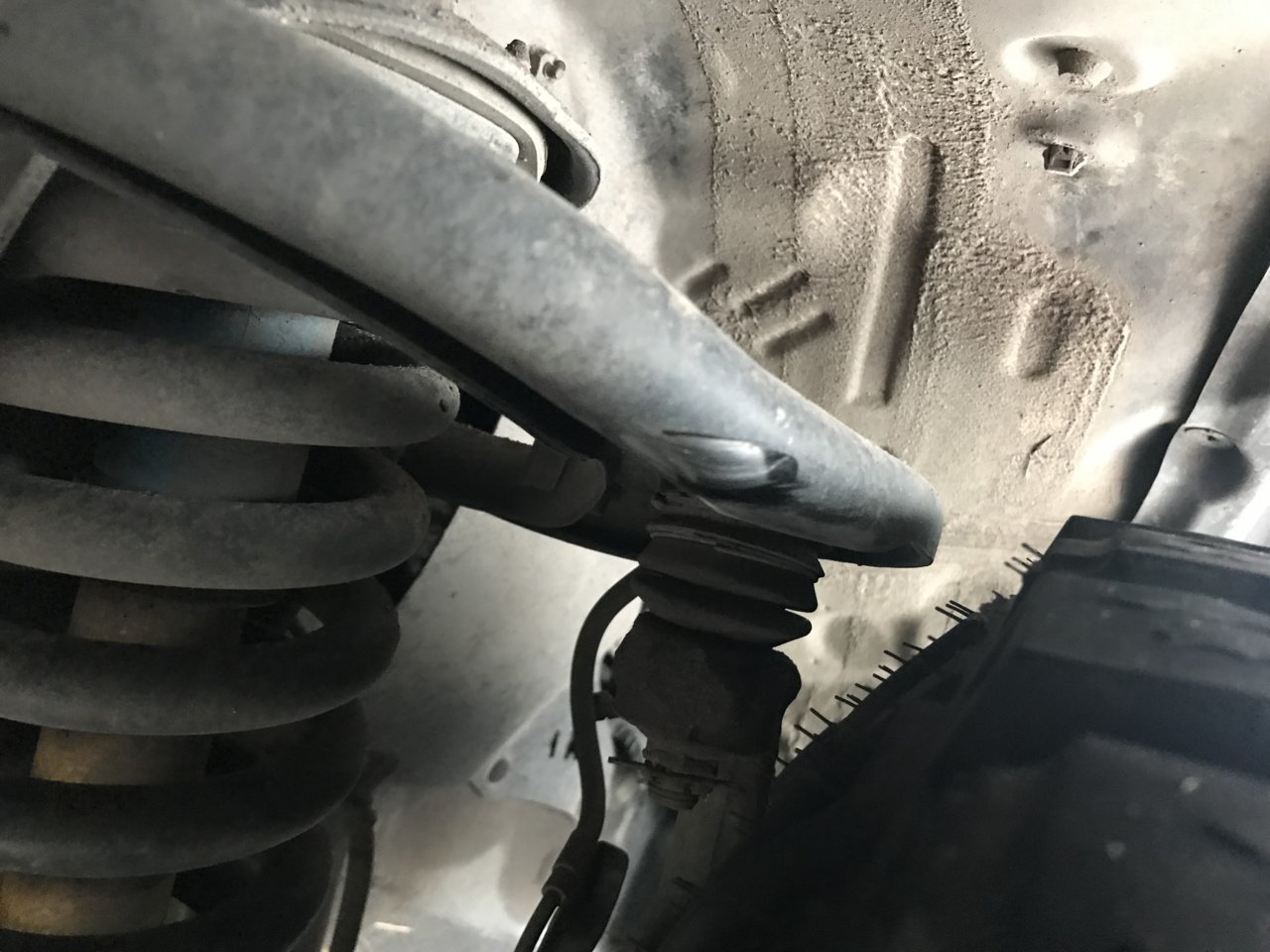

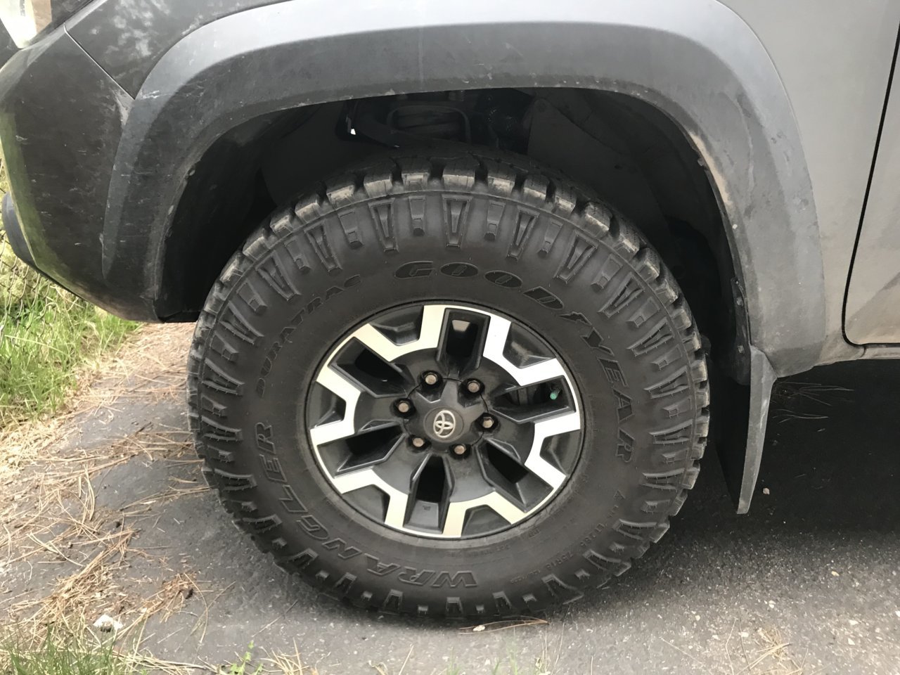

    The tires are 285/75/16 Goodyear Wranglers. The rub is on the stock UCAs with very minimal on the plastic. Here are some pics:
    Thanks

    Your best bet for what you are doing is swap to a 255/85 which is a skinny tire that will accomplish everything you need without lifting, spacers, cutting etc

    No offense so please don't take this in a bad way. You still have the mud flaps on your truck... you aren't doing much off the beaten path. Why not leave the truck alone and get your money back on those tires since the tire shop made the mistake?

    No offense taken and it’s good question. I considered that. I’m planning on getting out into the backcountry a lot deeper this hunting season. I’ve gotten into a few areas recently where my clearance became an issue.
