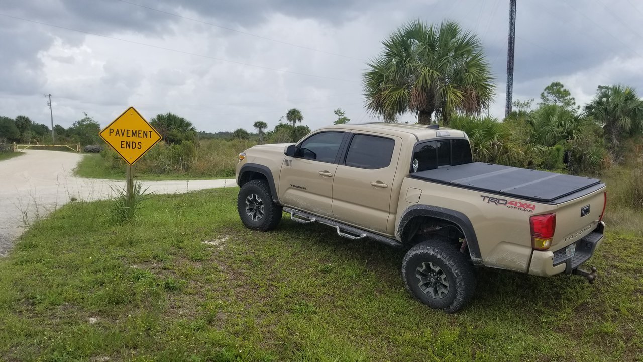

    Toytec boss 2.5 with stock UCAs drives perfect and no issues with alignment.20170603_122954.jpg
