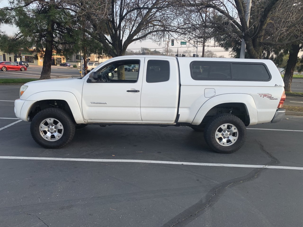

    292CFC11-3412-4FD6-AD54-14D60B027D6B.jpg Just had an icon stage 1 kit installed. 2.0 coil overs, new icon uca delta tubular, 2.0 rear shocks, 3 leaf spring packs.
