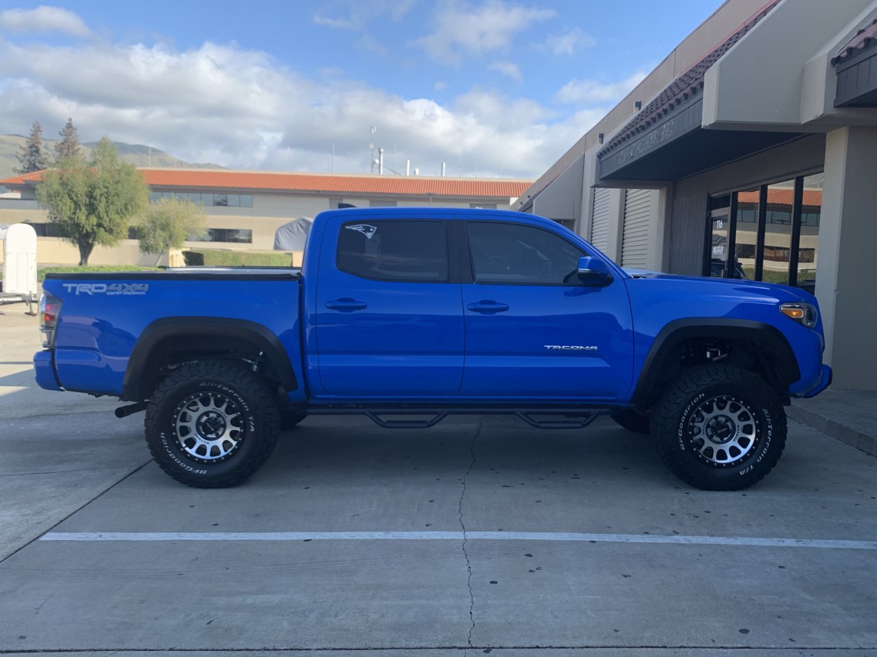

    Well I basically did everything backwards. I bought wheels before tires, and tires before suspension. Going to 33's, on 17's, and looking to add a nice suspension lift that will perform well off road with a rig penciled out to be near GVWR with two people.
    Committed to a 2"-2.5" lift and replacing UCAs, front shock/coil, rear shock, and doing something with the leaf pack. Any suggestions on WHAT to get, and tell me more about WHY you chose your setup.
    Here's a picture of the before:
