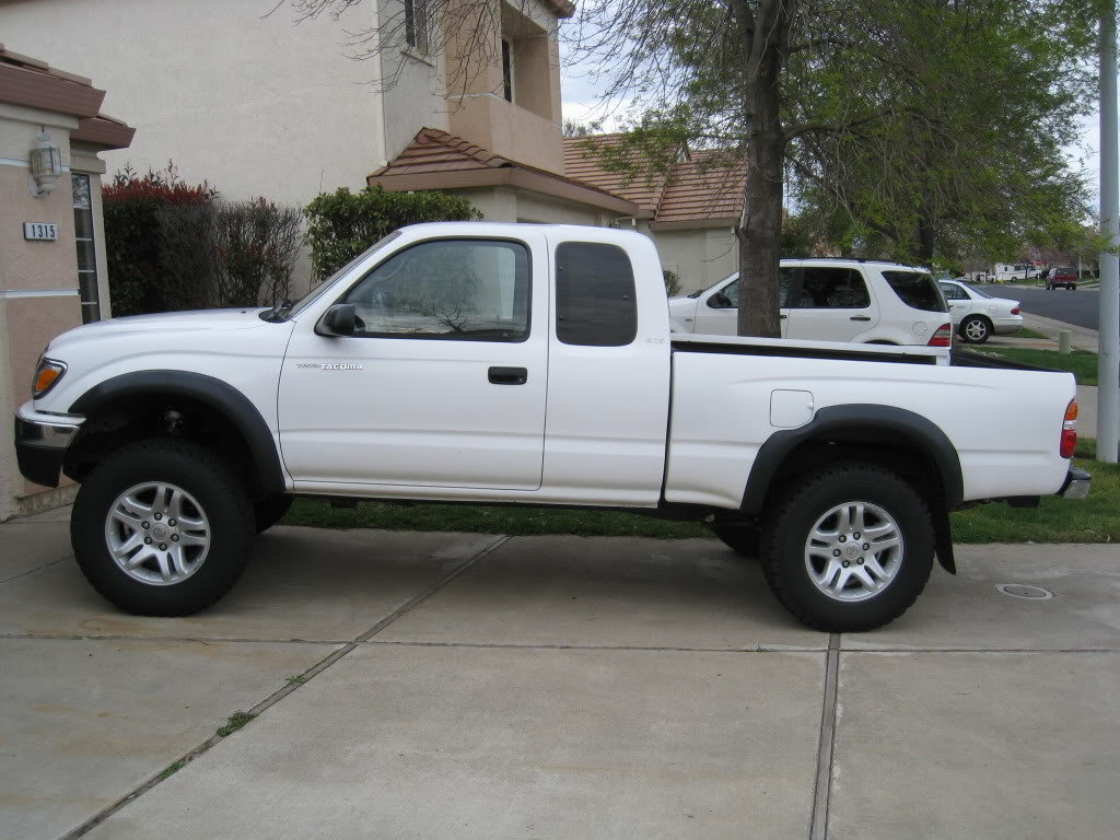

    Installed the lift yeserday. Everything was very easy to install. Only problem I had was removing the rear leafs. The front bolt on the hangers was so rusted that I ended up having to cut them and go buy some new bolts.

    Well, my front springs and shocks were shot and needed to be replaced. My rear leafs were bending backwards and both shocks blown. I guess I could have gone all new OEM shocks and springs and then got a spacer/block lift. Maybe that would have been a better idea? I though I was only going to do 2" up front but ended a few threads shy of 3".

  15. Mar 6, 2010 at 6:30 PM

    Looks Good! :thumbsup:
