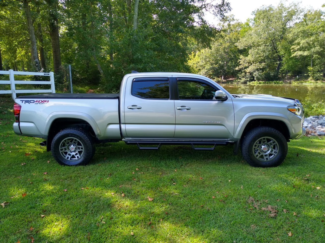

    Hypertech has a fix for that so that's not an issue for me. But I think the computer is off on mpg and distance to empty. My speedometer is dead accurate with the 265/70s. IMG_20200410_164208888.jpg

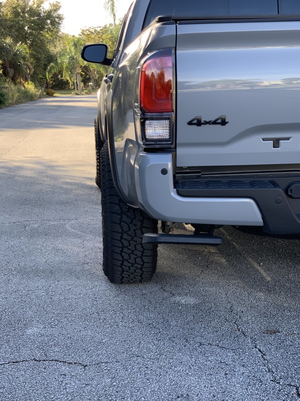

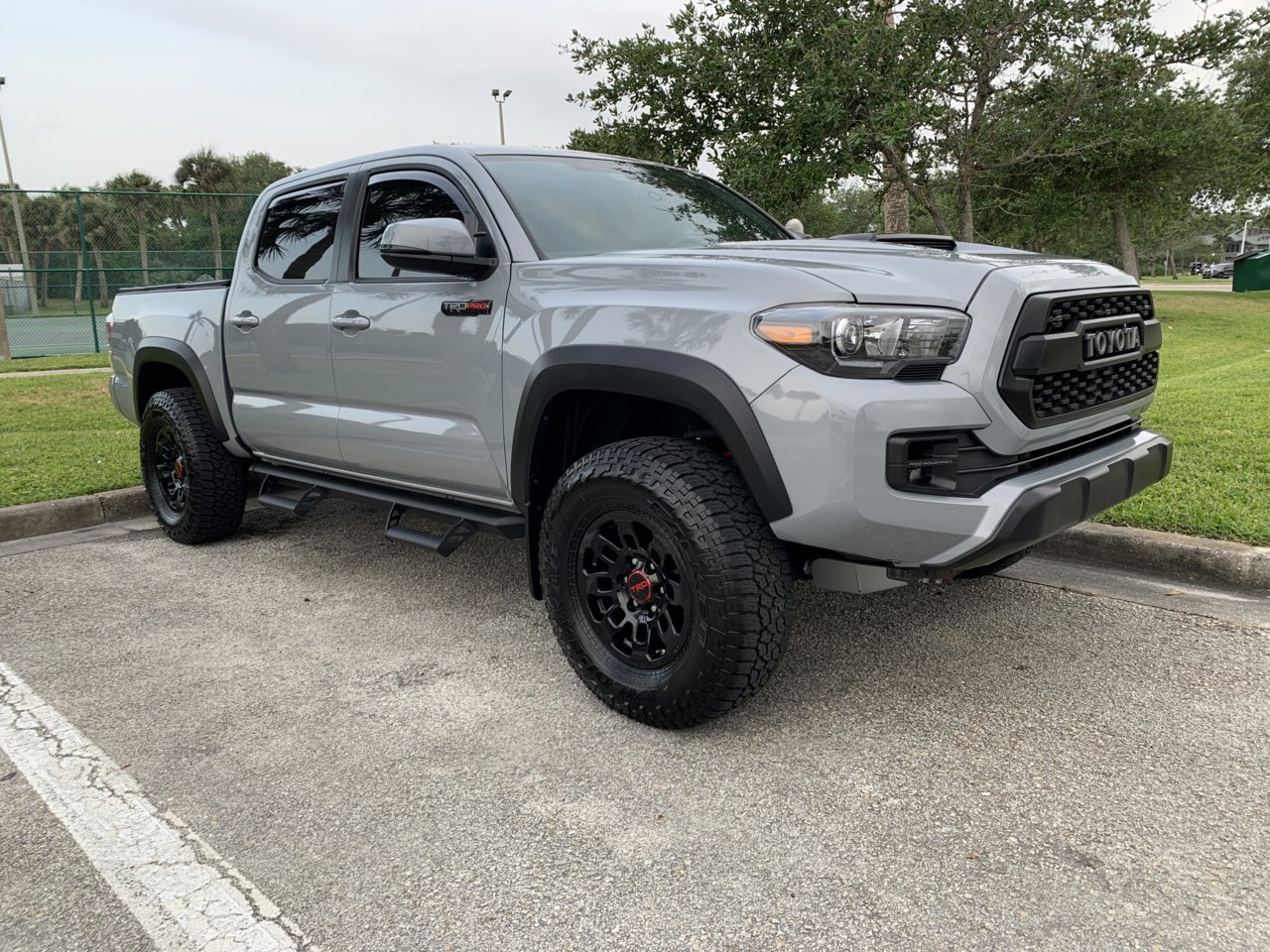

    Proudad103, I have the Rough Country 1.5” wheel spacers installed. No issues with the spacers, just had to trim a little on the front inner liner/bumper, .5”clearance issue resolved.

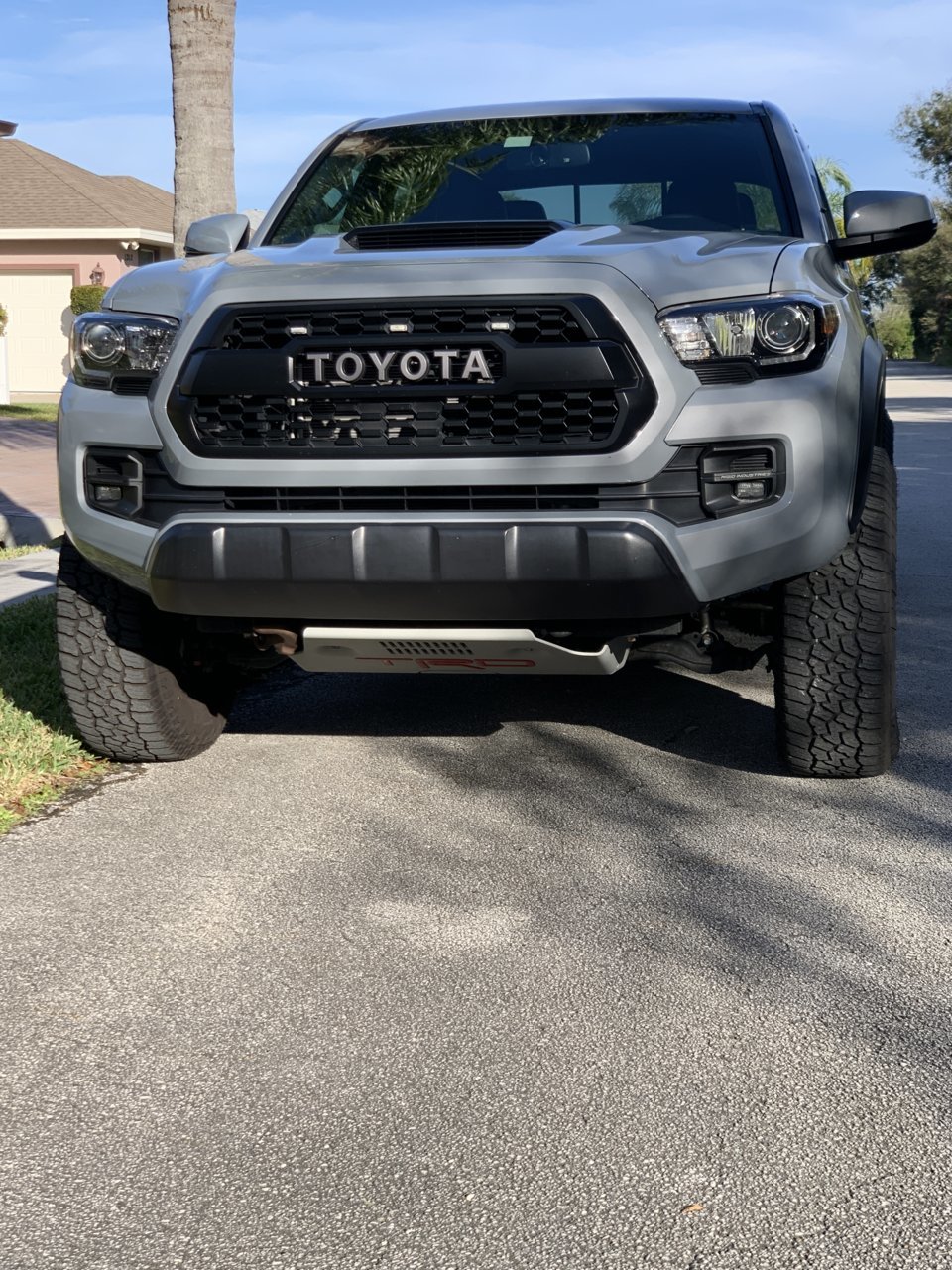

  13. Apr 21, 2020 at 5:45 PM
    #33
    Proudad103
    Proudad103 Active Member
    Dec 29, 2018
    #277372
    42
    Steven
    Boyertown, PA
    2019 Super White TRD PRO
    I like that look. Are the tire 265/75? Had the falkens on my old dakota and loved em. Amazing in the snow.
  14. Apr 21, 2020 at 5:50 PM
    #34
    itsmermf
    itsmermf Well-Known Member
    Aug 22, 2016
    #195257
    230
    Robert
    Merritt Island, FL
    2017 Tacoma TRD PRO
    Interior LEDs, all weather mats, TRD performance CAI, trifold hard tonneau cover, predator pro step, accessory interior/exterior illumination package. Kicker tweeters, Kicker speakers.
    Yes, 265/75/16, I wasn’t sure at first, but I like the stance with a little poke...actually, it handles slightly better also.
    VaToy and Proudad103[QUOTED] like this.

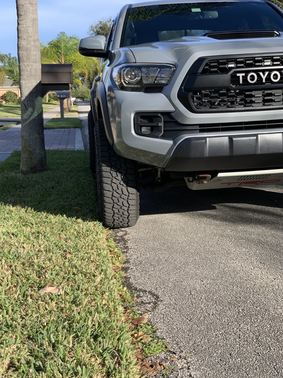

  15. Apr 21, 2020 at 5:58 PM
    #35
    Proudad103
    Dec 29, 2018
    #277372
    42
    Steven
    Boyertown, PA
    No lift i assume? Do you have a side pic of them? I was also considering the falkens but kinda leaned towards the dura tracs. I'm just curious how they look on the truck.
  16. Apr 21, 2020 at 6:06 PM
    #36
    itsmermf
    Aug 22, 2016
    #195257
    230
    Robert
    Merritt Island, FL
    2017 Tacoma TRD PRO
    No lift, although I did consider the Revtek 427AP, only because of the rubbing, then I started to mess with the front inner liner /bumper and was able to trim off/push back the liner to clear, so I’m passing on the lift, but it probably would look fine too. I love the Falkens, especially the aggressive side profile. I heard Duratracs were noisy anyways.

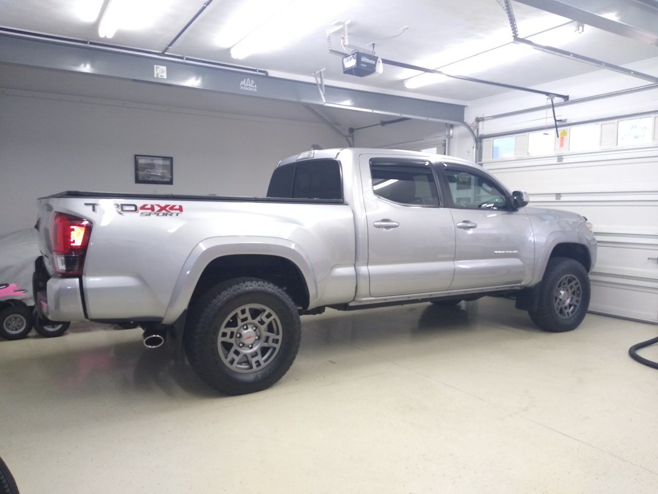

  18. Apr 21, 2020 at 8:52 PM
    #38
    VaToy
    VaToy Life Long Member
    Mar 26, 2018
    #248467
    4,445
    Parts Unknown
    2018 TRD DCLB Sport 4x4 Silver Sky
    Bilsteins 5100s on the top setting, 4runner Gray TRD Pro Sema wheels, 285/70/17 Toyo AT3s, Sumo Bump stops, TRD exhaust, ECGS Clamshell bushing, 1/4 shim for the lean and one inch rear block, OEM Pro grill and garnish OEM TRD Skid plate, TRD CAI, Demon Brackets, Rigid Industries Pro fog lights, OEM Trail Rails sidebars, Diode Dynamics LED SL1 high and low beam lights, OEM Roof racks, Clazzio leather heated seats, Remote Start, TRD Pro shift knob, tinted windows, Rockford Fosgate 4 channel amp for the headunit and sub and amp combo, OEM Puddle lights, OEM tailgate lock, OEM bed mat, LED interior lights, OEM blackout kit for letters, JLT catch can, upgraded 27F toyota True Start battery, Vleds led tail light kit with Pro tail lights, OEM Rave4 side mirrors with convex spotters,just to name a few mods.

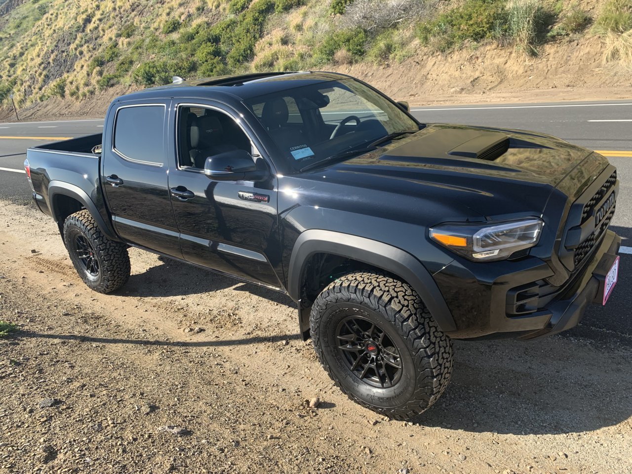

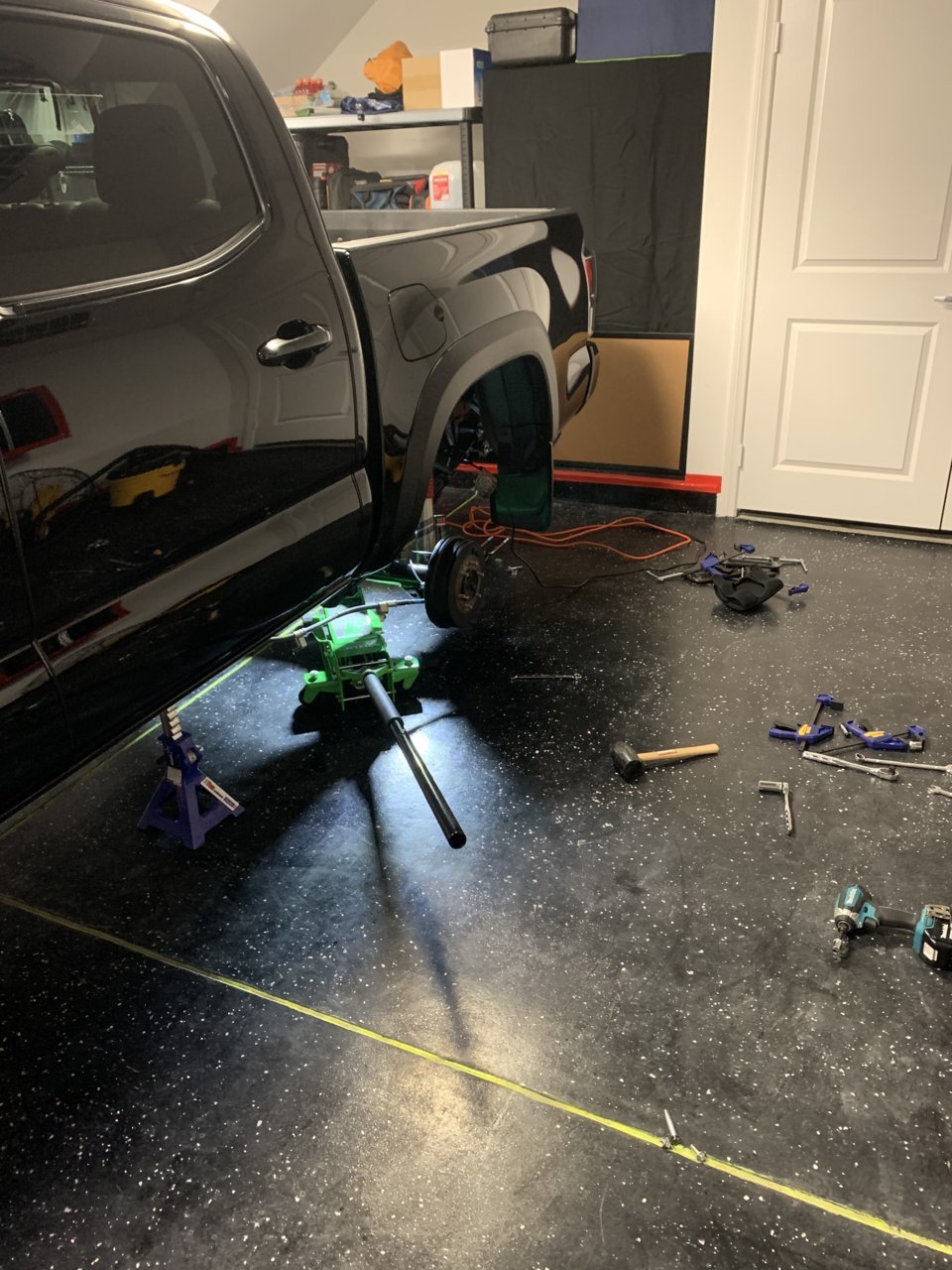

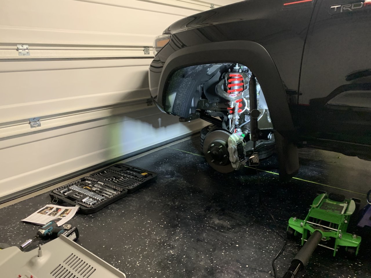

    I recently got the new 2020 TRD PRO about 3 weeks ago, my first mod was adding the 1/2 shims in the front and AAL in the rear. Which have the truck probably a total of 3”s in both ends. I did the whole thing in 9 hrs. Took me awhile to figure out but after i got one side done the opposite side was so much easier. After the lift i went to my local tire shop and had them set me up with 285/75/16 BFG KO2’s. And alignment. Truck runs great. No rubbing on full turn. It was good to go! I think the 2017 and 2020 run the same suspension so you should be good also if you go the same route. I uploaded the parts, some pics of the truck and the picture of the shim above the front shocks. Hope this help!
