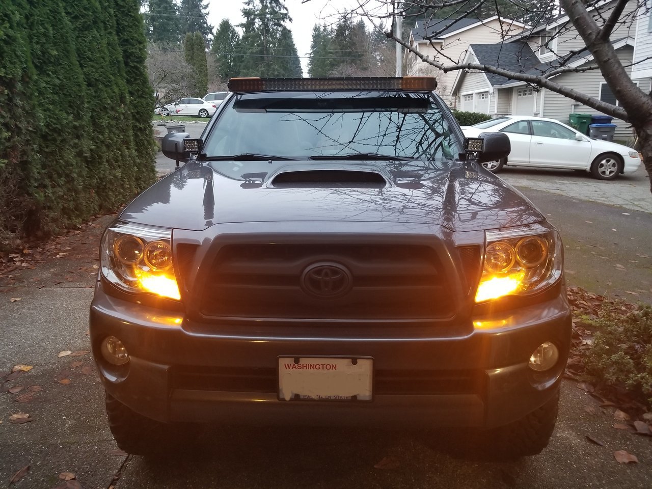

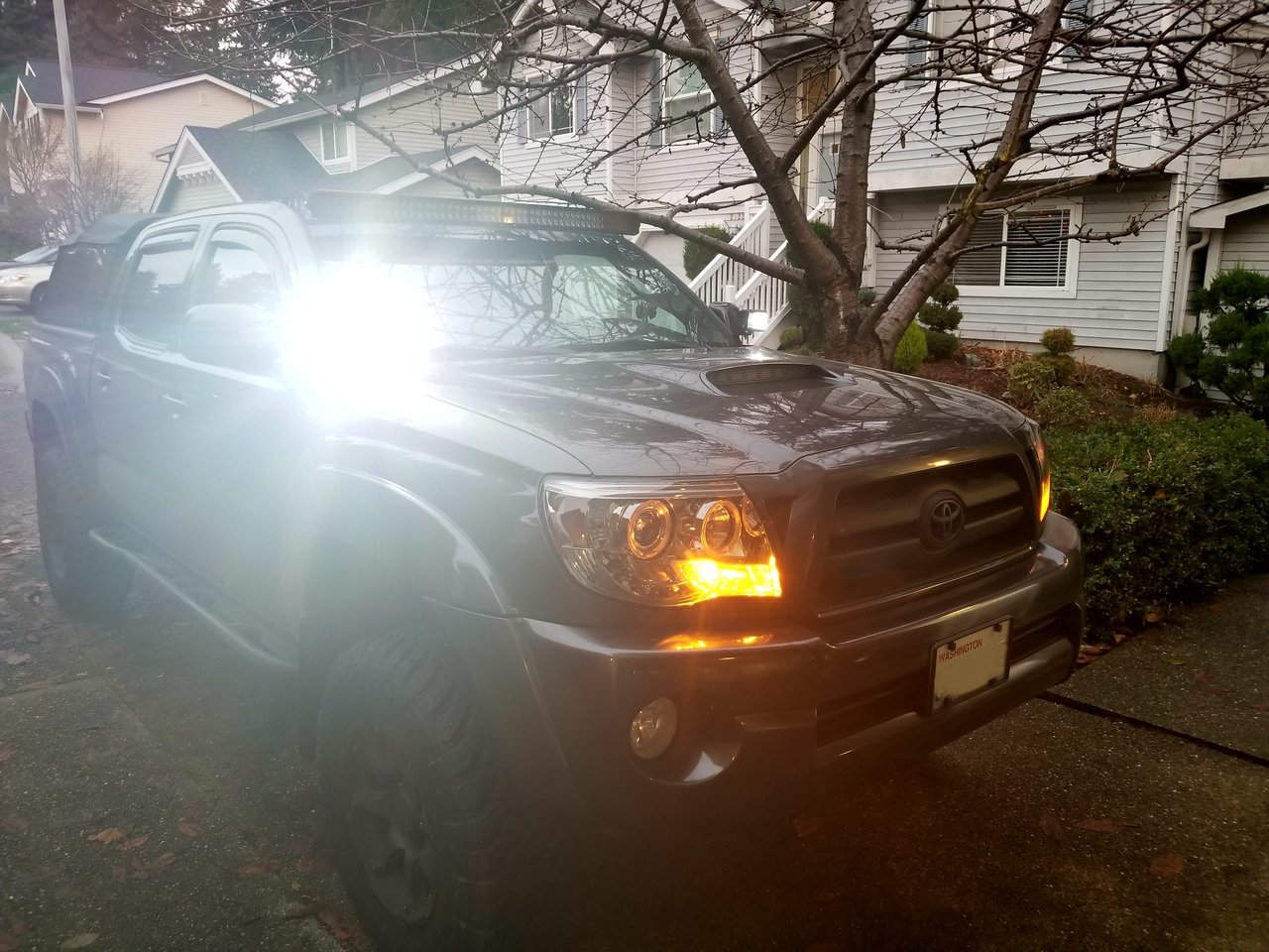

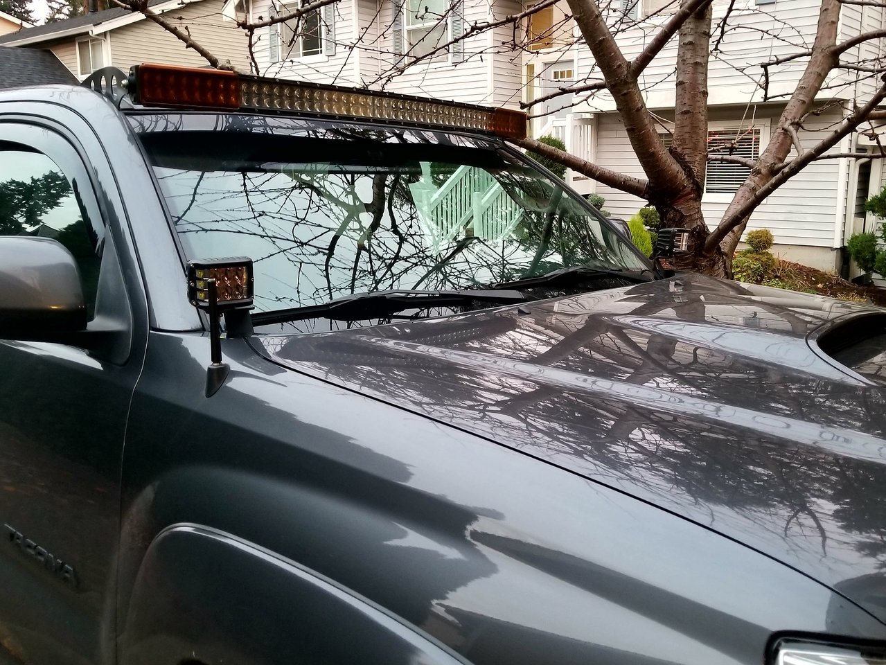

    Side shooters are on.

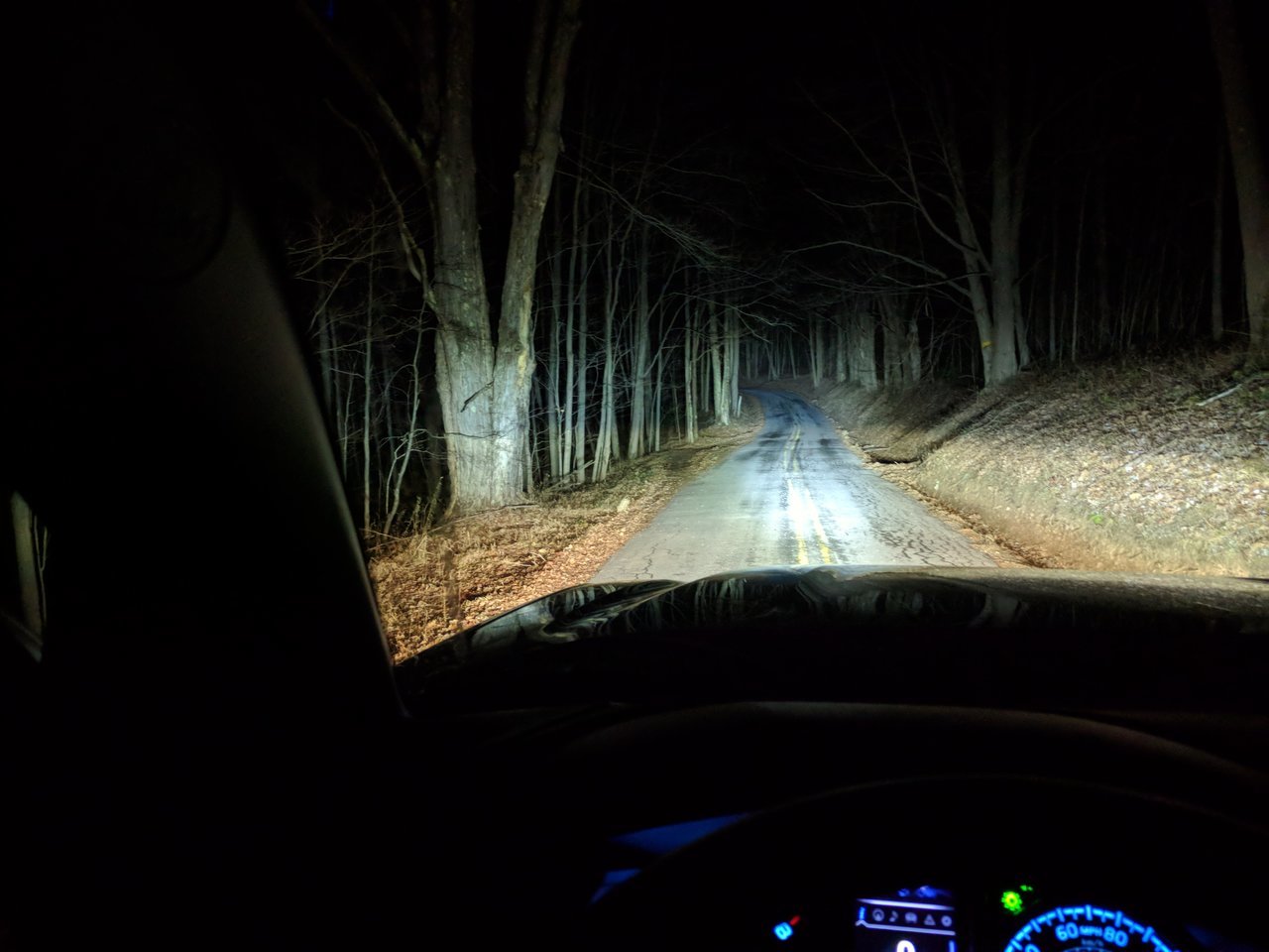

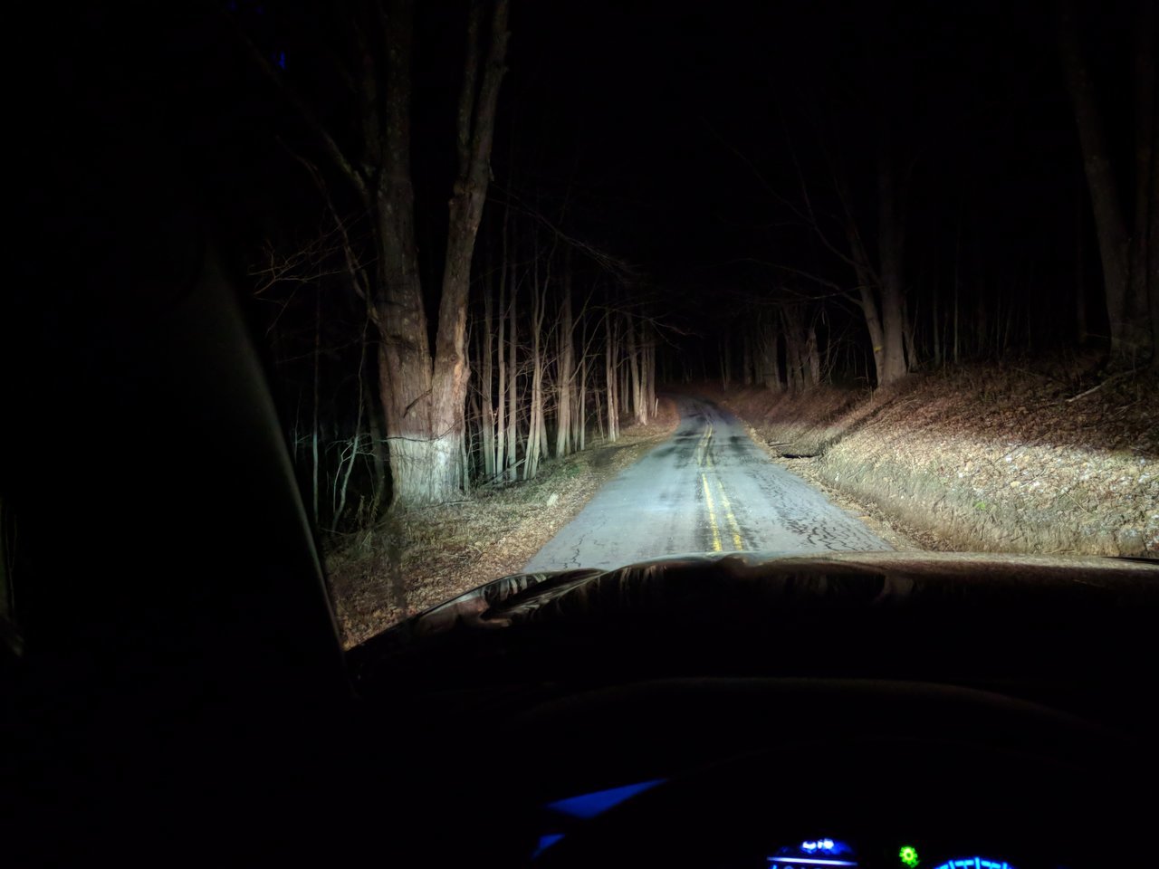

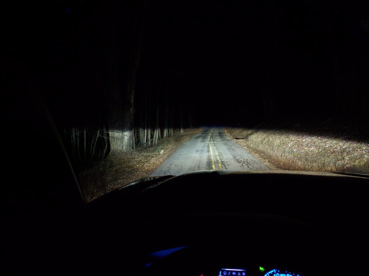

    I chose Cali Raised combo because I don't need long range illumination.
    35W HID low
    Fogs, Lows, stock High
    Fogs, Lows, Cali bar. Bar needs aimed higher, but you get an idea of the output

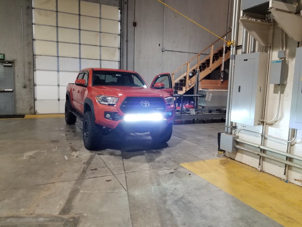

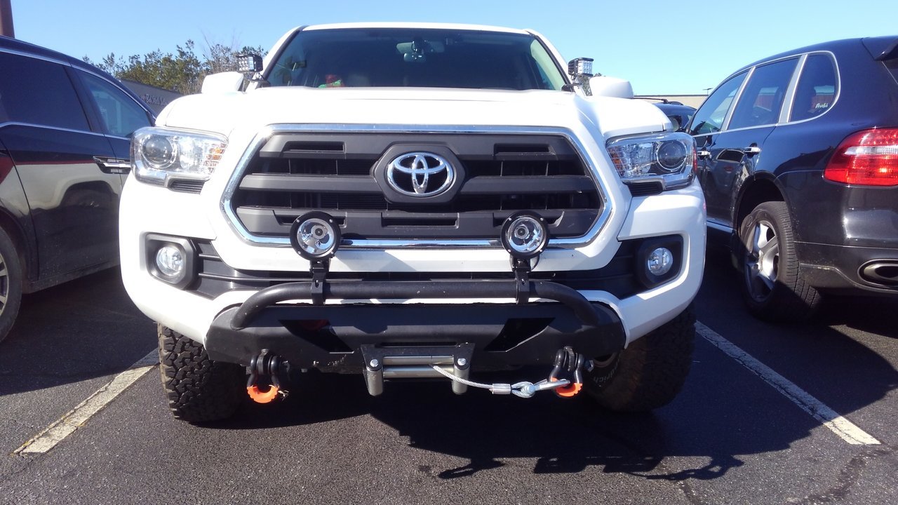

    It's been a while, but I'm posting back with the results.
    First up is the VisionX knock-off: https://www.amazon.com/dp/B06XD358NW - I ended up keeping this and mounting it on a tube mount to me SOS offroad concepts streamline bumper:
    I was surprised, it pulled a lot of current. 2.81A at 11.9v:
    The beam is laser-focused and has great throw. I wasn't able to capture it well and didn't get a picture, but it lit up a small portion of the treeline way past my neighbor's house very well, at ~100 yards. This one won't flood an area with light from a distance, but it will give you a perfectly illuminated spot where you're going.
    The 4D lens was actually more disappointing than I expected:https://www.amazon.com/dp/B01NAJ2TJD - I returned it because my flashlight has a better beam.
    It drew 1.1A at 12V:
    You can see the center of the beam is illuminated, but there's a lot of spread (look at the trailer to the left lit up) and isn't nearly as bright, which the camera does not capture well. The light faded off just past the bushes that are lit up, meaning this light is worthless as a spot beam. There's just too much dispersion for it to be good at a distance.
    Last is the side shooter. Amazon's page for it is this: https://www.amazon.com/dp/B07411H21B -- but that doesn't match the exact one I have. I always buy my chinese knockoff LEDs from the Kawell seller; the quality is always exceptional, unlike a lot of the other random sellers. This beam was a flood, so I was expecting broad illumination and got it. I ended up keeping these and mounted them on ditch mount brackets:
    It drew 1.49A at 12V:
    Again, pictures are hard for comparison, but it had about the same illumination as the 4D lens but as a flood beam, while drawing ~0.4A more current. The "side shooters" are a bit gimmicky, but they definitely do give slight illumination directly to the edge. You can see a clear line cutting off on the right, whereas there's a fade to the left. The one tested here would be the side shooter for the left side of the truck, so it has a hard cutoff on the right edge and a nice fade off to the left. Not captured was the area to my left, which had illumination from the 3 LEDs on the left.
    Here's the setup on my taco:
