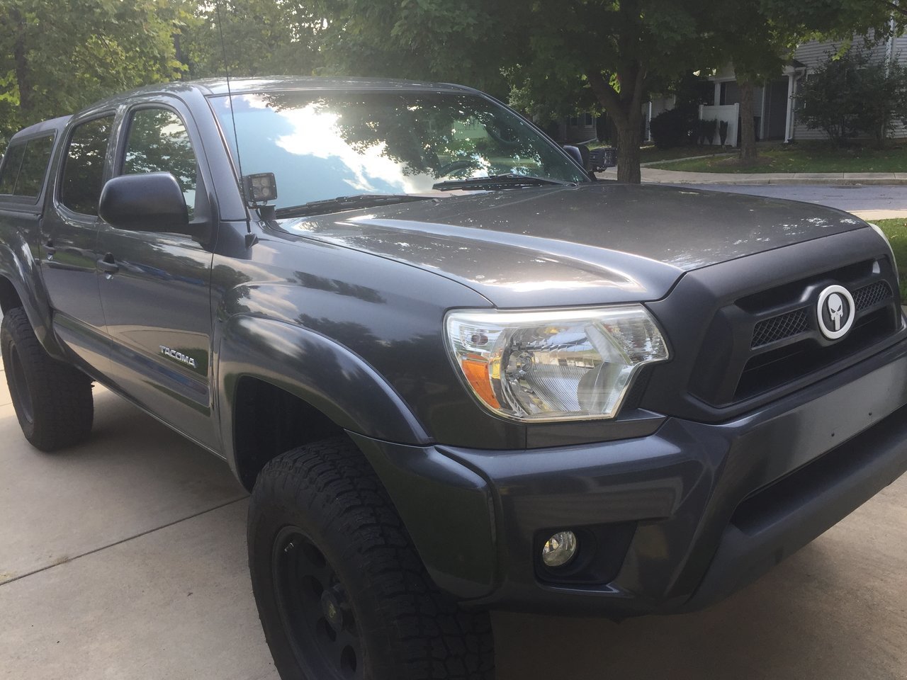

    F7319F1E-247E-4AE4-A950-AA1D701C652C.jpg I have the call raised plug and play wiring and Cali Raised ditch lights on my Tacoma. Was a super fast install and the lights are bright. I live in MD and it rains a lot here and have never had my wipers touch my lights. So I vote yes on caliraised and that you get pod lights
