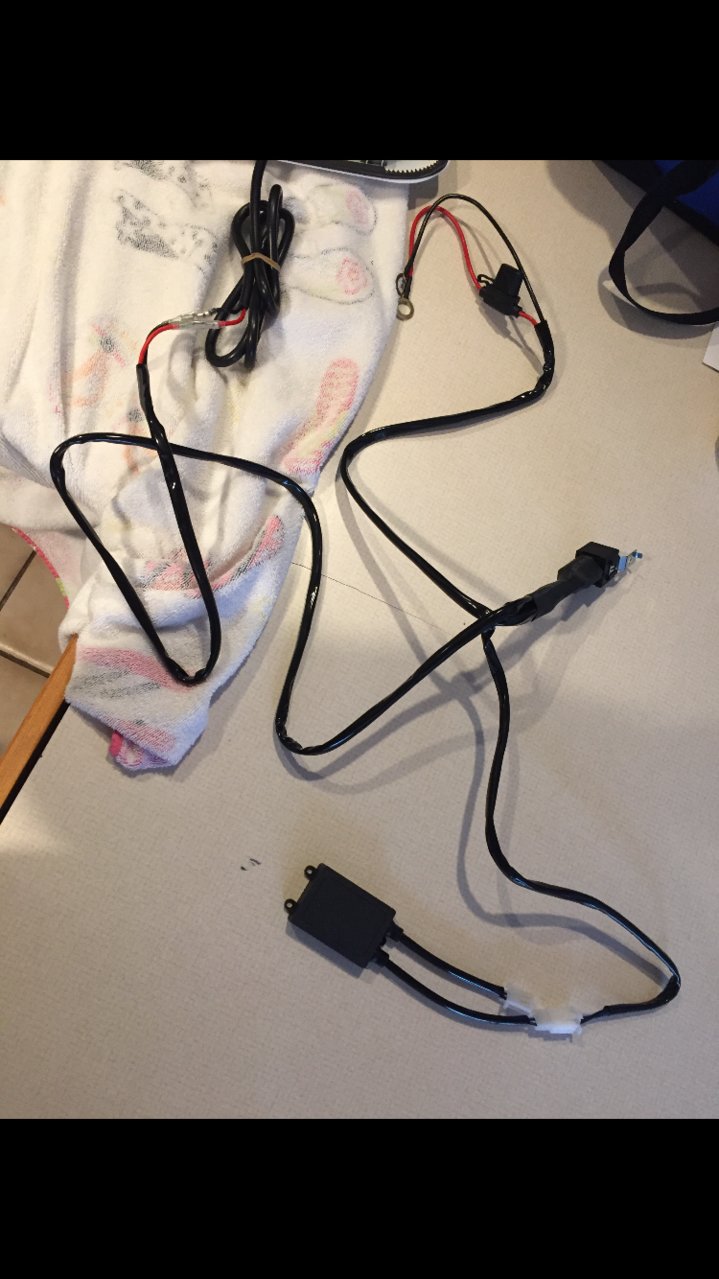

    That is the light bar I got. It comes with a small map showing you how to wire it. Essentially you plug the wires in to eachother than ground the black and red to the connections they use for the stock witing. Red goes on the battery, black just on a bolt just to the right of the battery. I only used the remote so the switch wiring was not used.
    Here’s what it looks like wired:

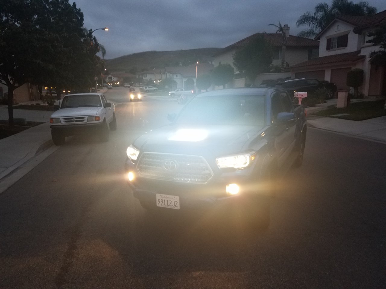

    Got the lightbar installed yesterday.Took maybe 30 minutes. Thanks OP for the thread.20180511_195411.jpg

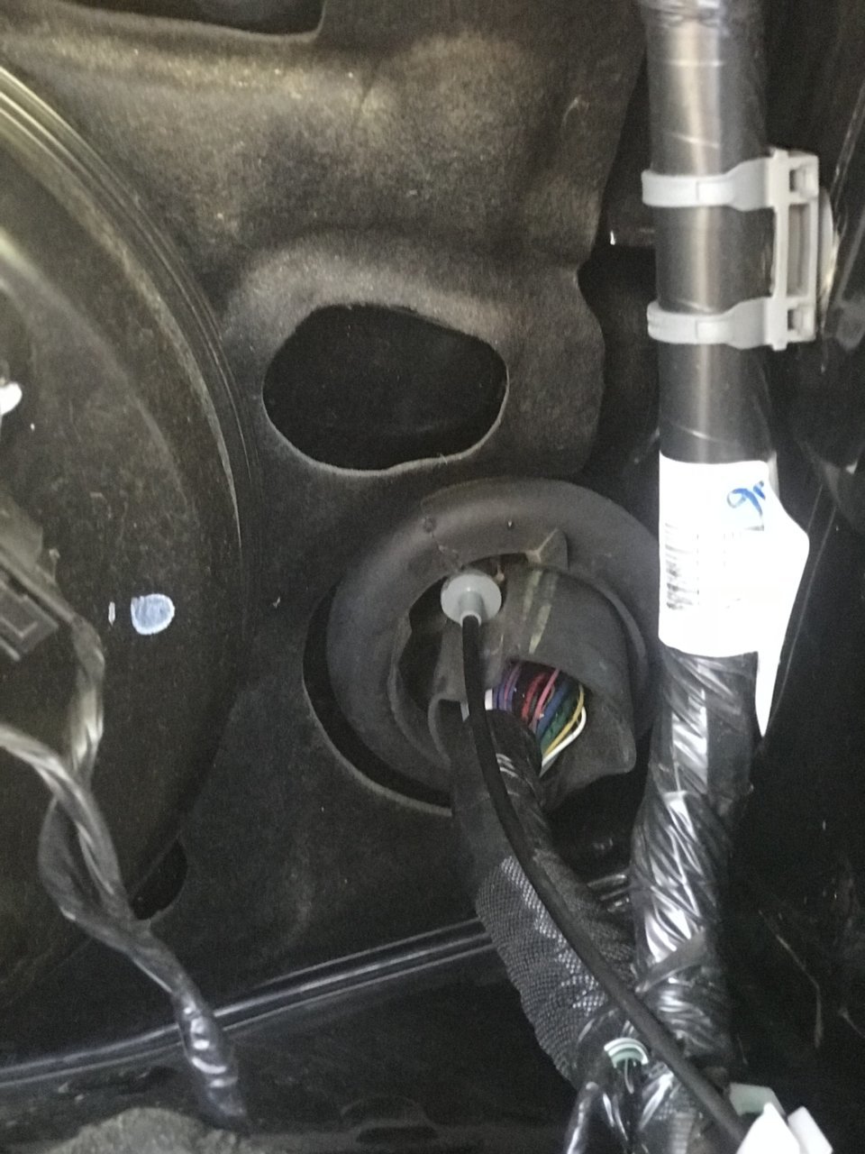

    Is there a special way to get the wiring through the firewall? I’ve seen one video go through the side of the rubber housing all the wires. Help needed. Thanks

    Thanks OP for the write up!! Added some lights in my hood scoop. Proud of myself that everything worked once connected.[​IMG][​IMG][​IMG]

    I went right through that grommet. I'll take a picture in a little while...

    It was too tight to get into the opening with all the wires so I went in from the side of the rubber gasket thing. Followed CaliRaised YouTube video on installing their light bar.
