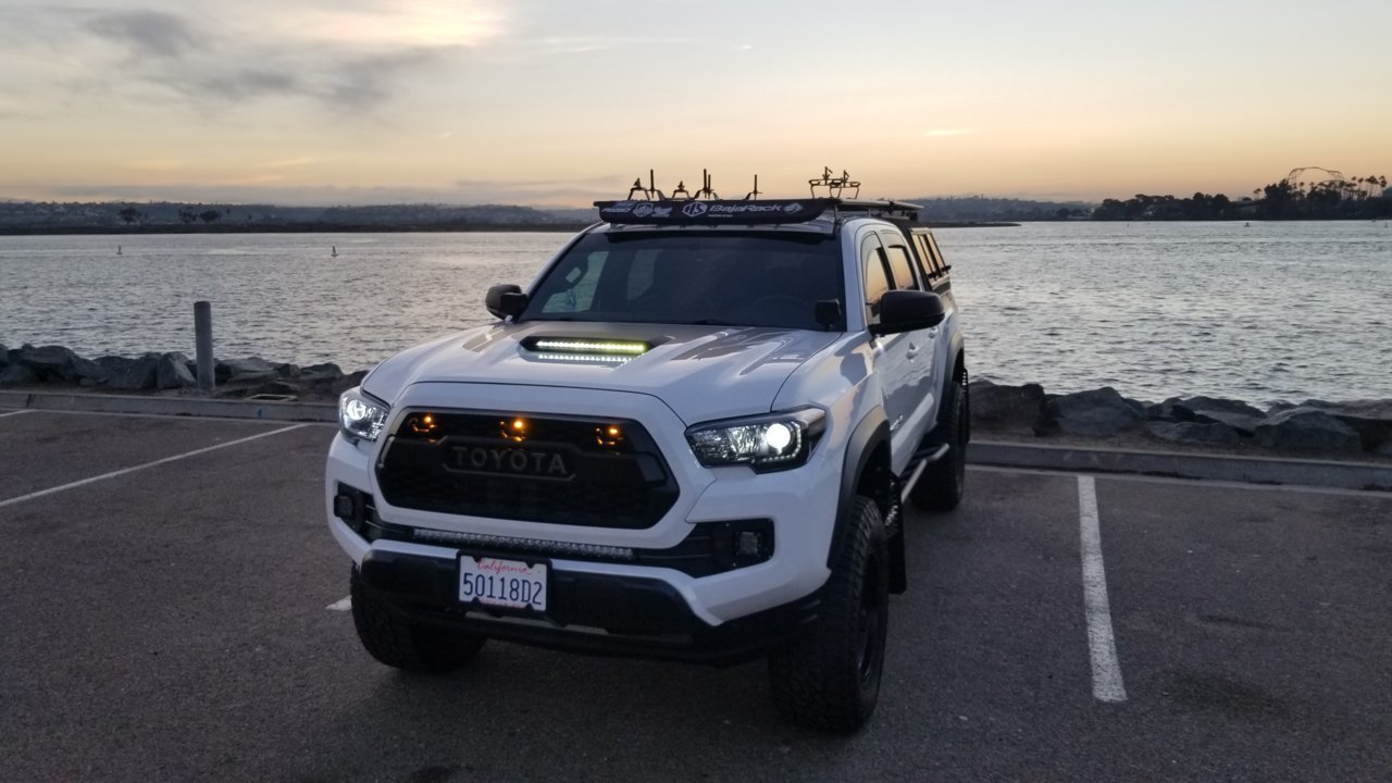

    Made mine own setup and cost $55 in parts. Easy peasy. 16.5" Slim single row light bar, harness and remote so I can turn on from the outside.
    And another plus. Lifetime warranty.

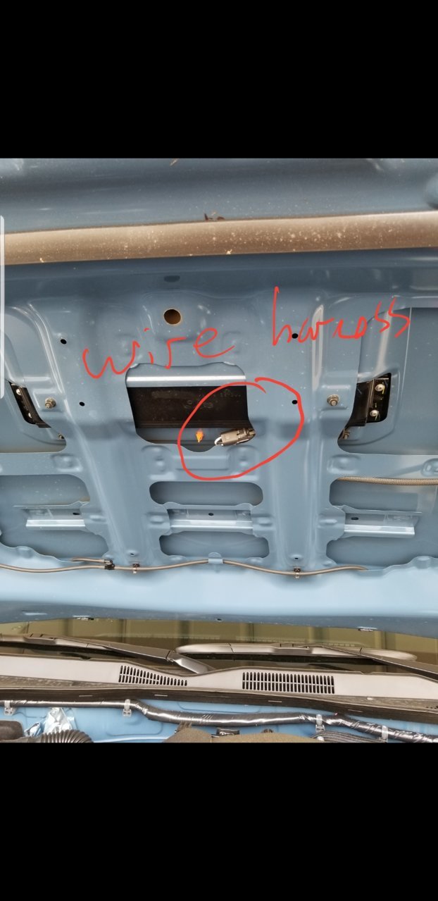

    Yep, will do later this afternoon

    Was it difficult wiring it through into the cab?

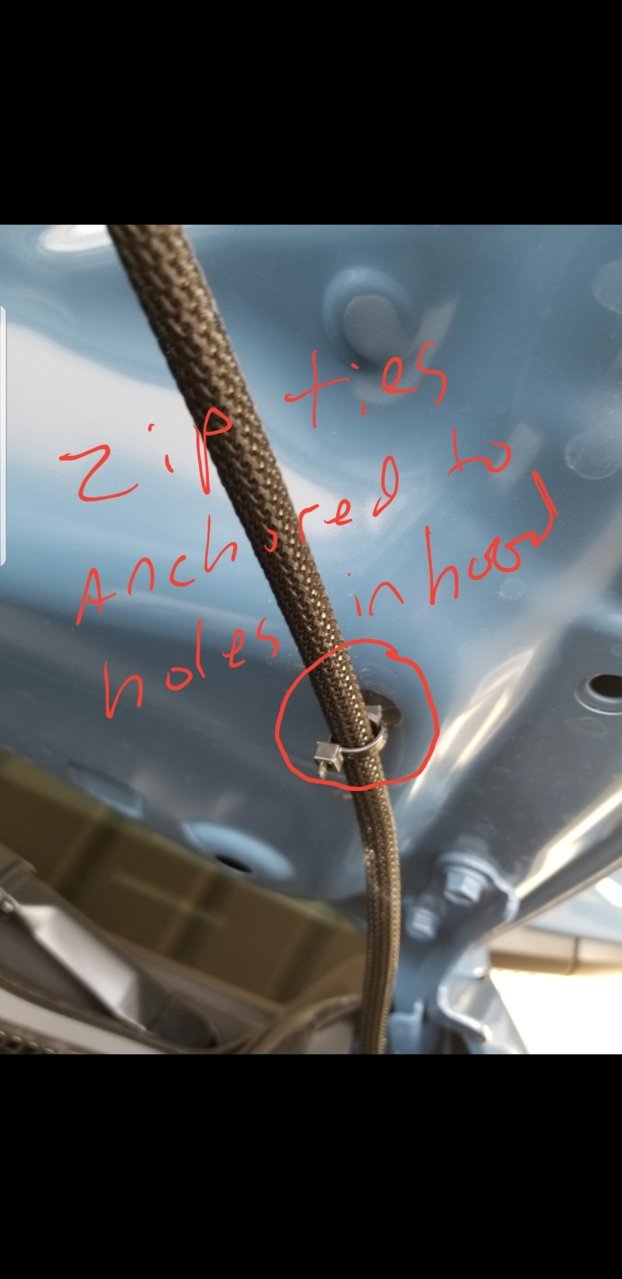

    Not really, just took some patience. I locked a zip tie around the wire, then fed the end of the zip tie thru the firewall. Then got inside the truck and pulled it thru
