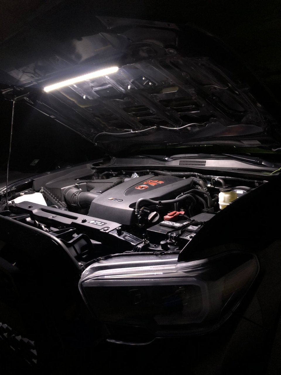

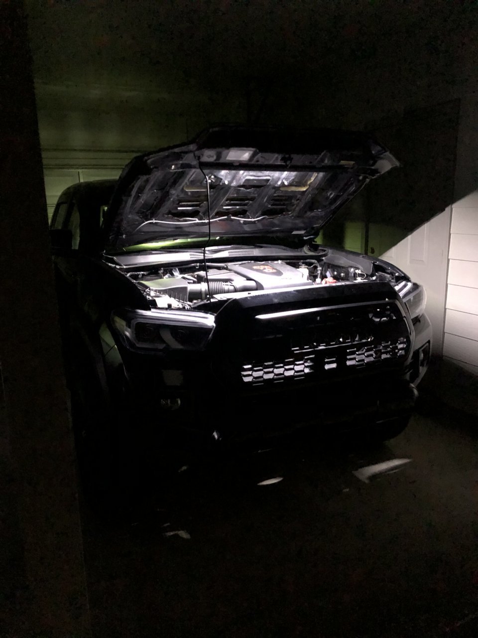

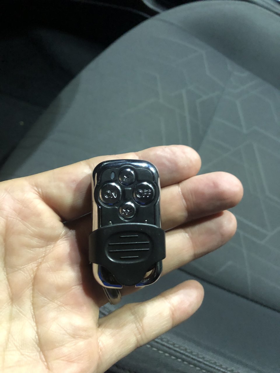

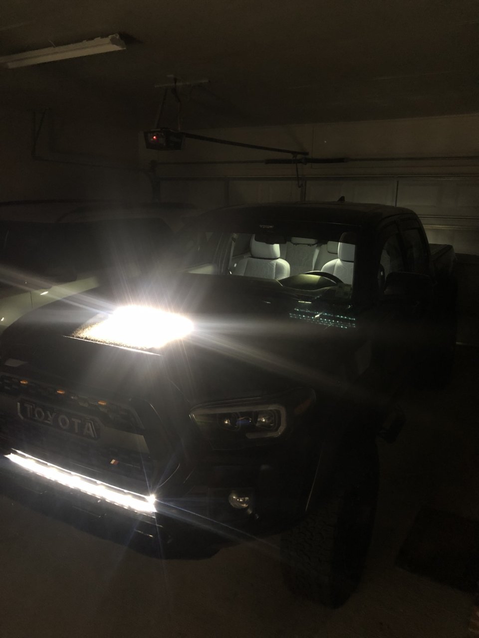

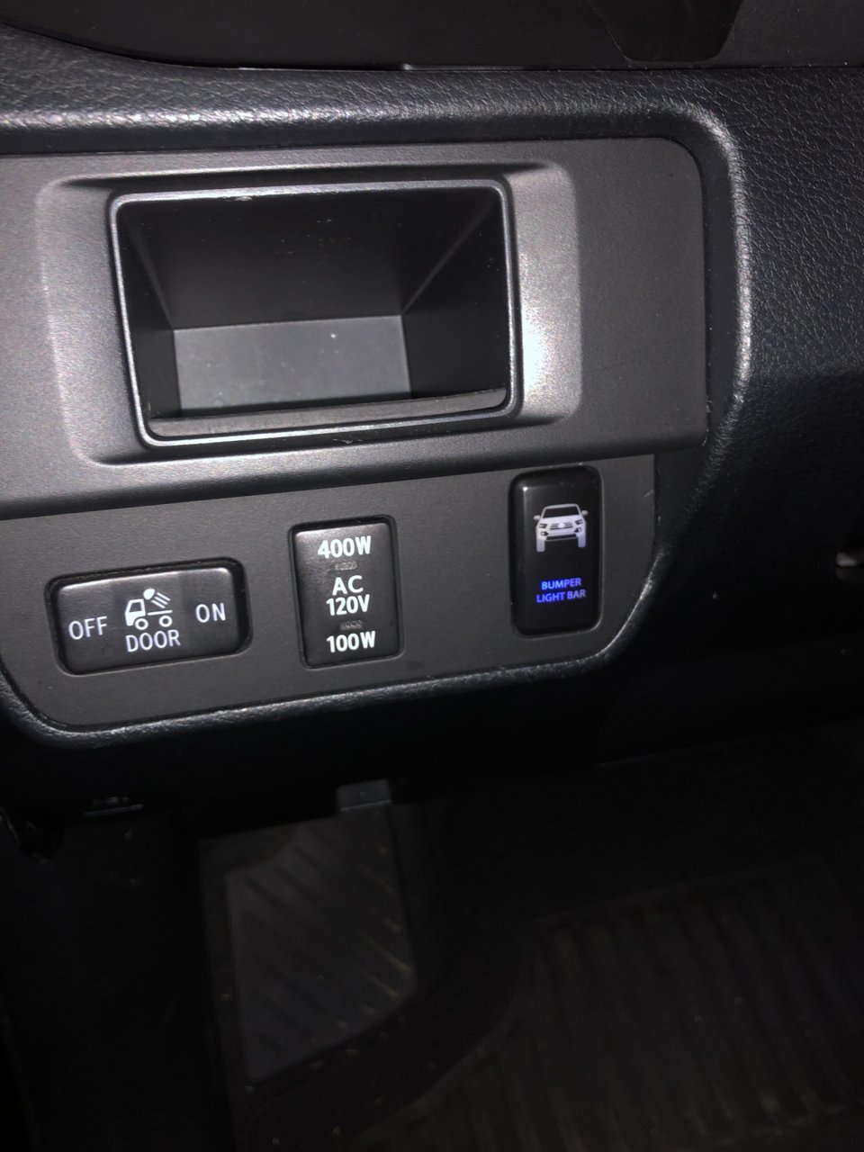

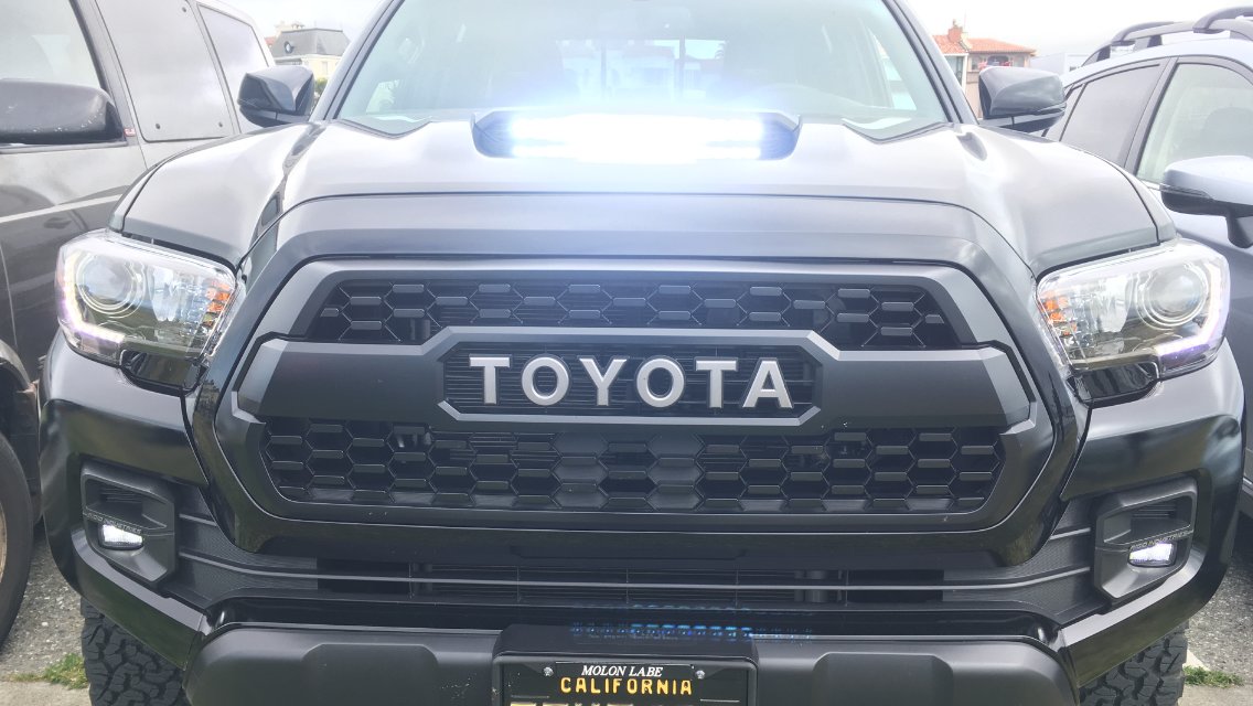

    Put the same one in as you did using your technique (3M double sided tape and foam insulation tape to fill in). It’s solid. I hooked up the remote and wired it to an OEM looking light bar switch. Both work. It’s bright!
    While I was running wire, I decided to add a LED hood light with a pin switch (comes on when I open the hood, off when it’s closed). Hid all my wiring.

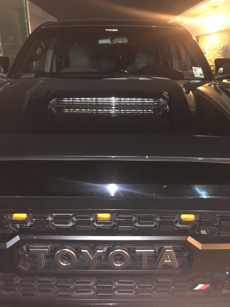

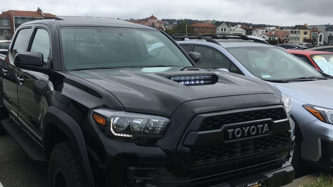

    SpartanXCustoms Stealth light bar. It fits like a glove.EB956F13-9CB2-454F-BD53-C9C6FAB72E5B.jpg54AE32CE-FD80-487C-A1E3-97F0AF0DD51A.jpg

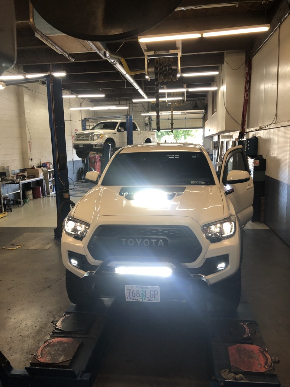

    I put mine in in April. It’s tight in there and hasn’t moved. I used a different switch in the interior, plus have the remote- both work.
    I work nights till 3am, so I use it a lot on my way home. It lights up dark roads better than the brights. I like it!

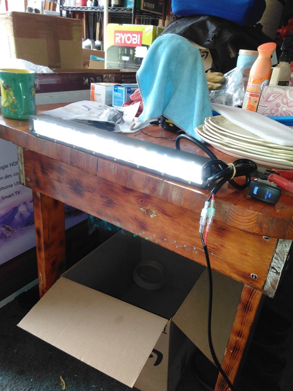

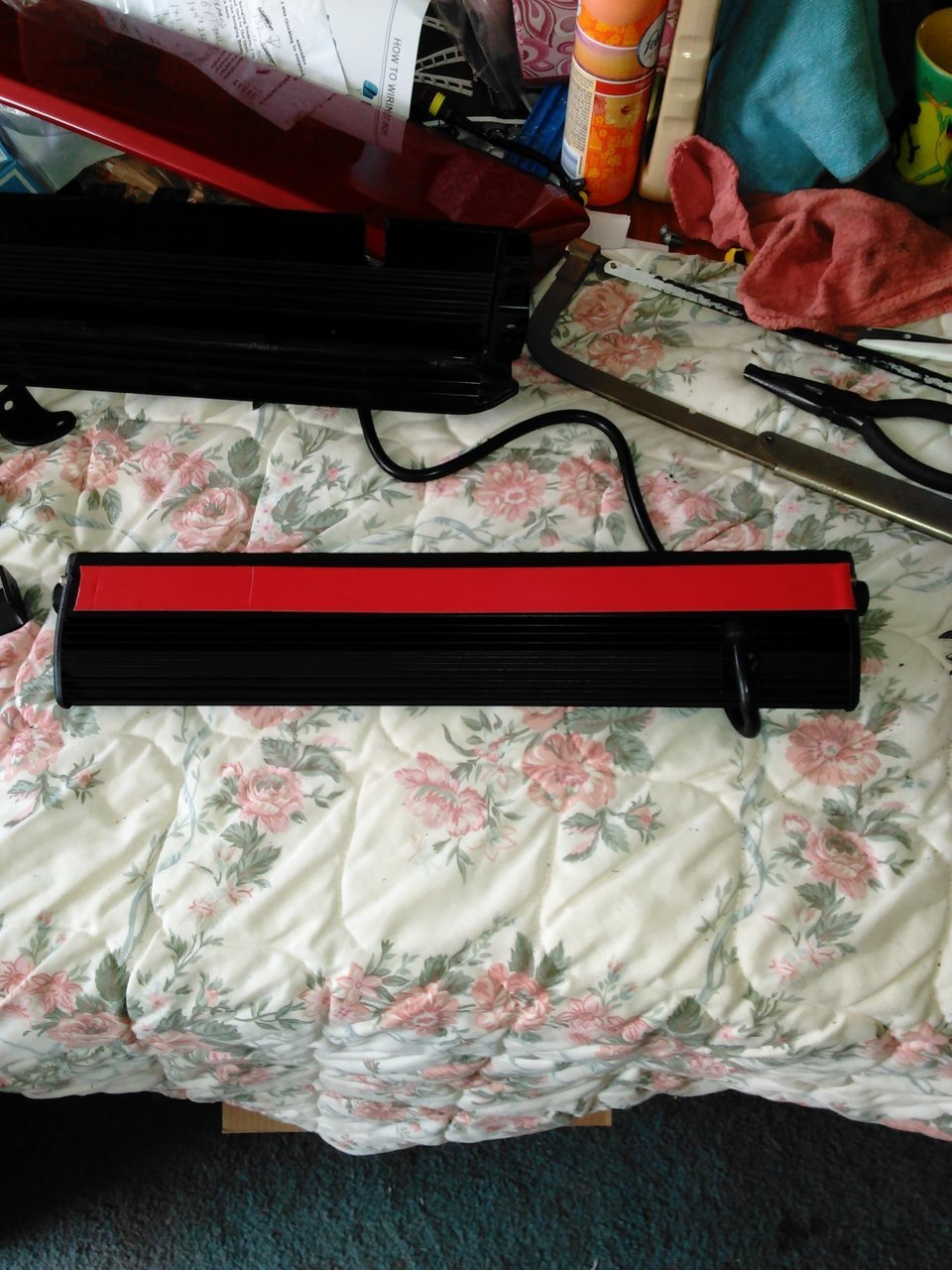

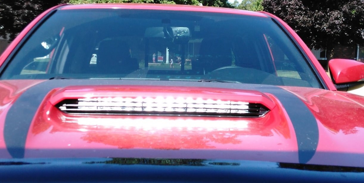

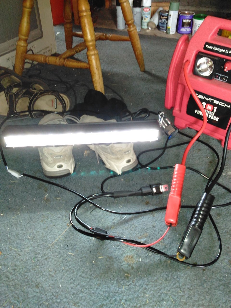

    Before I did anything I tested it for over an hour while I installed my new grill, the light and relay switch only got slightly warm.2.jpg
    I tried using the small mounting brackets but the bolt heads would not fit so I just ended up using double sided 3M tape the full length of the light. This light fits very snugly in that box and the tape just keeps it from sliding side to side.

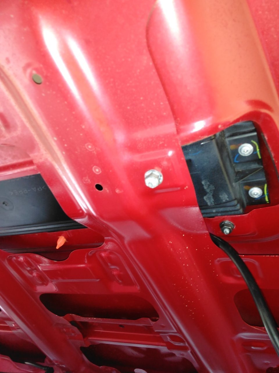

    You will have to notch a 1/2 inch wide slot at 1 inch deep for the wire, I just used a hacksaw and pliers then filed the burrs off. You need to notch it deep enough so that the wire will clear the sheet metal.
    Assembled.
    Install finished.
    Summary:
    I noticed that the ones on fleabay are longer than the one on Amaz0n sold by iJDMTOY there are only 12 reflectors in iJDMTOY's for $108.00 where as the fleabay ones have 17 reflectors and you can get them for $34.00. The reason that you can use the brackets on the more expensive one is because it's shorter.
    Go back through this thread and you can see the difference's in length on the ones that are lit up.
    These fit very well in our scoops with only about 1/32in. of play and 1/4in. of play side to side so I am convinced that double sided 3M tape will keep it from sliding side to side.

    I got this one off eBay with the rocker switch that someone posted the link to. On the directions it says that a remote can be added.
    Does the remote reciever plug into white connector where the switch plugs into the harness?
