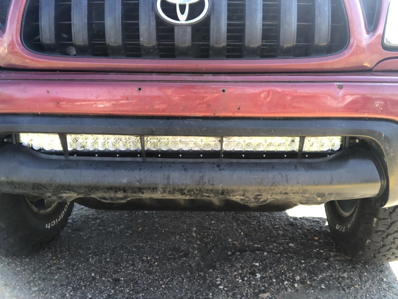

    Anyone run a light bar in the grille of their truck? Interested in doing it myself and was looking for advise on how hard it was to do and what all you had to put into it to make it work.

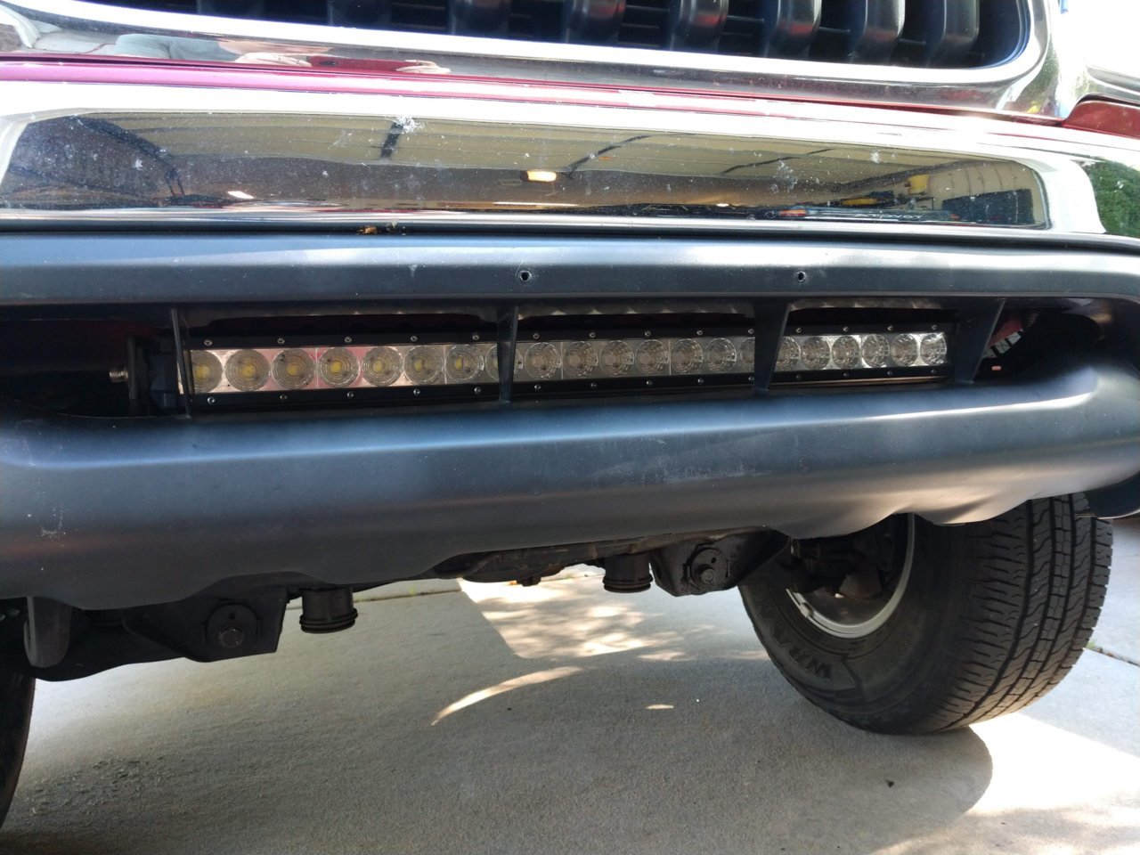

    If by grille, you mean the lower valance, then yes Ive got one! 20" single row. IMG_20190611_163820466.jpg

    Yes that's what I meant by grille! Did you weld those mounts in there? How hard was the wiring?

    this is so sick! You got any write up of what you used?

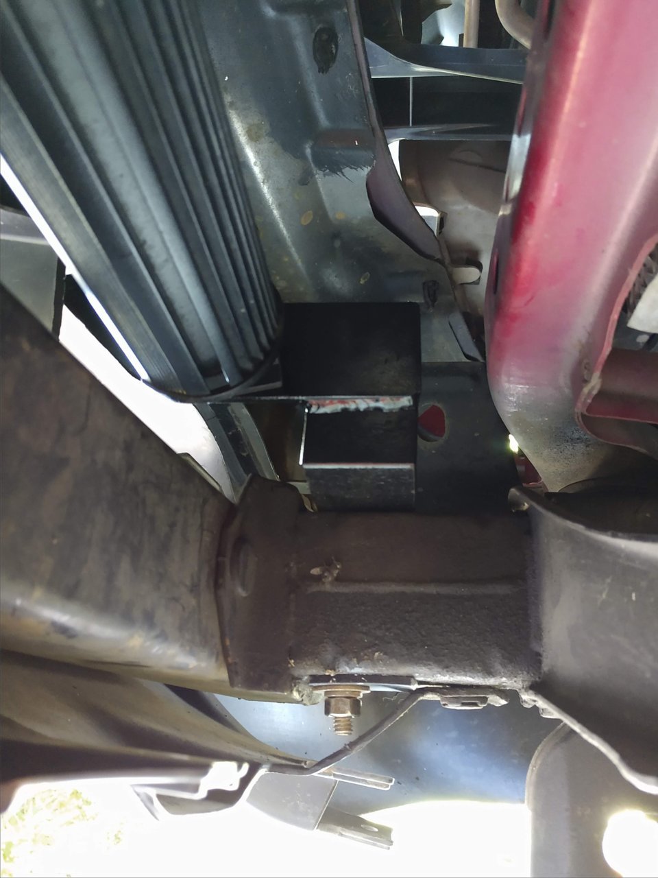

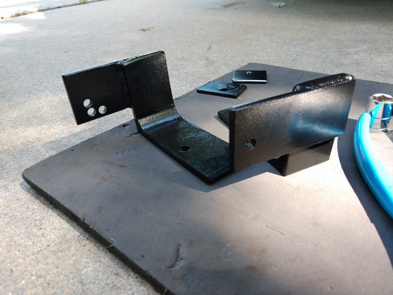

    Mounts bolt through the frame, there is a hole going top to bottom at the very front of the frame rails. I first had some bent pieces of aluminum as mounts, but I needed to fit horns in behind the bar so I welded some new ones that pushed the bar forward about 2". As for wiring I used ChrisFix's video on youtube. But I wired the switch straight to the battery instead of using a fuse tap like he did. Just use a relay and its pretty easy.
    See above.
    I would so make these mounts to sell, but unfortunetly my lower valance has been tweaked by a minor accident so my mounts are different on each side to make the bar appear level. You can see how many holes I had to drill on the right mount to find the spot where the bar looked most level.IMG_20190611_161311773.jpg
