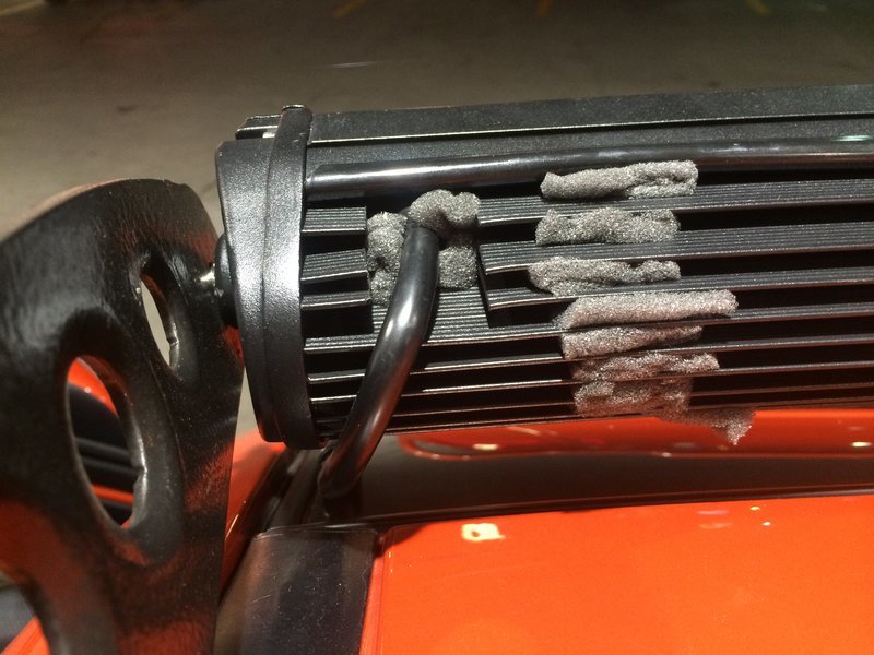

    great remedies here. I just installed my light bar this weekend, and knew there would be wind noise and was ok with that. But, damn:frusty:! that high pitch shrilling harmonica whistle, had me thinking about taking the bar off and selling it. Went to home depot and picked up a pack of air conditioning weather stripping for about $2 and 5-10 minutes of cutting and stuffing, the psychotic harmonica player on top of my roof is dead. Thanks guys for a great informative, helpful thread. :thumbsup:

    IMG_3539.jpg IMG_3540.jpg For the most part the annoying whistle noise is gone by probably 90% if not more. As I get more time, I may go back and probably add a few more spots of the foam strips into the fins of the light bar. Similar to how Ambiguouse the op did on his in post 21. A great solution that is friendly on the pocket. Probably easier than the door trim method. I know it took me longer to install the two strips of door trim that I have on the bar prior install, than it did for me to shove the foam into place. I guess I got lucky because the foam in the picture are the only ones I have added and it killed the sound for me.
