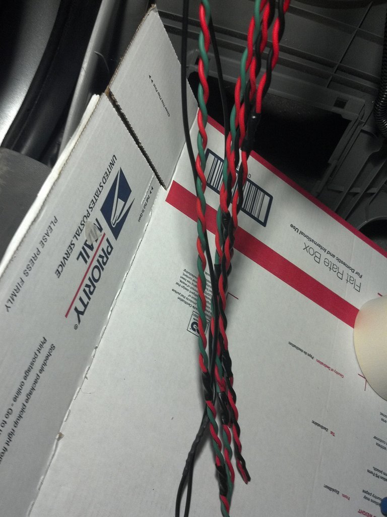

    I make all my own with a few spools of red wire and black wire. A few hours and it's all custom and clean.

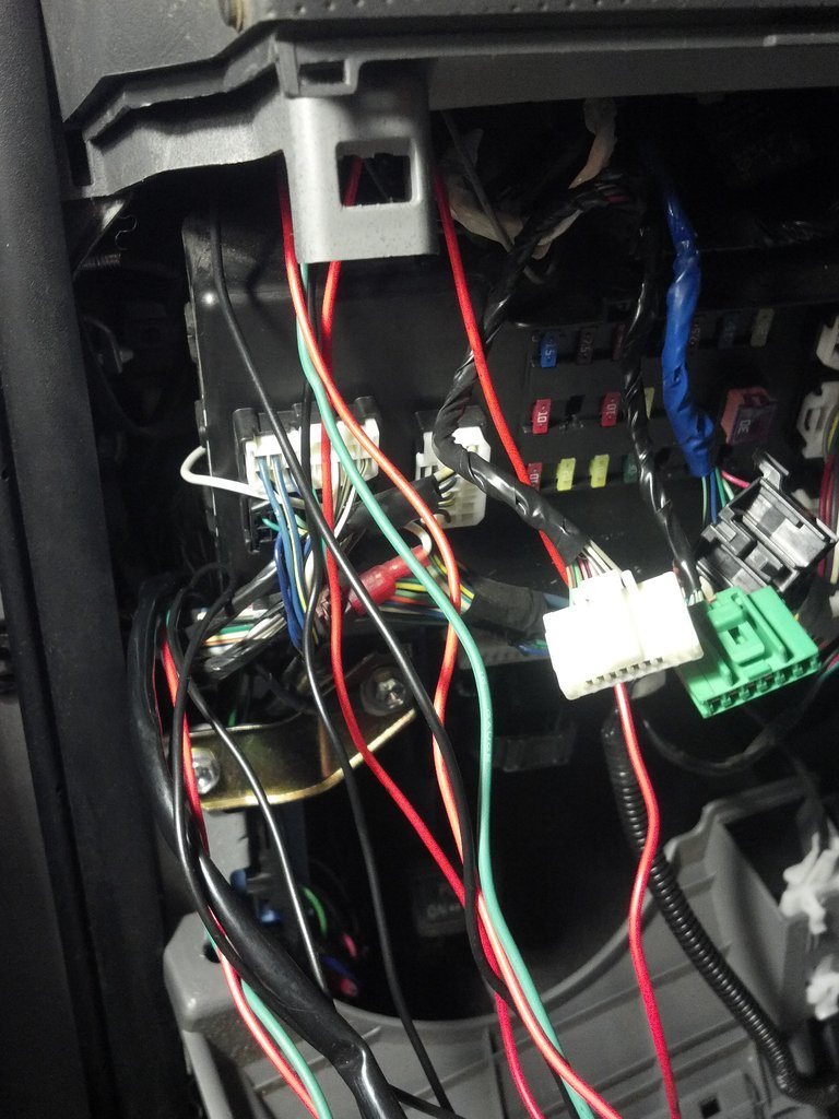

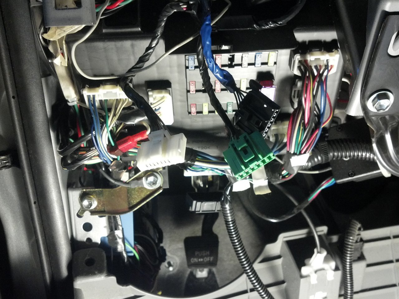

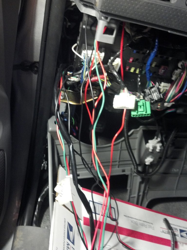

    sames
    after that last pic, you cant even see my wires, and the area is cleaner than factory was.

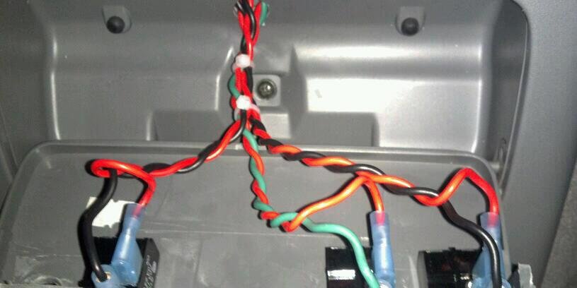

    You guys that make your own wire harness, what does the back of the switches look like as far as how to attach the wires to the switch?

    I just use simple toggles in my overhead console, so 2 spades

    I have toggle/aircraft switches for my lights. They're uninsulated male spade connectors.

    not the best pic, but u can see what I mean3gZmNx_95ba80a75b4c4b964fcc62f2183dd621db0d5511.jpg
