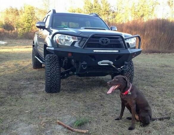

    SOS concepts full aluminum plate bumper. Totaled out with full hoops and all options it weighs roughly 65lbs.
