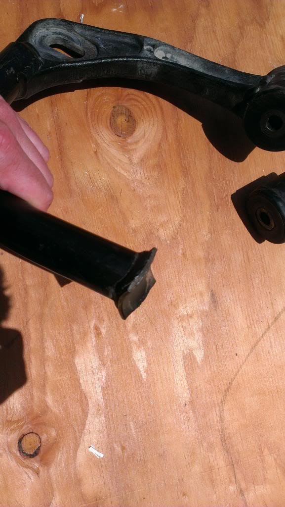

    Plain and simple I'd run stock arms over LR UCA, any day.
    I've seen enough issues and seen the quality difference.
    EDIT- here's a quick Google search...quality stuff. Sorry for misleading...can I say not good now?
    IMAG1362_zps3f0e5624_d8b3b345f2295694be2c0e303330d8eecf3e3097.jpg Also, plenty of guys DD with Uniballs in harsh conditions, not really hard if you perform maintenance...and that being said not much maintenance if your running SS balls.

    That sentiment is not what your post conveyed. Uniball is one specific style of UCA, LR is not the only make of ball joint UCA. Also, LR works very well for a lot of people. Plenty of members on TW that offroad seriously run the LRs. Have you ever run them? Not trying to attack you, just want to make sure that OP doesn't get the wrong idea from your post.

    I refuse to run them and everyone I wheel with that had them ditched em or wants to.
    Bushing issues, cracked welds...critical suspension components are not something to go low budget on.
    Sure Camburg makes BJ tubular UCA, but for the $$ difference might as well step up to Uniballs. I think JBL or something like that makes BJ arms now too.
