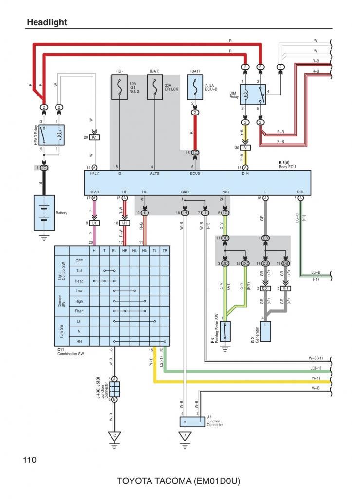

    So the past few days my marker lights have been coming on while the truck is off and has been parked for awhile. This morning after working out I was going to my truck to leave and the marker and head lights were on and I couldn't start my truck and needed a boost. I have got in my truck while they were on and hit the brake, turned on/off all lights to see if it would reset them and nothing the only way to get them to turn off is to start the truck and then turn it off. Any ideas of what it could be. I'm thinking short but I have no idea of have to chase a short.

    Does anyone know if there is a relay for the headlights/ marker lights? That is what it sounds like to me.

    There is most certainly a relay for the lights. I'm digging out schematics, please hold.

    i had this happen to another vehicle, it was a relay that went so they were always on cause they had always had power going to them. i didnt understand what was going on, had a buddy that worked at a dealer get me a new relay and it never happened again. i dont no if the relay was stuck "open" so it just kept power going to it or what but that did fix it for me. it was a jetta, i no its a different vehicle but maybe its the same thing.

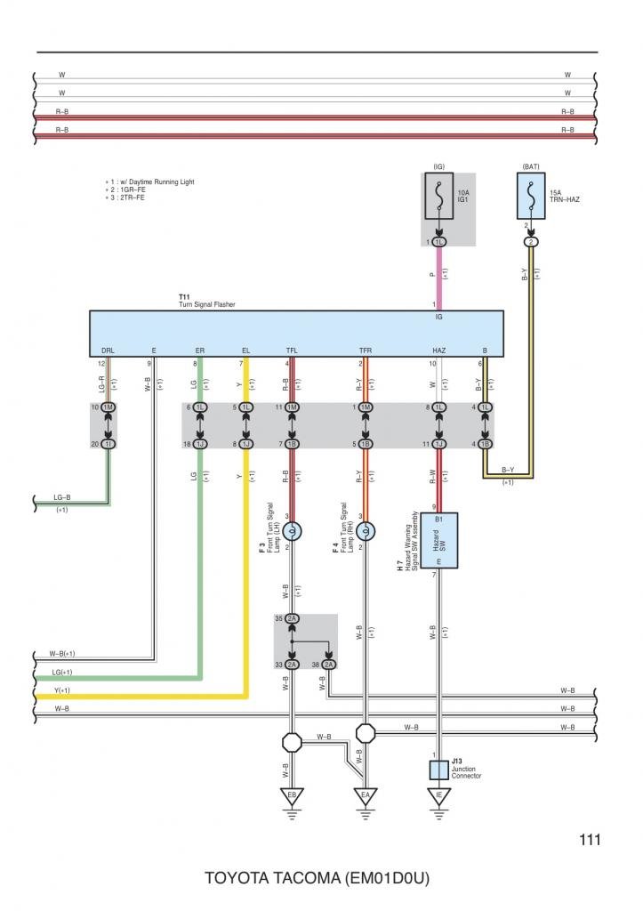

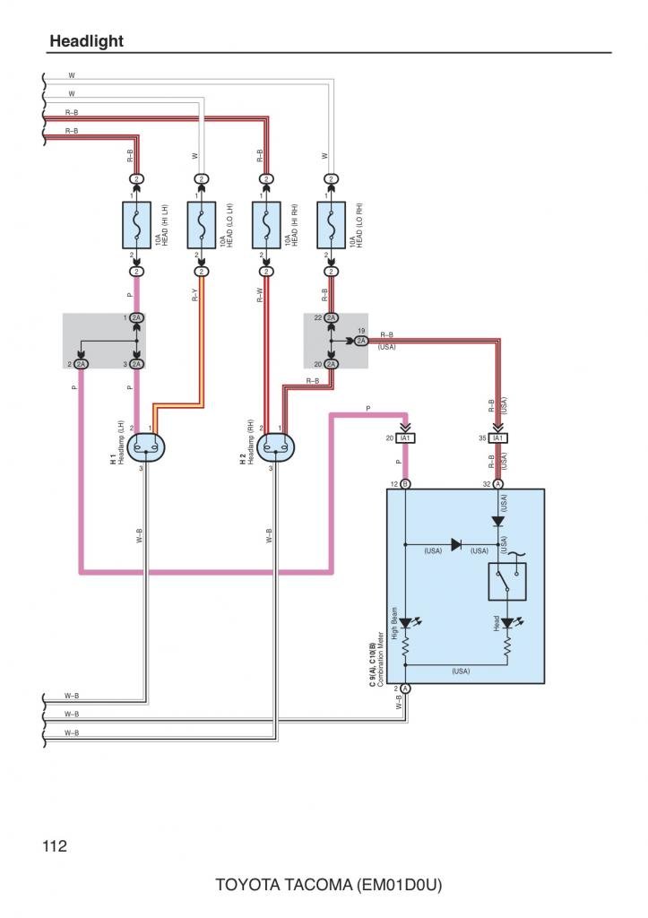

    I would change out the relay first and then hunt for a short... Incase you haven't found the problem yet, here is the schematics for the headlamps.
