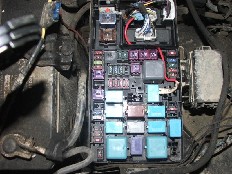

    PeitcedTiger has this mod that works VERY well:
    Foglights on anytime
    Several ways to do this, but this one was the easiest for me, and I haven't had them come on 4-hours after turning the ignition off like other methods cause. Apparently at least one other method ties into some ignition or emissions circuit that turns on 4 hours after the truck is turned off to deal with emissions so the fogs come on for a few minutes. I parked in front of my living room window for a year after doing this and never saw them come on once so.....
    Tools/items needed:
    • wire stripper
    • 1 quick splice
    • 1 female blade connector
    • 6" of wire
    • drill/bit same diameter as wire
    • shrink tube/electrical tape to reinforce crimp connection (optional)
    1. Locate the green wire on the plug in the pic
    2. splice into it
    3. run the wire to the fog light relay through a hole to keep it low and not hit the cover
    4. crimp on the female blade connector onto the wire
    5. pull the fog relay and bend the terminal in the pic to the side
    6. put the female blade connector onto the bent terminal on the fog relay
    7. replace fog relay
