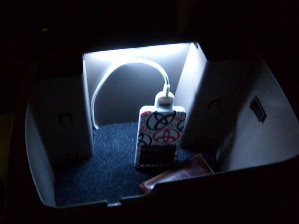

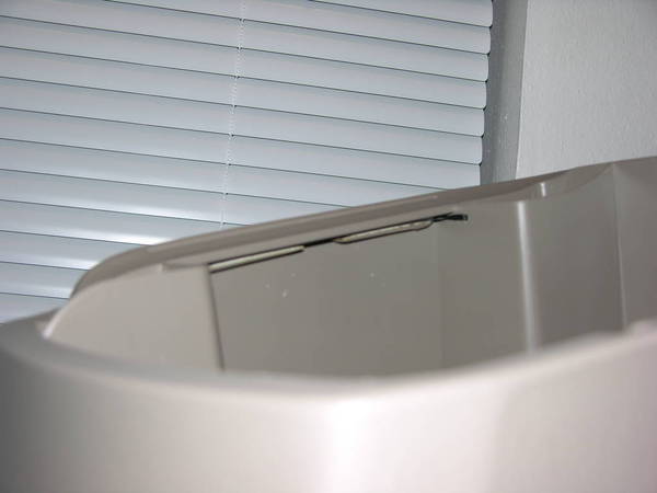

    I got bored a few days ago and decided to put some LEDs in my center console.
    I bought a package from Street Glow with two 3" LED strips with adhesive backing.
    http://www.streetglow.com/s.nl/c.460445/it.A/id.1774/.f?sc=2&category=5616
    Mounted them here, under the small overhang nearest to the passenger seat:

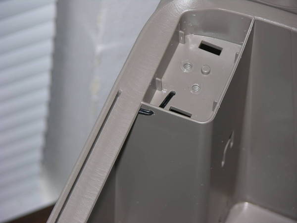

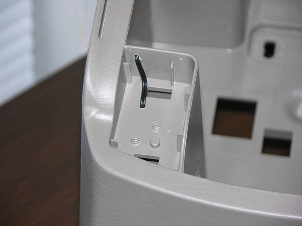

    Drilled some small holes where the lid attaches:

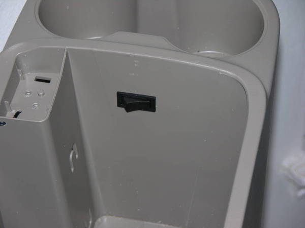

    Wired them up to a switch mounted near the rear cup holders:
    And here's a night shot:
