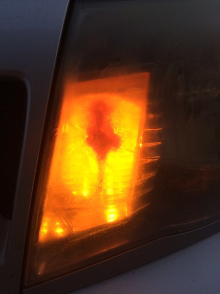

    so I was looking at my truck lights next the head lights. the ones that stay on all the time and it looks like it is burning the plastic is there a recall on that?

    Yes, there is a TSB that addressed the DTRL burning the lenses. They replace the light housing with a new one that uses an amber bulb and clear lens. No cost to customer. Check with your local dealer for VIN applicability. Good luck!

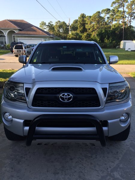

  17. Sep 29, 2016 at 12:15 PM

    I got 2 of these today for 122.00 with bulbs and a shop told me 40.00 a side to do them

    I got them changed just got to wait till dark to see if they are any good IMG_2132.jpg

    #199021
    2009 silver Tacoma SR5
