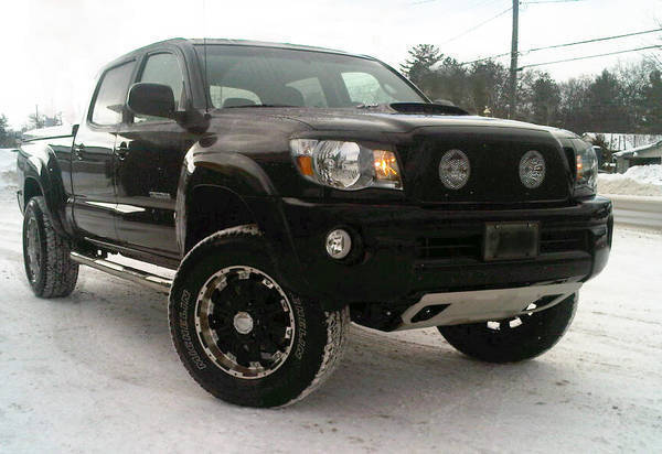

    TRD CAI, MBRP dual exhaust, PIAA headlights and driving lights, 5% limo tint, 3 inch Skyjacker lift , AFE throttle body spacer, 285/70/17 BF Goodright AT TA KO, Grillcraft MX with PIAA's behind the grill, anytime fog light mod, reverse camera anytime mod, and PIAA fog lights on the rear bumper anytime mod light bar behind back window with truck lights for reverse assistance, Optima Red Top Battery, Onza 3x5" LEd reverse lights attached to light bar behind cab
    Sorry it took so long and with the nast winter weather of course its dirty.

    ^^^too high^^^^

    5,748

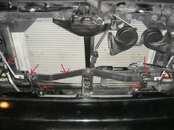

    Oh I see yours are much lower.. How did you mount yours though? I went right off the radiator bracket.

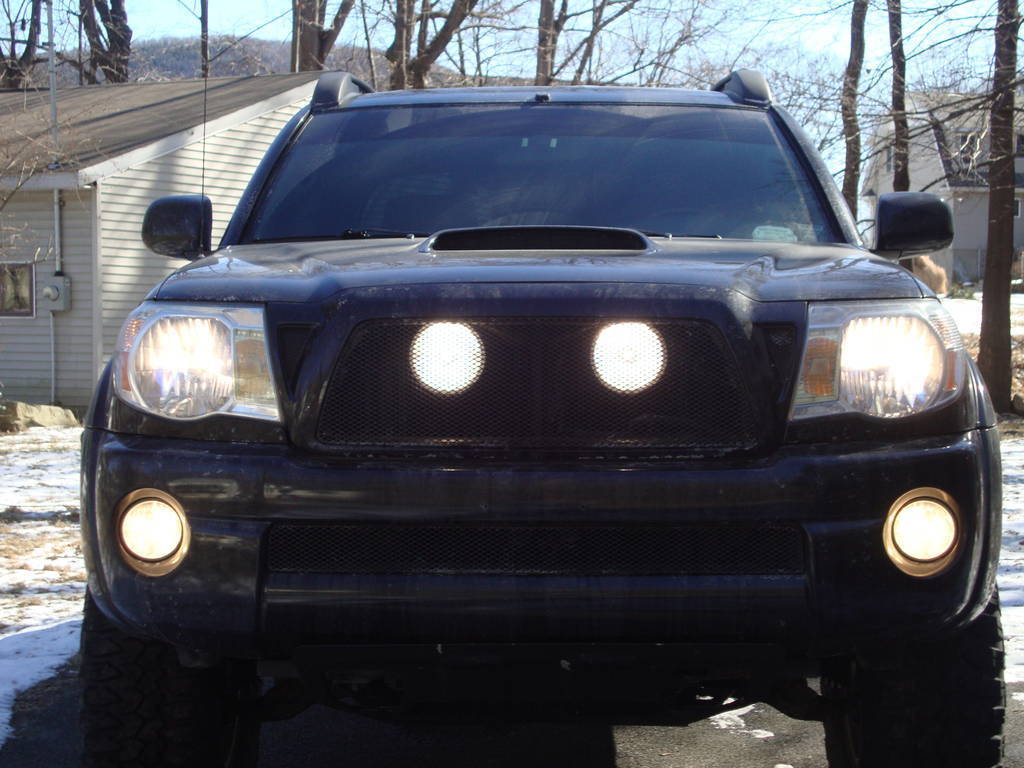

    Well I made up a bracket shown in the picture below. It looks complicated but was quite easy Took me about an hour. But it got the lights right where I want them. Didn't have to move the horns.
    http://www.tacomaworld.com/gallery/showphoto.php/photo/50449/cat/500][​IMG][/url]
    Somebody else said I should black out my skid plate but I think it would disappear and I like the look of it.

    You could just run longer bolts for the fogs. I'll try to take some pictures and post it here.

    Next weekend i might try longer bolts at the mod/meet day. I will let you know how they come out.

    Here are the pics.
