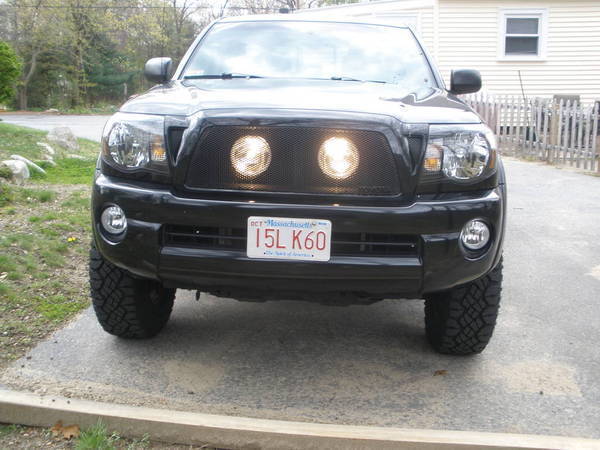

    Can anyone comment on how well the lights function behind the grill like this, as compared to mounted on a light bar?
    I think this looks phenomenal, but I also want functional lights!
    Also, any issues with the radiator heating the lights and/or wiring up too much?

    There is a noticable reduction in light output but keeping the lights as close to the grill as posible will mitigate this. Mine are about an inch away. I also don't have any heat issues at this position. Another option is to mod your lights to HID. I haven't done this but I think it would really increase functionality.

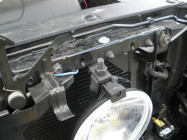

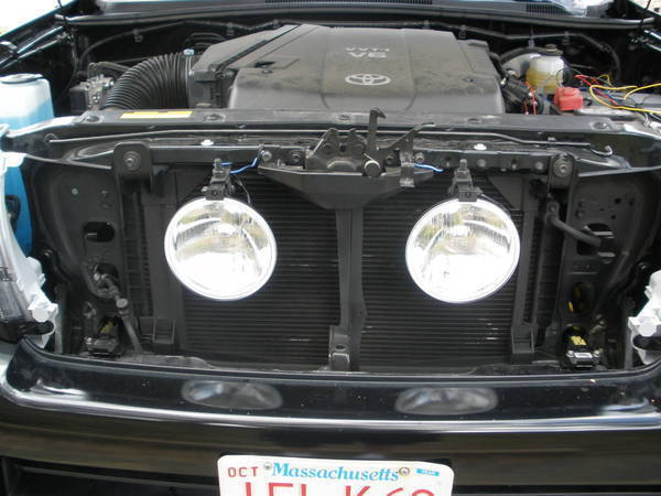

    This is how i did mine.
    I used a couple of L brackets and bent and cut them to the way i needed.
    Denis

    Do the lights move at all? I have 2 hella 700ffs that I converted to HID and mounted on a piece of angle aluminum behind my grillcraft, but they wiggle enough that when I'm driving it's very noticable and really annoying. If your method is more solid, I may have to use your advise. thanks in advance

    This mod looks very nice. Has anyone else tried the longer bolts drilled into the frame technique here? That looks like it would be the most simple way of mounting them. I'm not a bracket maker by trade, but I guess it's never too late to learn.
