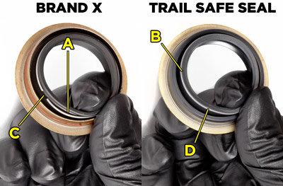

    I suggest replacing the seal too. That is what I did for my install. Also used a slide hammer and pvc coupler. If you have trouble with the spring on the new one, here is how it goes on. The side you see here should be inserted into the diff.140325-1-kit_trail-gear_trail-safe-seal-comparison.jpg
