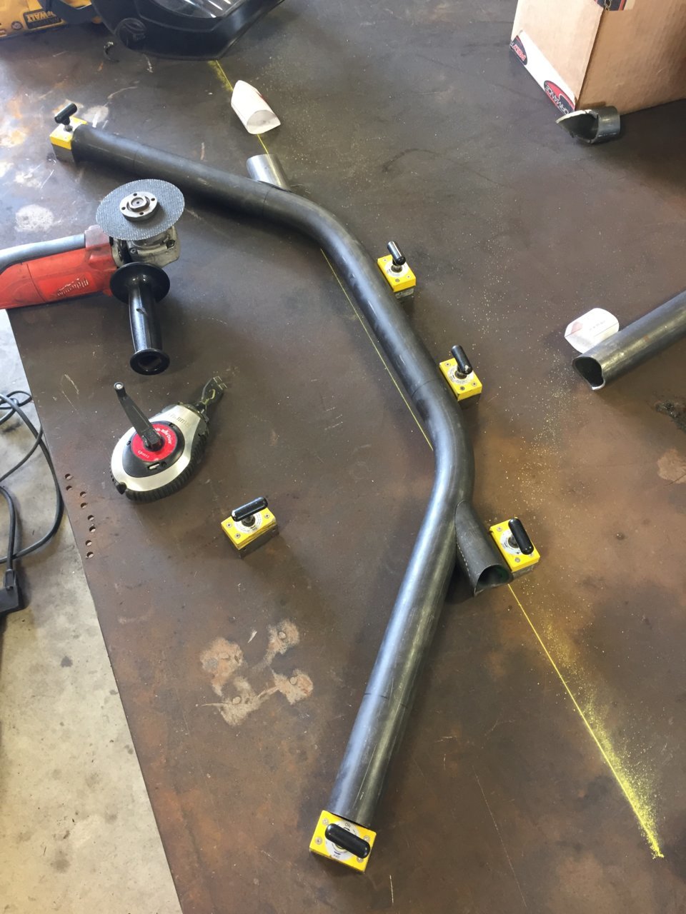

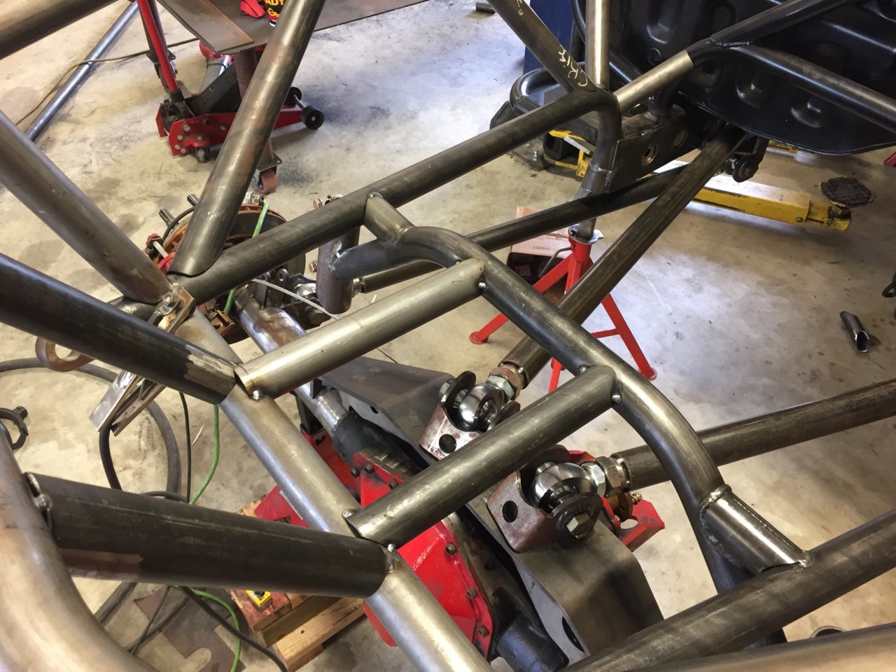

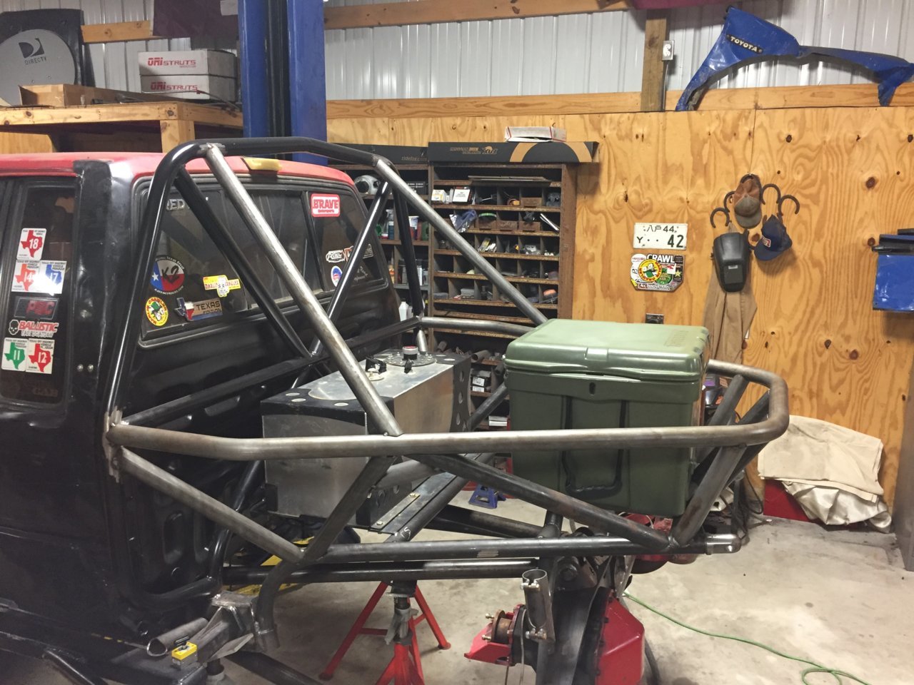

    We’re getting closer to welding her out.
    This cross member will brace the rear of the bed and support the air bumps Chris provided.

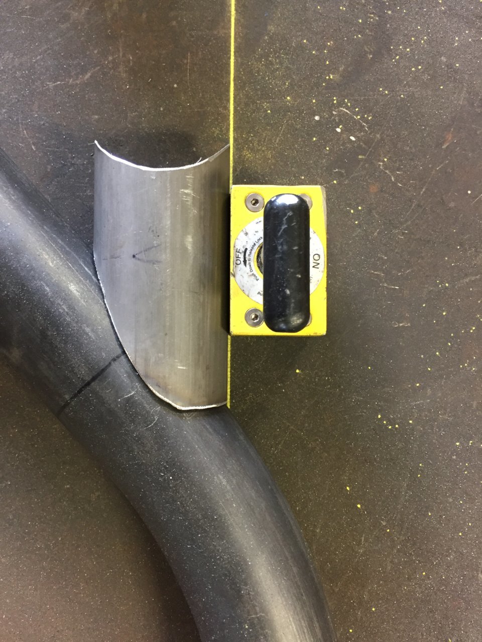

    You can get a pretty decent cope using a cutoff wheel and flapdisk.

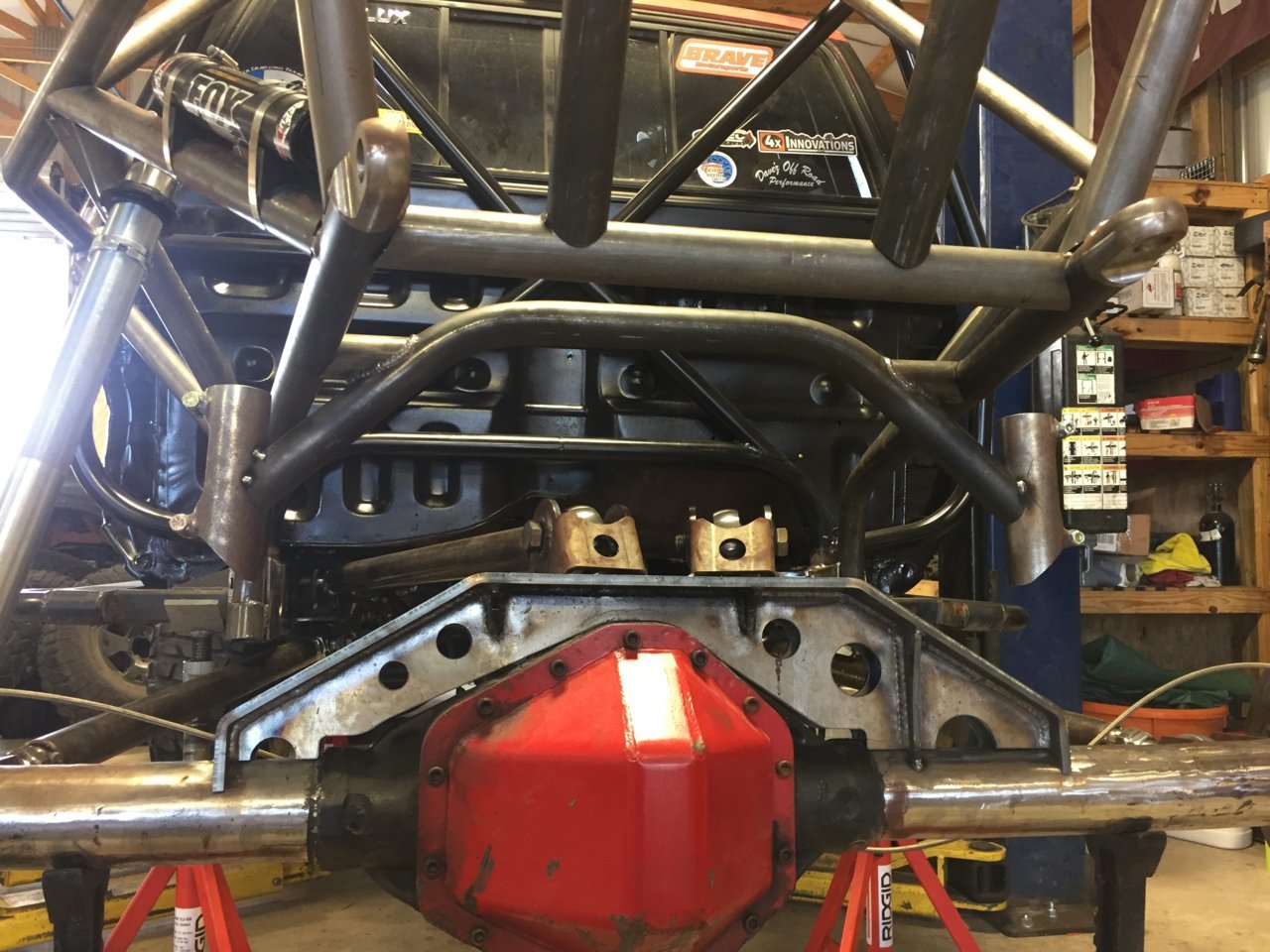

    Mostly finished bump can support. I have a few gusset plates drawn up to brace the cans will. I'll be cutting those on Sunday.

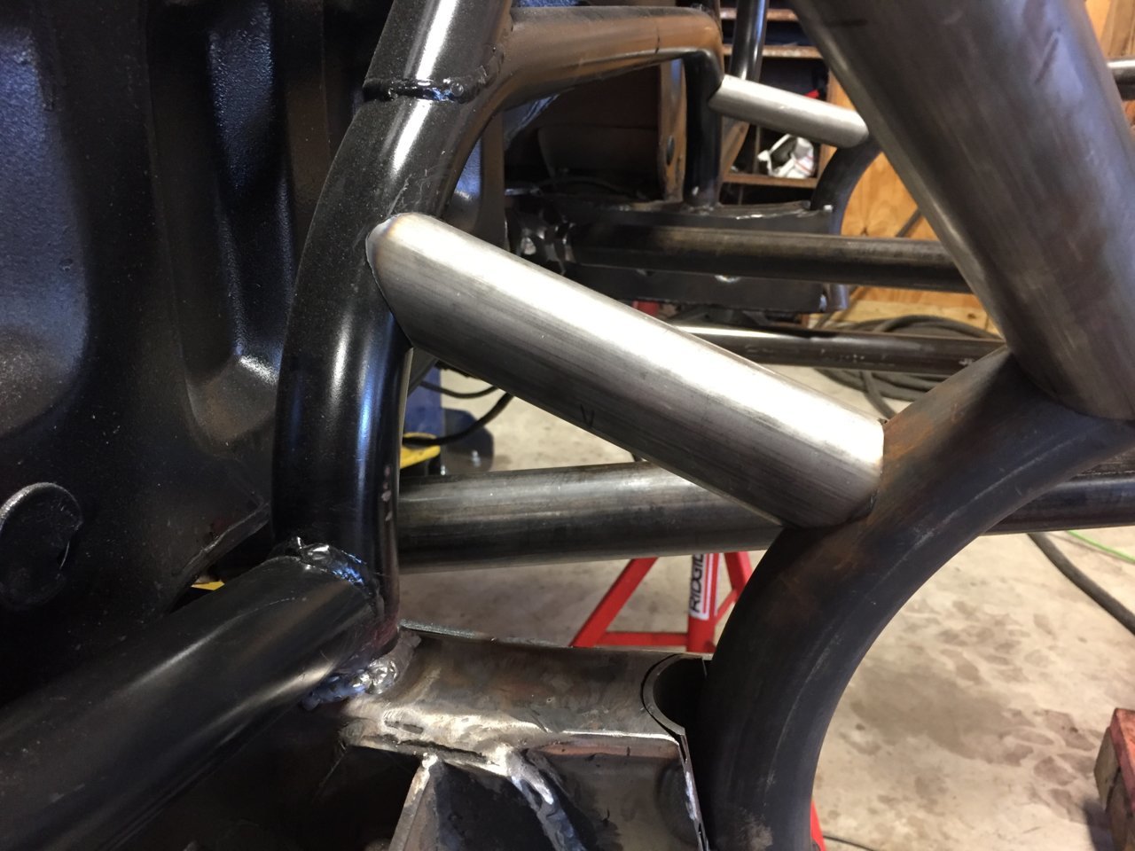

    Bracing the lower rail to the front hoop is definitely necessary. I'll be plating that gap in as well to build a nice hefty frame section.

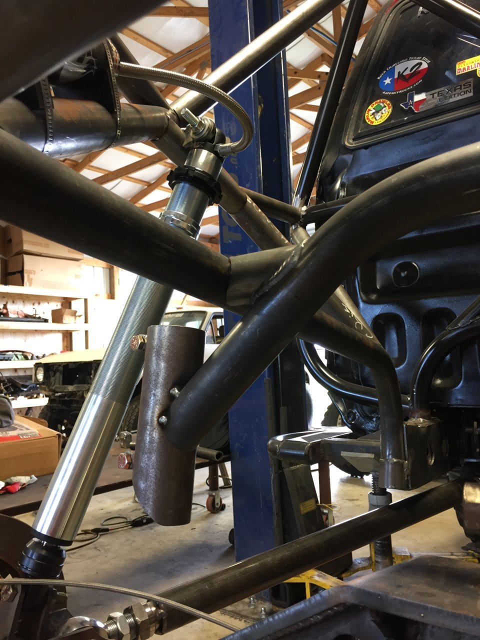

    Gotta hold up the cooler!

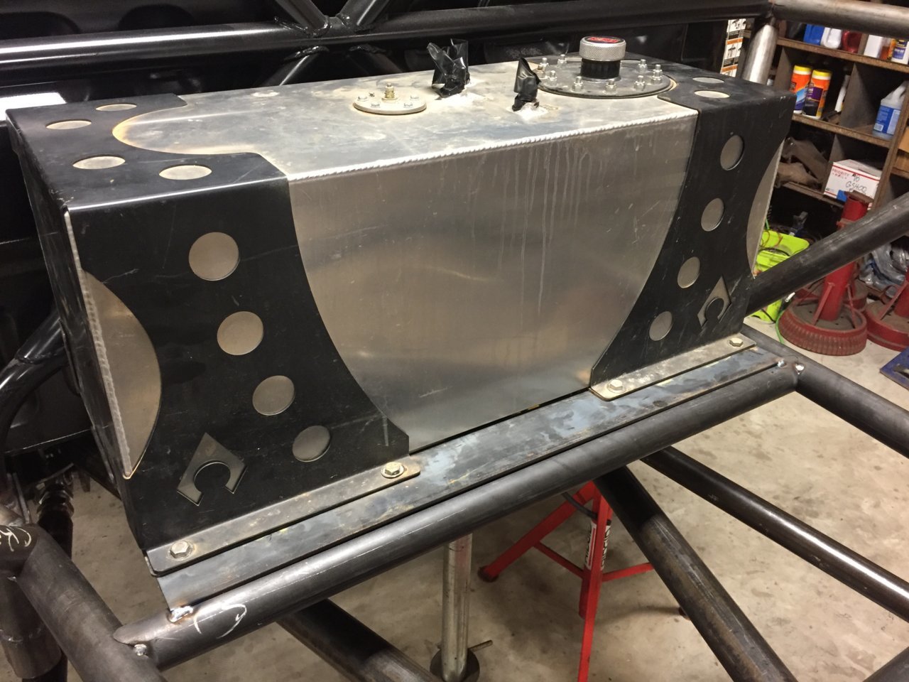

    The fuel cell mount is nearly complete as well. Just need a bit of bracing.
    Here's the overall shot as of tonight.

    The most important part of the build...
    The cooler mount.
