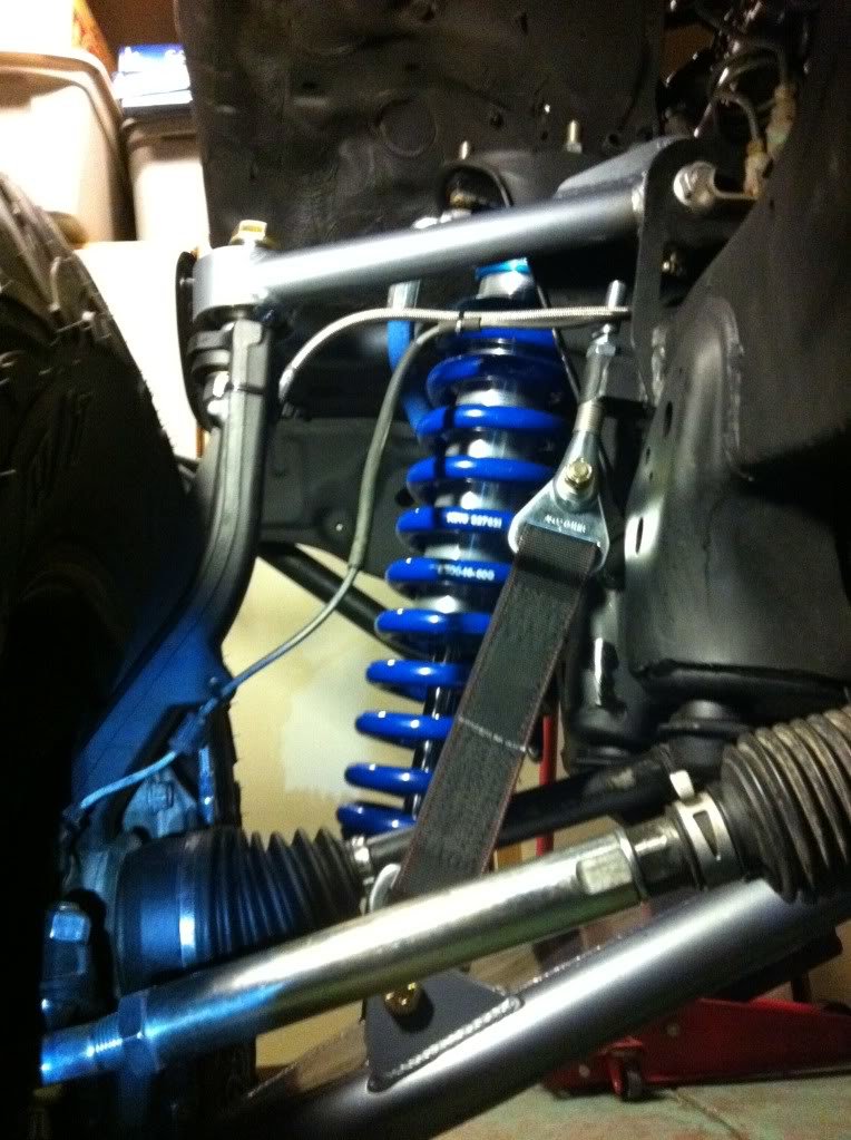

    ok so i know limit straps stretch and i had my installed with an 11" strap, the 11" strap is now 12" and is not preventing the shock to stop at full droop... so i measured eye to eye and look at everything
    i need my straps to be at 11.5" AFTER they stretch and everything...
    here is how i have them mounted

    double up the straps or re-do the mount and use a adjustible clevis and mount[​IMG]

    As a general rule of thumb straps will stretch an additional 10%.
    As everyone else said though, clevis makes for easy adjustment.

    You will probably need new straps. The clevis itself is pretty long and judging from the pic I don't think you have that much room so you'll need shorter straps.

    I have extended travel King OE replacements and at the current preload the uniball cup goes right in between the coils, but if adjusted would most likely hit the coil, so I will be strapping mine as well.
    Like Jason said, you have to account for stretch of about 10% and most use clevis' to mount to the frame but they are pricey

    yeah, i may go the alternitave as mastercraft makes custom length straps, so idd get 10.5 add 10% and you got 11.55" wich is perfect.... as long as its cheaper than new straps,clevis,mount,labor
