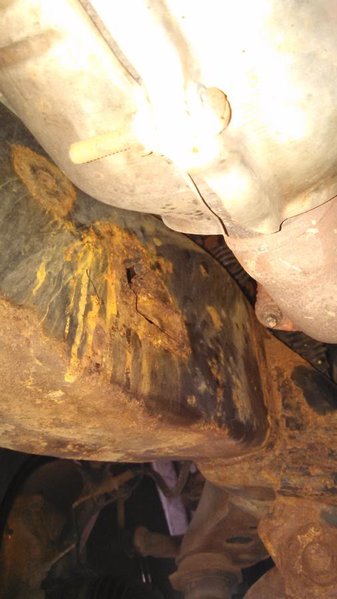

    Just noticed this today. Anyone know what the remedy is? I'll call my local dealer tomorrow.

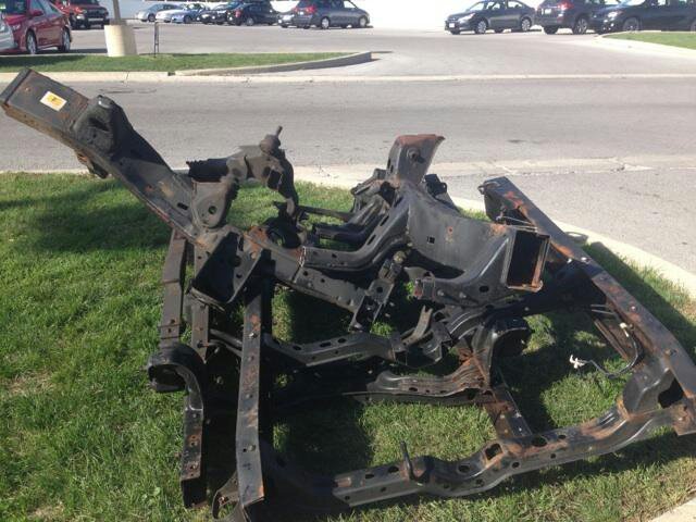

    I got the dreaded phone call this morning. I've got rust issues with my '07 and a new frame is needed. I'll be driving their loaner '14 Camry for the next 4-6 weeks.

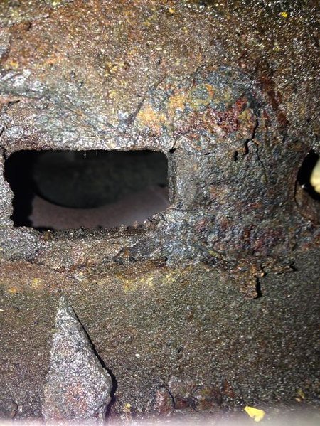

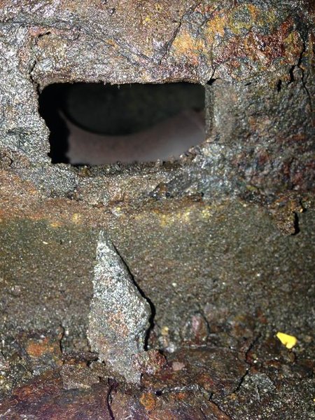

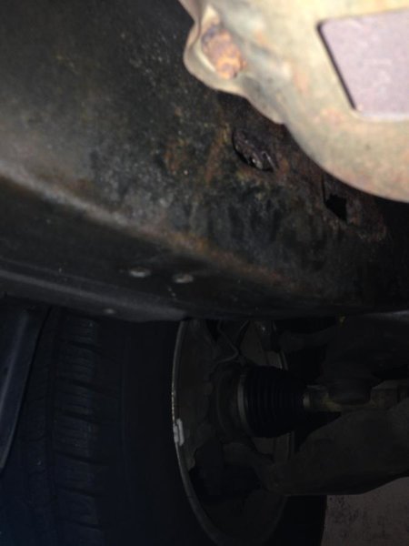

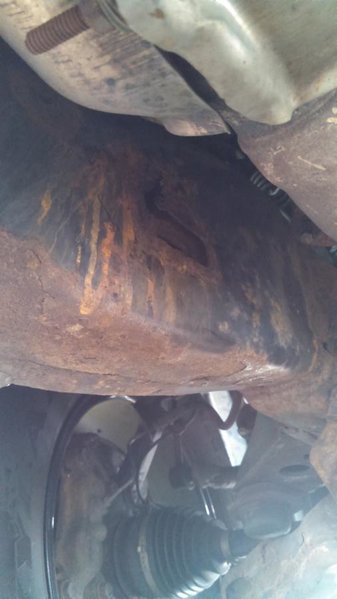

    Just got off the phone with the service department at Cain Toyota in Canton, OH- scheduled my inspection for this Friday at 3pm. I was told that if there are any holes over 10mm, they will order a replacement frame. Under 10mm and they just put the CRC on it. I have no clue how they came up with that number, but I feel as if a hole is a hole and structural integrity has to be on the outs if there is one present. Here are the pictures of mine- another victim by the driver's side cat...

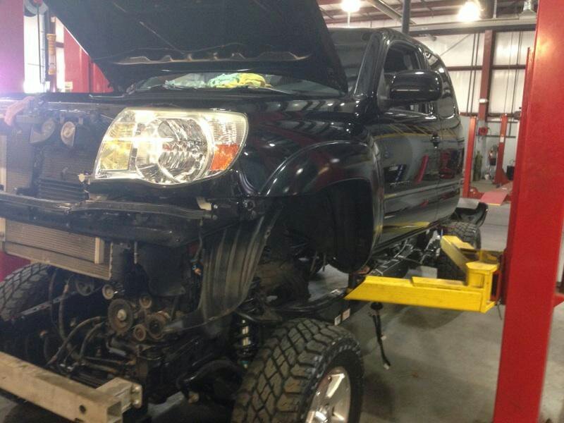

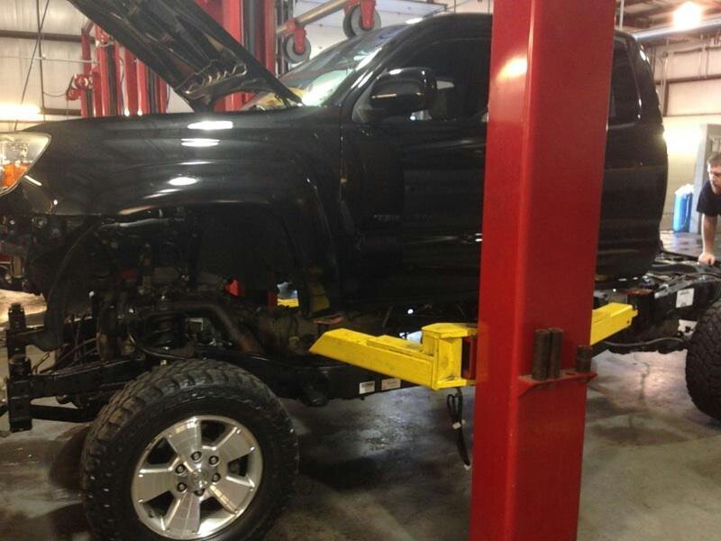

    Nothing wrong with mine since getting the new frame, body was fine, I made sure to go over it with the tech and service guy, and let them know that there are no major scratches or other issues with it, I gotta take it back in next Monday, think a heat shield or something's loose and rattles when Im in drive with the brake on at stop lights... Nothing major... Just annoying...other than that it was a pretty good experience...

    My local Toyota shop called last week to advise me of the service campaign for the frame, and I have an appointment tomorrow to have my 2005 Tacoma Access Cab TRD O/R inspected.

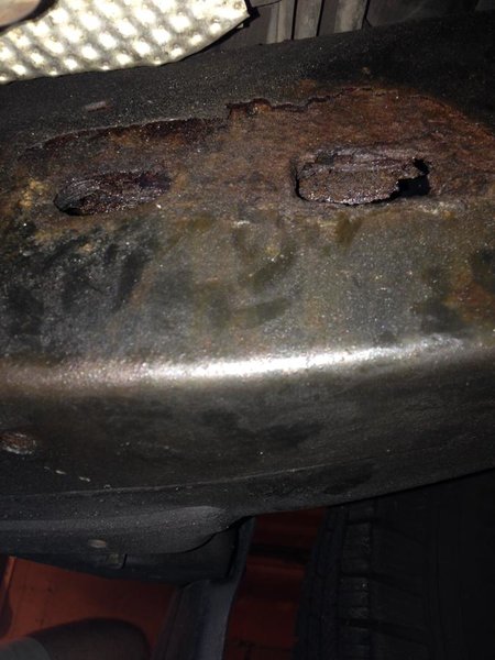

    Based on all of the reading I have done on TW and elsewhere, I think my frame is probably (hopefully?) a candidate for replacement. Like many others, I have a hole on the driver's side, inside face of the frame near the cat. The hole measures about 30 mm wide and 20 mm tall. The metal on the inside of the frame at that location crumbles to the touch.
