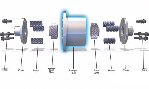

    Thats why i mention the detroit true trac, no limited slip clutches to replace

    it works by using internal worm gears to create friction between the three worm gears and the side gear. Once there is enough friction, IE one free spinning wheel, it takes little more than one rotation to transfer power to the opposing wheel pct_470927.jpg

    its an extremely simple, yet elegant mechanical solution to the issue
