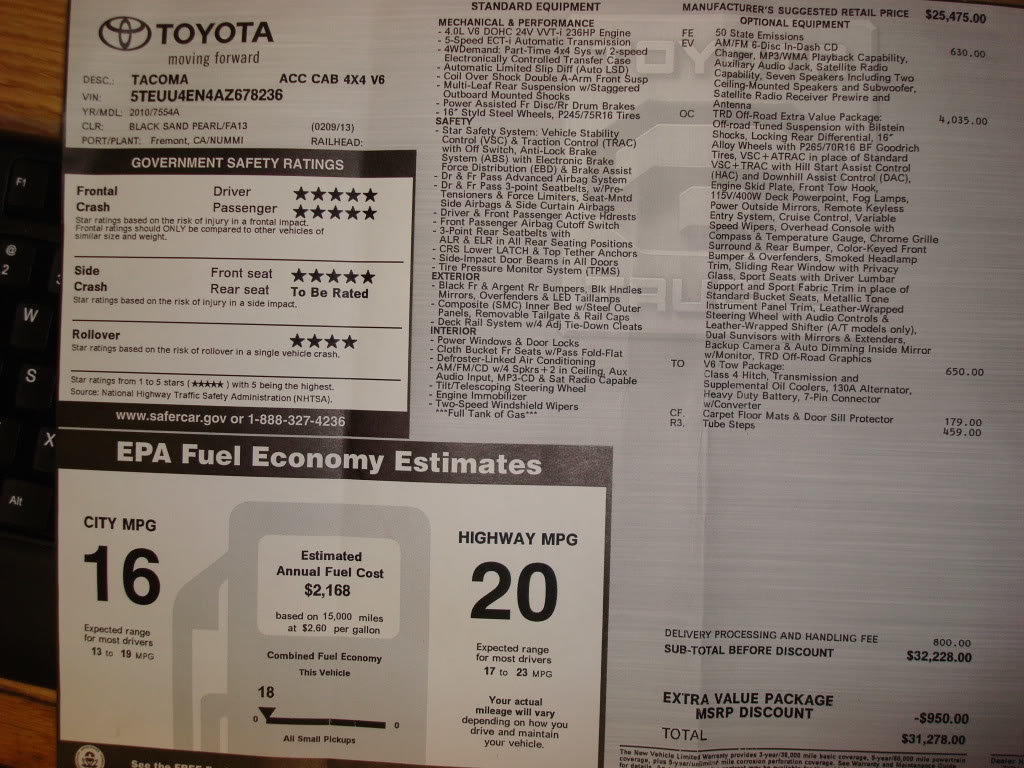

    Look at the list, explains what u get Extra with TRD OFF ROAD.
  14. Oct 6, 2009 at 11:19 AM
    #34
    lightfire
    lightfire Well-Known Member
    Oct 5, 2009
    #23808
    213
    So what is the difference between VSC with ATRAC and VSC with Trac as listed in the sticker above?
    If a person wants for winter driving on pavement it sounds like the LSD on the sport package is best. Or no?

    wow 32 k thats not alot here its 45k double cab long beb trd sport

    This is a 4 + year old thread guys!
    Since the 2009 model: All Tacomas have VSC, TRAC limited slip, and no more mechanical limited slip differentials.
    Only the Off Road TRD has a locking rear differential and A-TRAC (front and rear near locker-like traction control).
