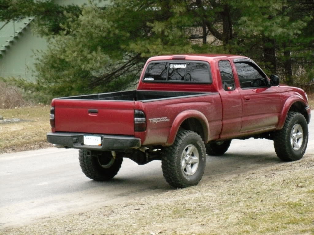

    here you go. sorry for the old picture. earlier this year, in january, i put bed liner on my chrome rear bumper. i love it, and when it comes time to clean the truck. any type of TIRE shine- gel/foam will make it glossy and shiny again.

    Looks good but like you said not the best pic. I'm interested too to know how you prepped bumper
