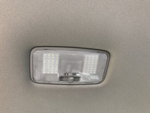

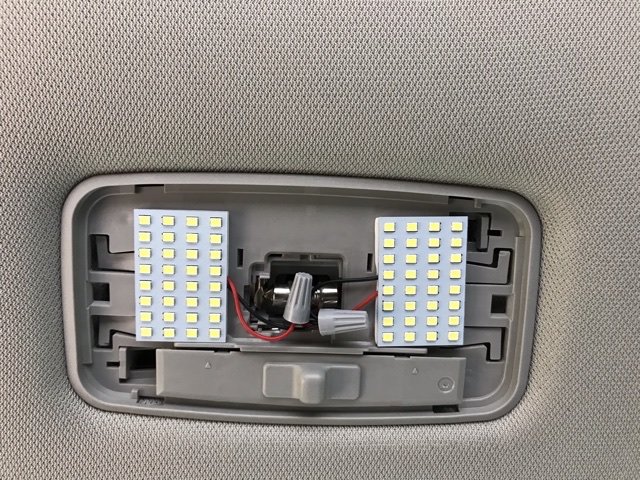

    That looks like what I want. So you just 3m the panel inside the dome light cover ?

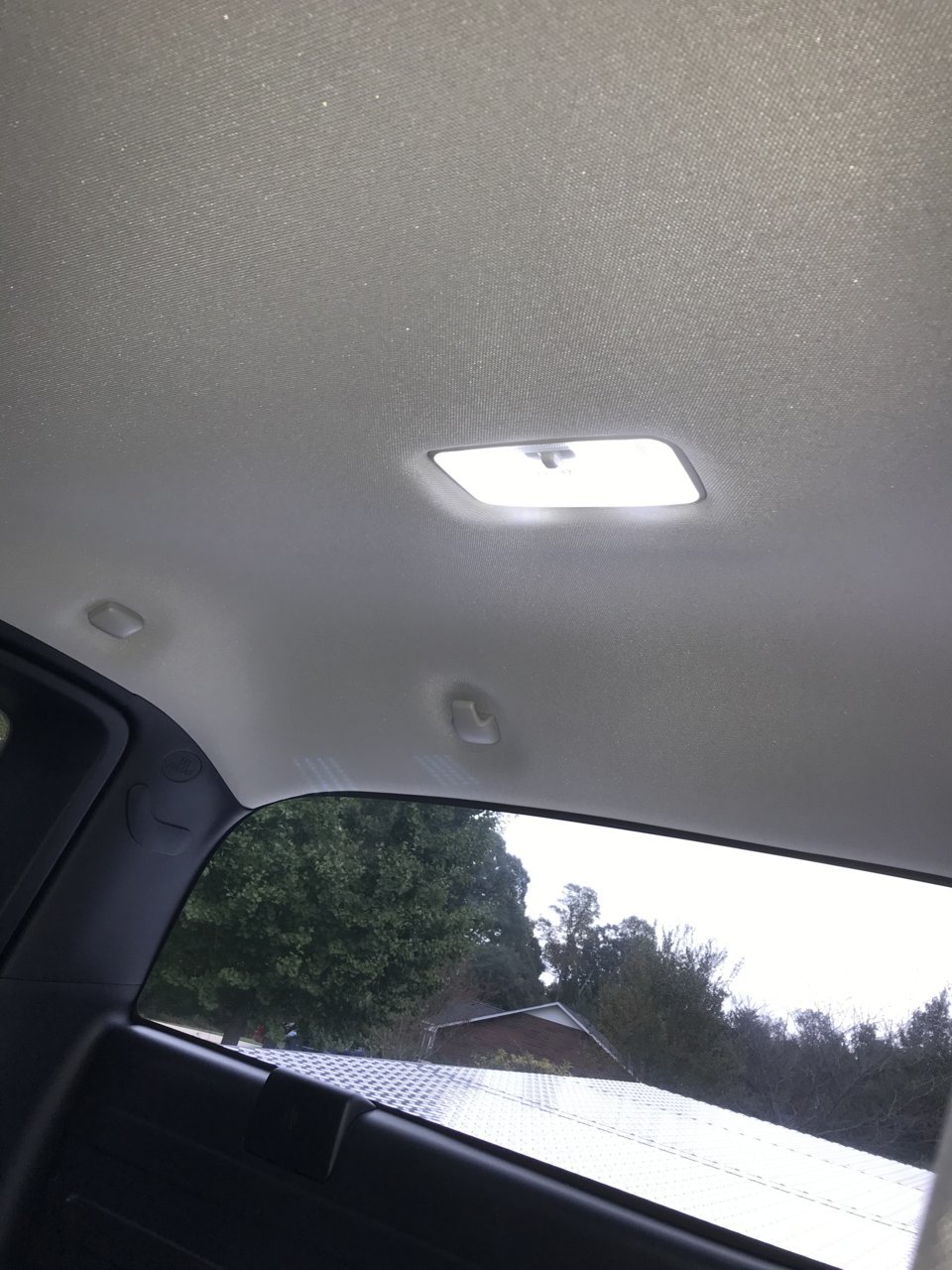

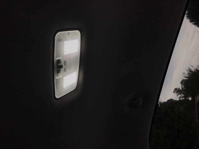

    Yes they come with the 3m tape already on the panels. Hardest part is getting the festoon “bulb” connector in. 12V is always at the terminal even with switch off so need to disconnect battery negative terminal to avoid accidentally shorting. I plan on doing an install post maybe next Sunday if I have time.
    1028F42B-A25C-4B21-A2F3-150A46EED6E8.jpg 6A1A52B0-222D-40DE-A3F8-539BD994416F.jpg
    Underexposed to show the LEDs:
