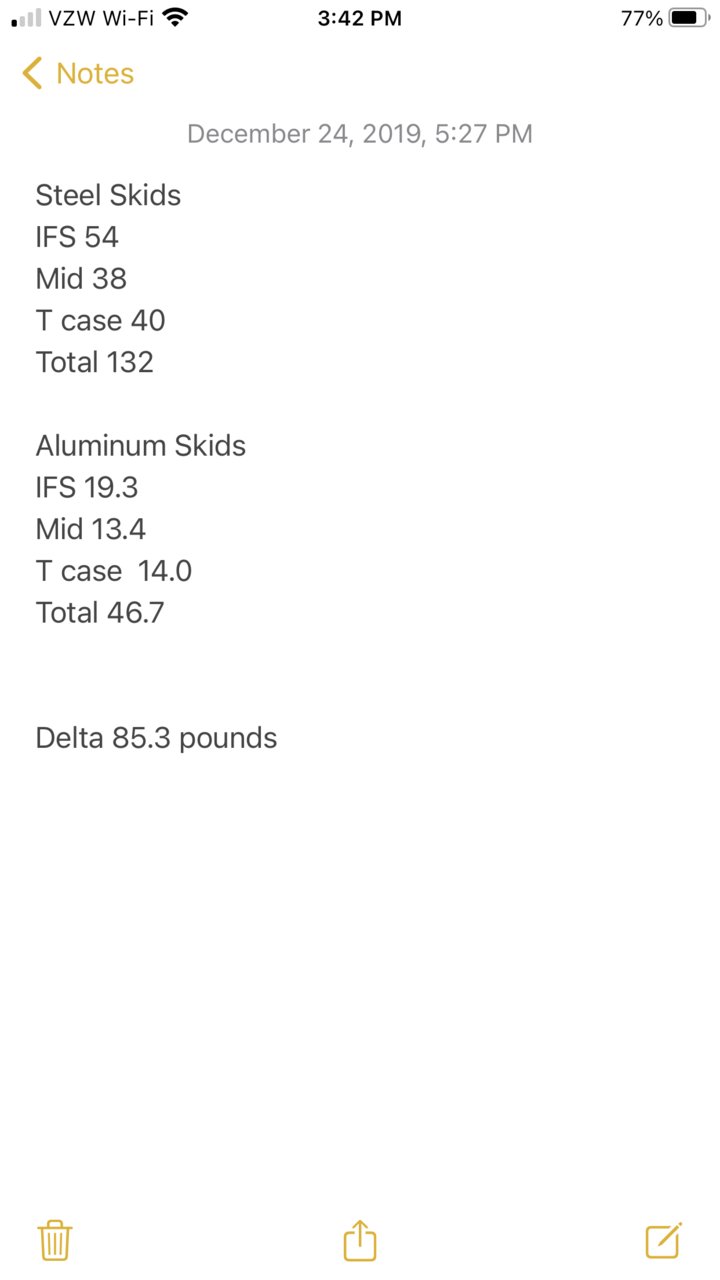

    SOS Offroad
    Full skids - 132 (steel) 47lbs (aluminum)
    IFS - 54lbs (steel), 19lbs (aluminum)
    Mid - 38lbs (steel), 14lbs (aluminum)
    T-Case -40lbs (steel), 14lbs (aluminum)

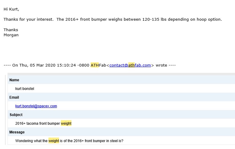

    ATH
    Front
    Steel front bumper 120 - 135 (depends on hoop config)
    Rear
    2nd gen standard rear bumper = 85lbs (according to the UPS sticker that is on mine, of course this is before paint)

    SOS Offroad, Steel and Aluminum. These are what I weighed them at before install. Ran steel for a while then swapped to aluminum.

    ATH steel front bumper:
