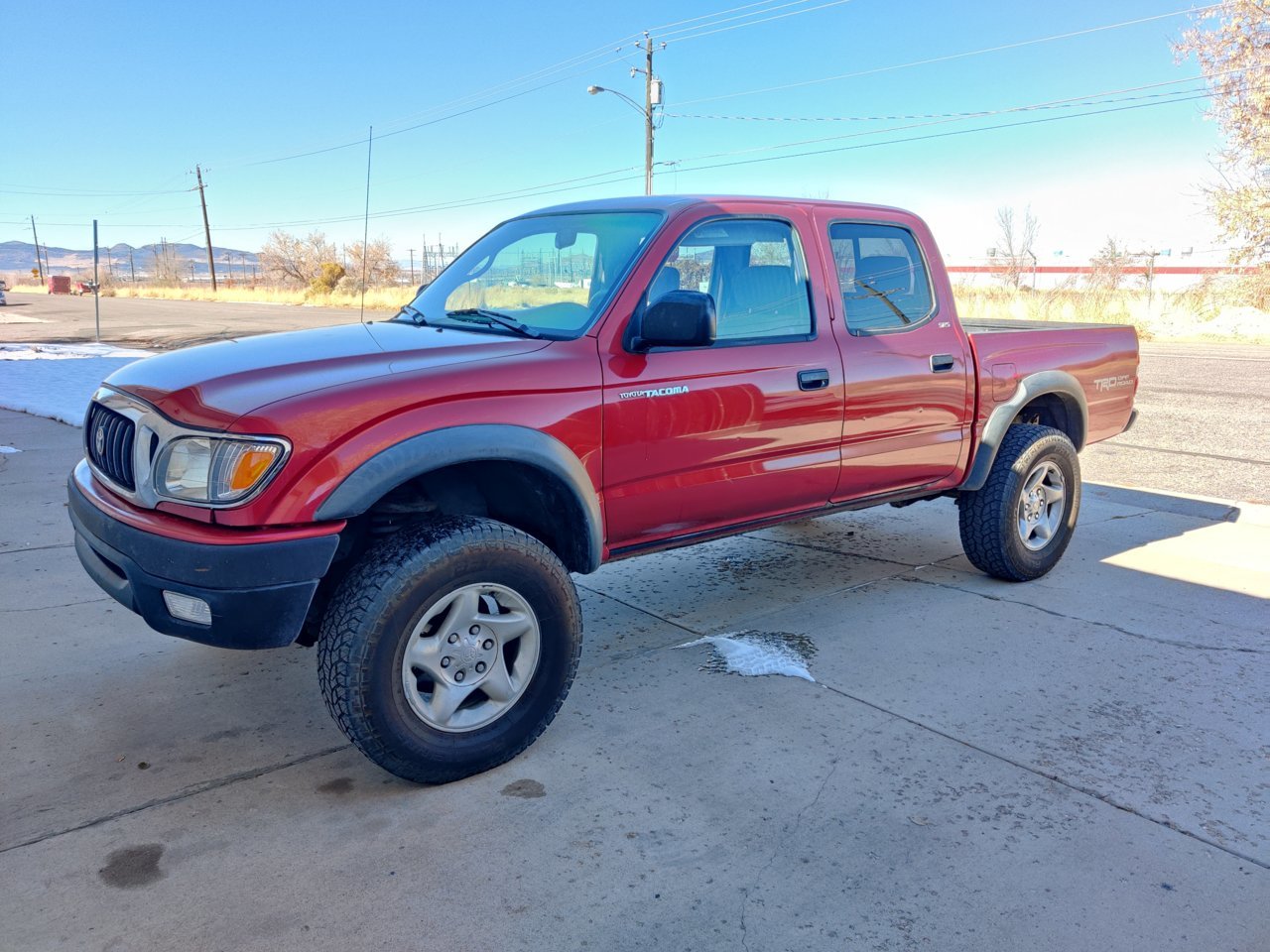

    Well I've been creeping around here since 2011 and have gone through 4 different Tacomas without creating a build thread so it's time I sat down and made one.

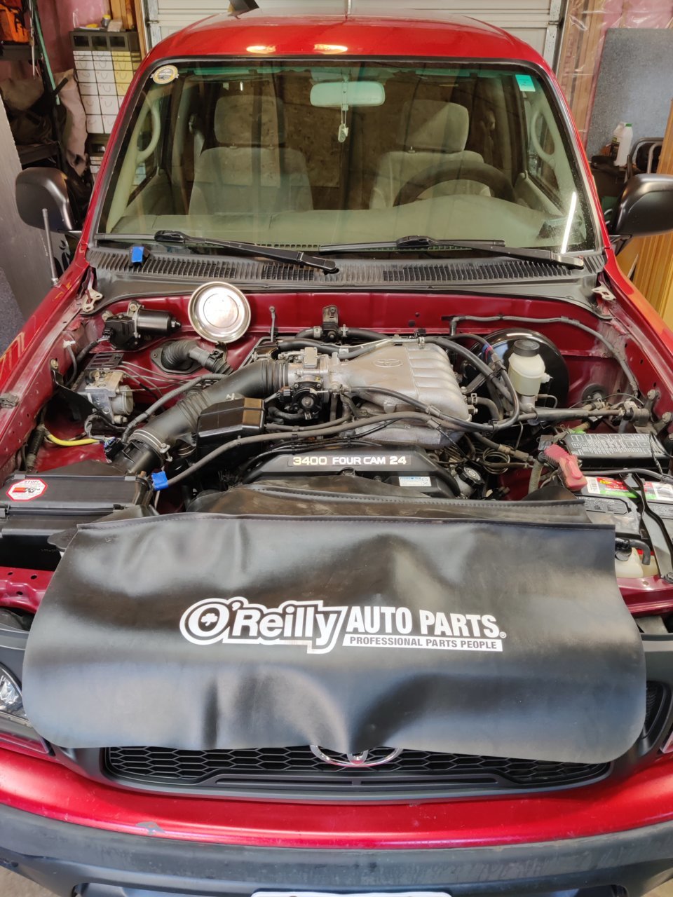

    Here's where I am today
    And here's where it all started

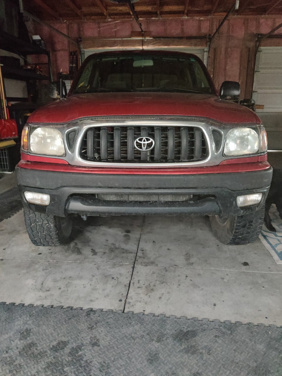

    Right, back to 1st gen things. On veterans day of 2020 I got a bunch of ducks to line up and was able to purchase my current tacoma outright.
    no monthly car payment = more money for car parts every month and I now have a 30x30ft garage attached to my house so the tools are secure where they belong and the work can begin.

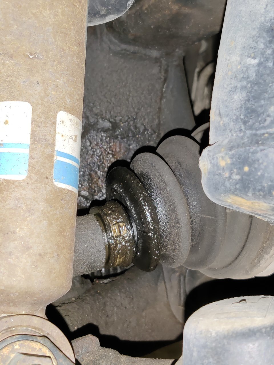

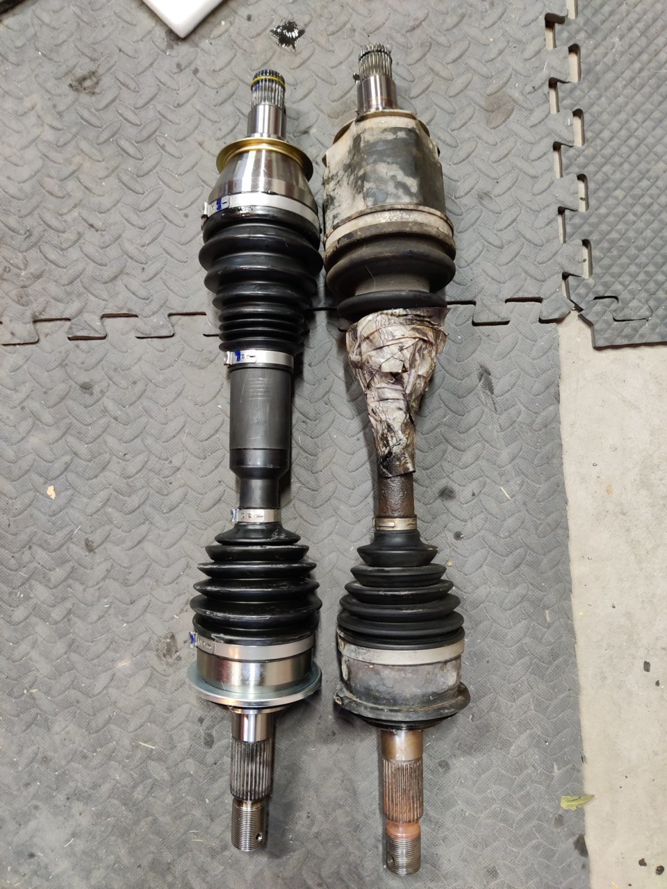

    I picked this truck up with 314,000 miles on the dash and not much to go on as far as service history. I think I'm either the 3rd or 4th owner but who really knows.
    First time I crawled underneath I realized both CV axles had torn boots. Lifted it up spun the tires and you can hear the CV's clicking so I went to O'Reillys and special ordered the Import Direct CV's designed for 0-2 lift. I also went ahead with more bad ideas and threw them oem green sticker CV's right in the garbage.
    I guess I have to consider changing my CV's and dif fluid alone in my garage as my Bachelors part. You know it was a party because I gave myself a little bit of a black eye the night before I got married

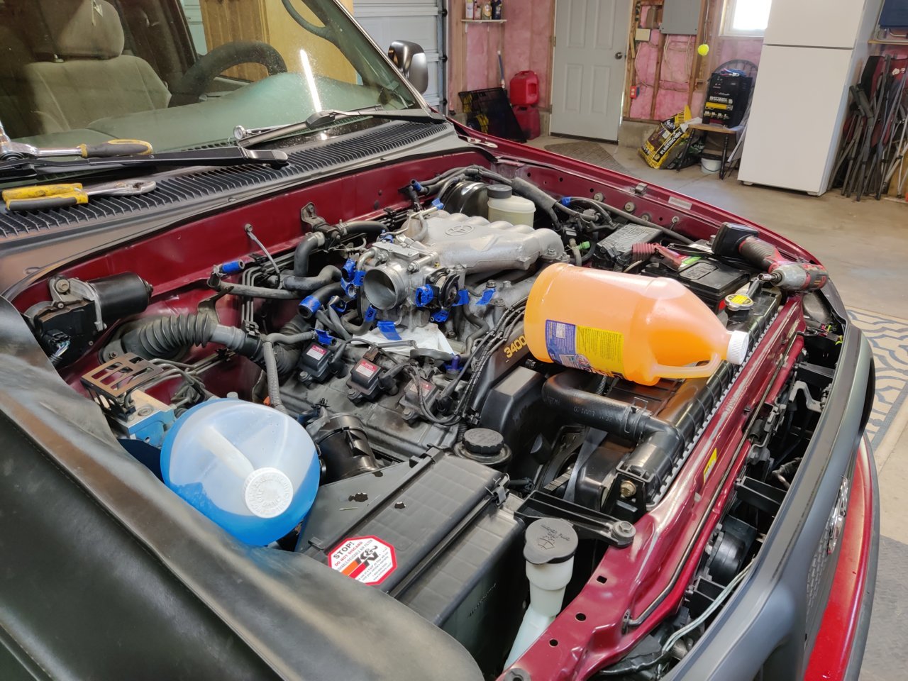

    The next thing on my list for the 03 taco was to change the fluids.
    I sinfully drive it to Jiffy-Lube and had them flush the coolant,
    flushed the transmission and replaced the screen/filter and seal.
    Flushed the brake fluid and change the axle and transfer case fluids and greased all 100,000 drive line zerts although I'm sure they missed a few. All fluids changed except the power steering :spending:

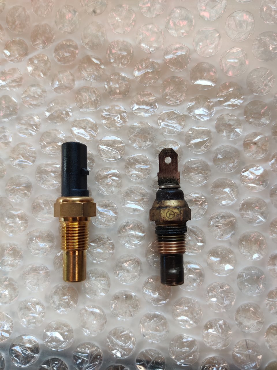

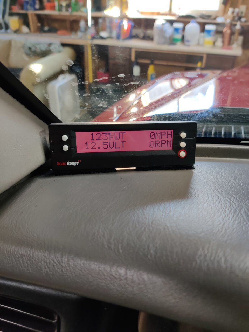

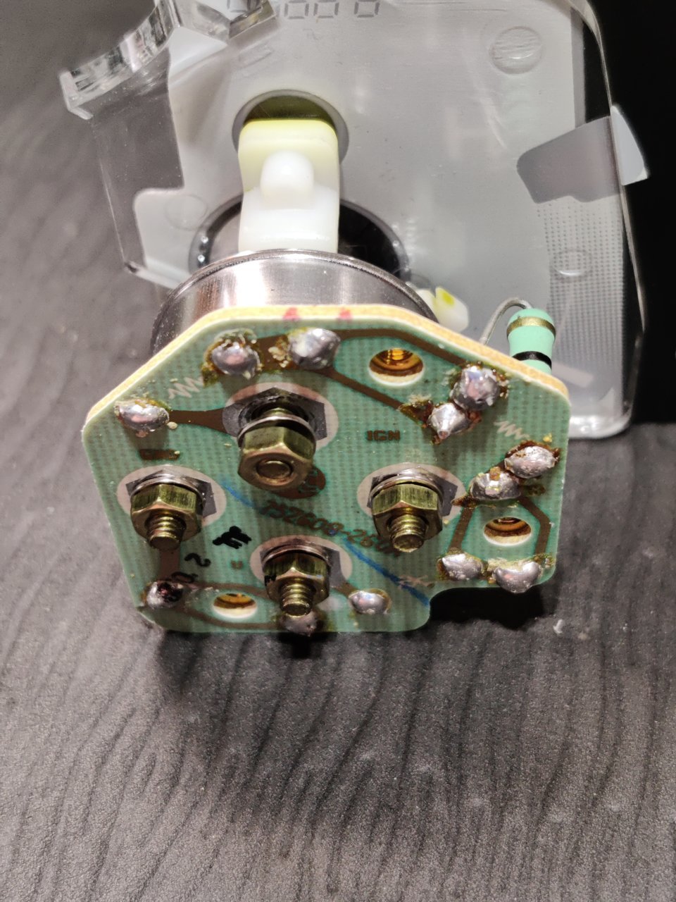

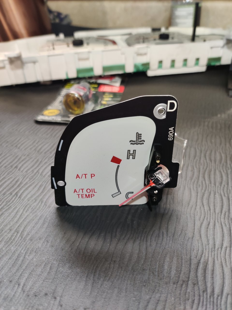

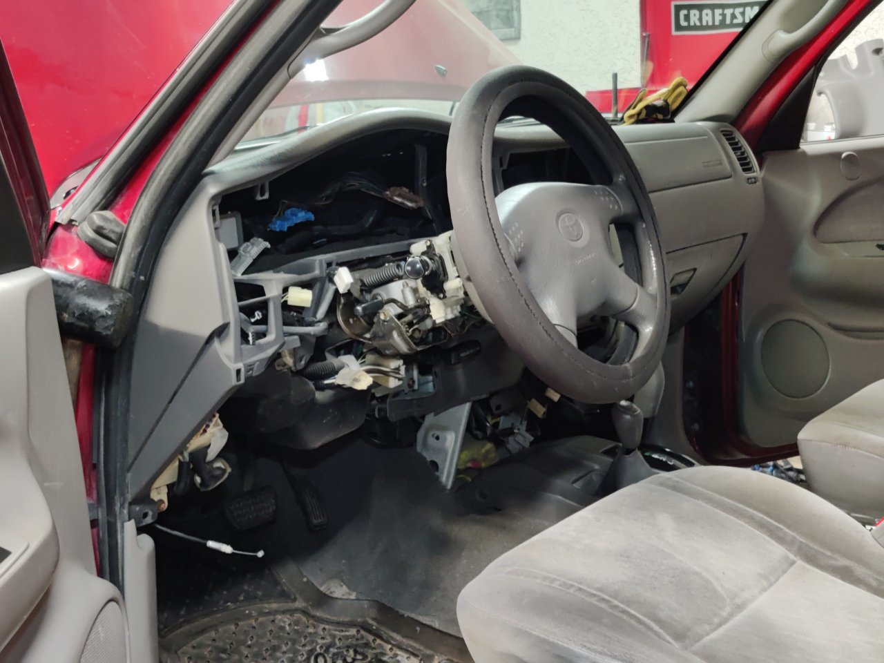

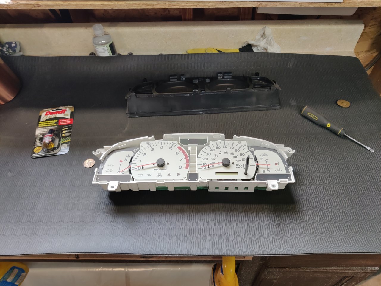

    Did I mention the temp gauge on the dash wasn't functioning? Well it wasn't so I ordered a Scan Guage II as a short term easy solution.
    Did some looking around and thought it would be worth replacing the rear temperature sensor
    I should also mention it definitely over tightened that sensor when I installed it just expecting it to thread completely in oops, but it's not leaking and hasn't come loose yet.
    :anonymous::fingerscrossed:
    So my focus shifted to the cluster itself
    Bingo! The nuts holding the gauge had vibrated loose making connections fail
    Much longer and that top nut would have been history in the bottom of a shop vac
    I followed 4DIYers on YouTube for this project down to the DeOxit
    https://youtu.be/VVJSwEakRto
    This came as a little victory, such a simple fix that cost nothing but the extra I went by adding DeOxit I thought it might help act as a thread locker at the very least to prevent it from happening again.
    I hardly look at the guage as I use the Scan Guage instead but that's one less thing wrong with the vehicle.

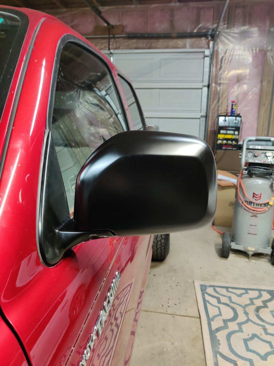

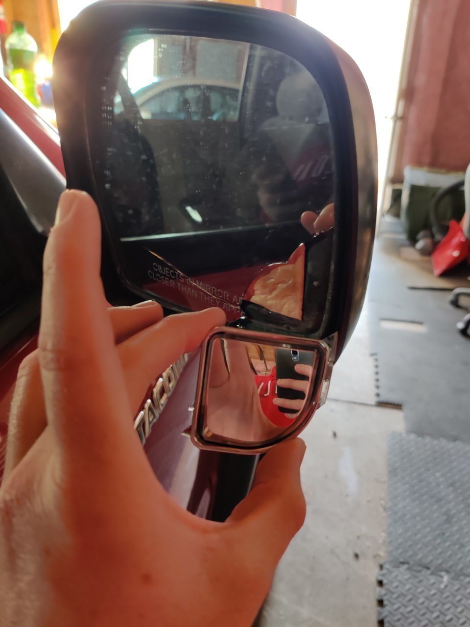

    Did I mention I broke my passenger side mirror trying to remove a sticky taped corner mirror that wasn't straight.

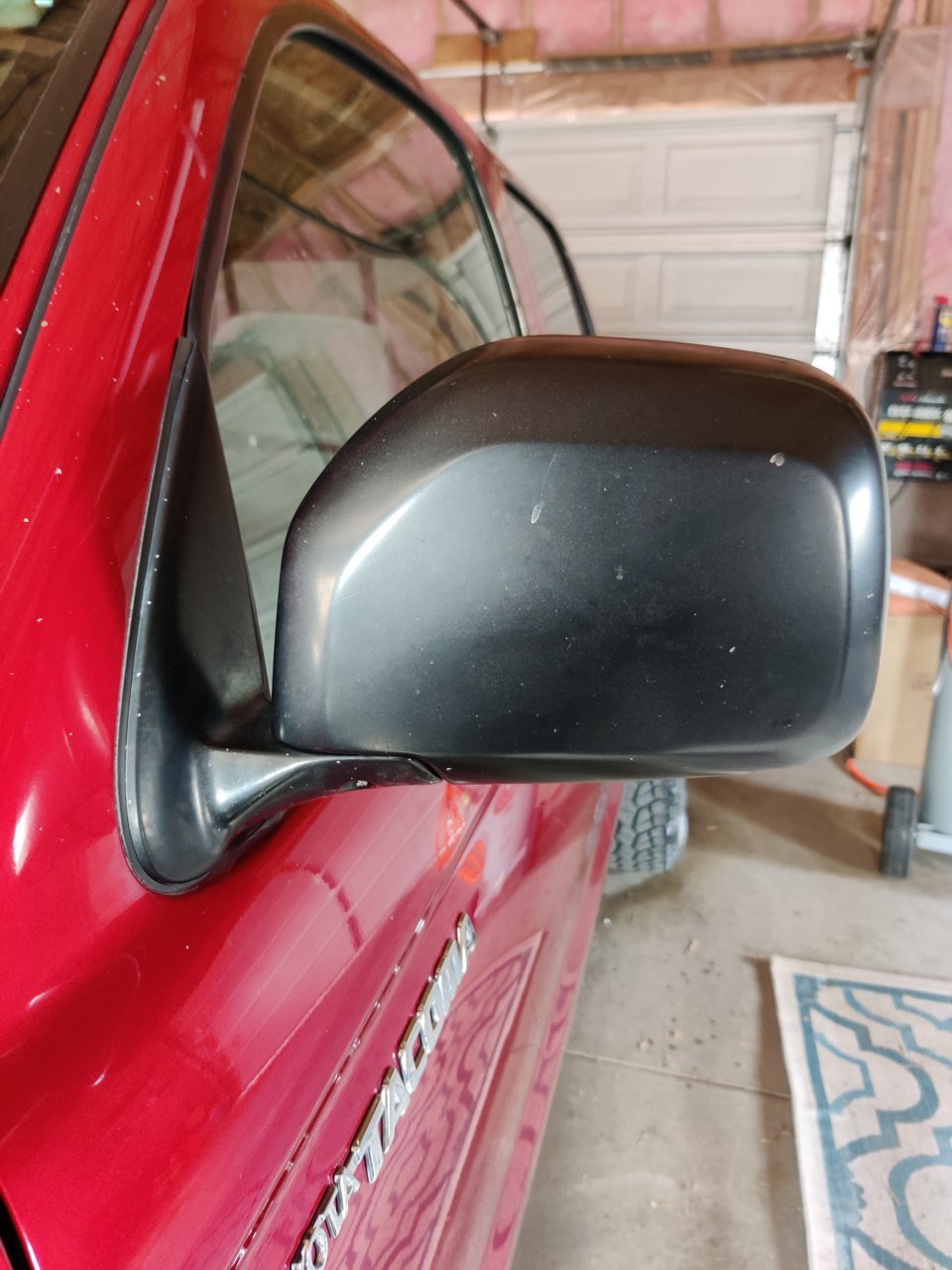

    I broke the passenger side mirror and the drivers side mirror was somehow a little warped so reflections were wonky and made my head hurt so I replaced them both at the same time

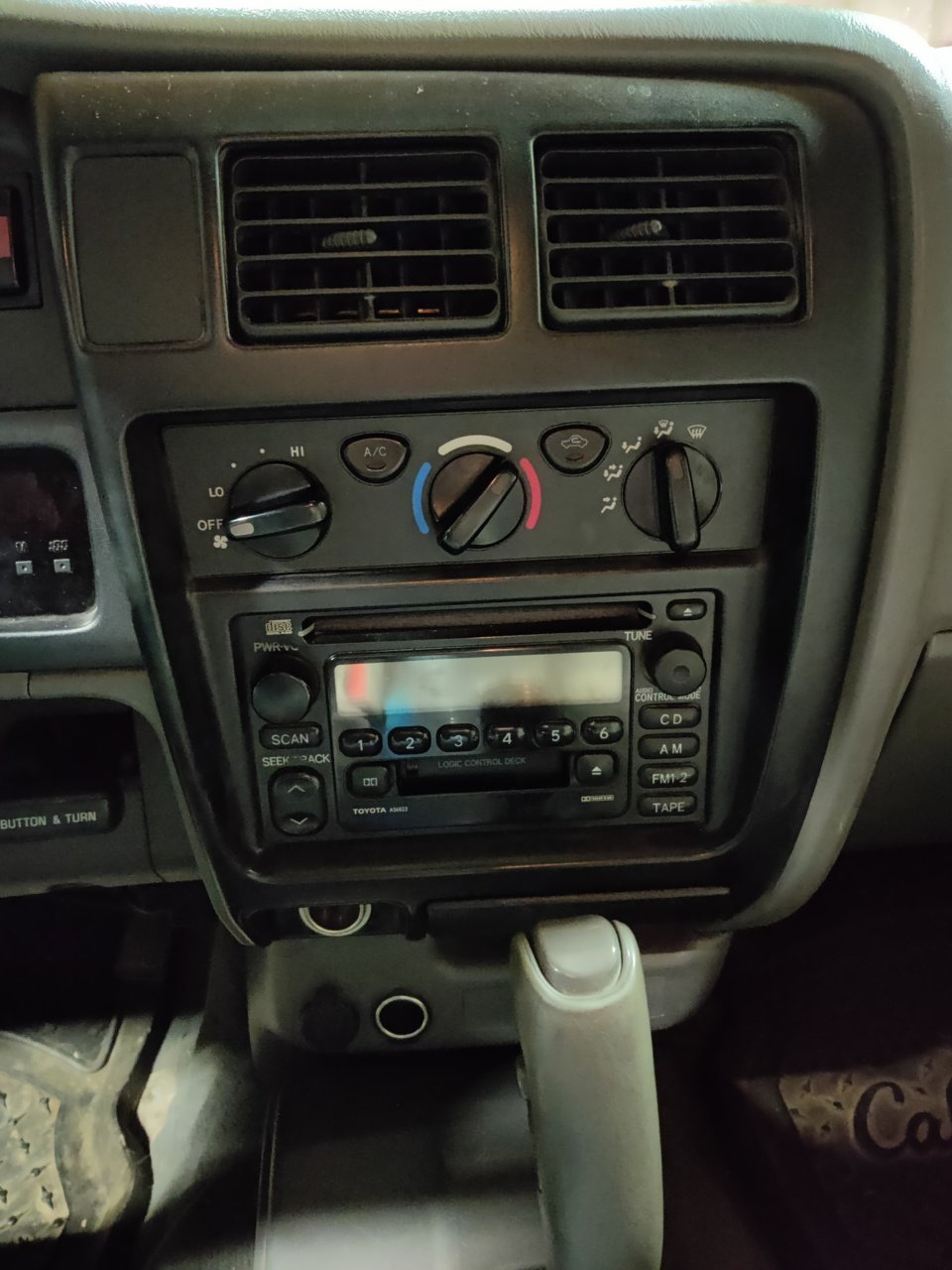

    Next up bluetooth stereo
    Because i only own one cassette and don't feel like flipping it back and forth IMG_20210116_215318.jpg

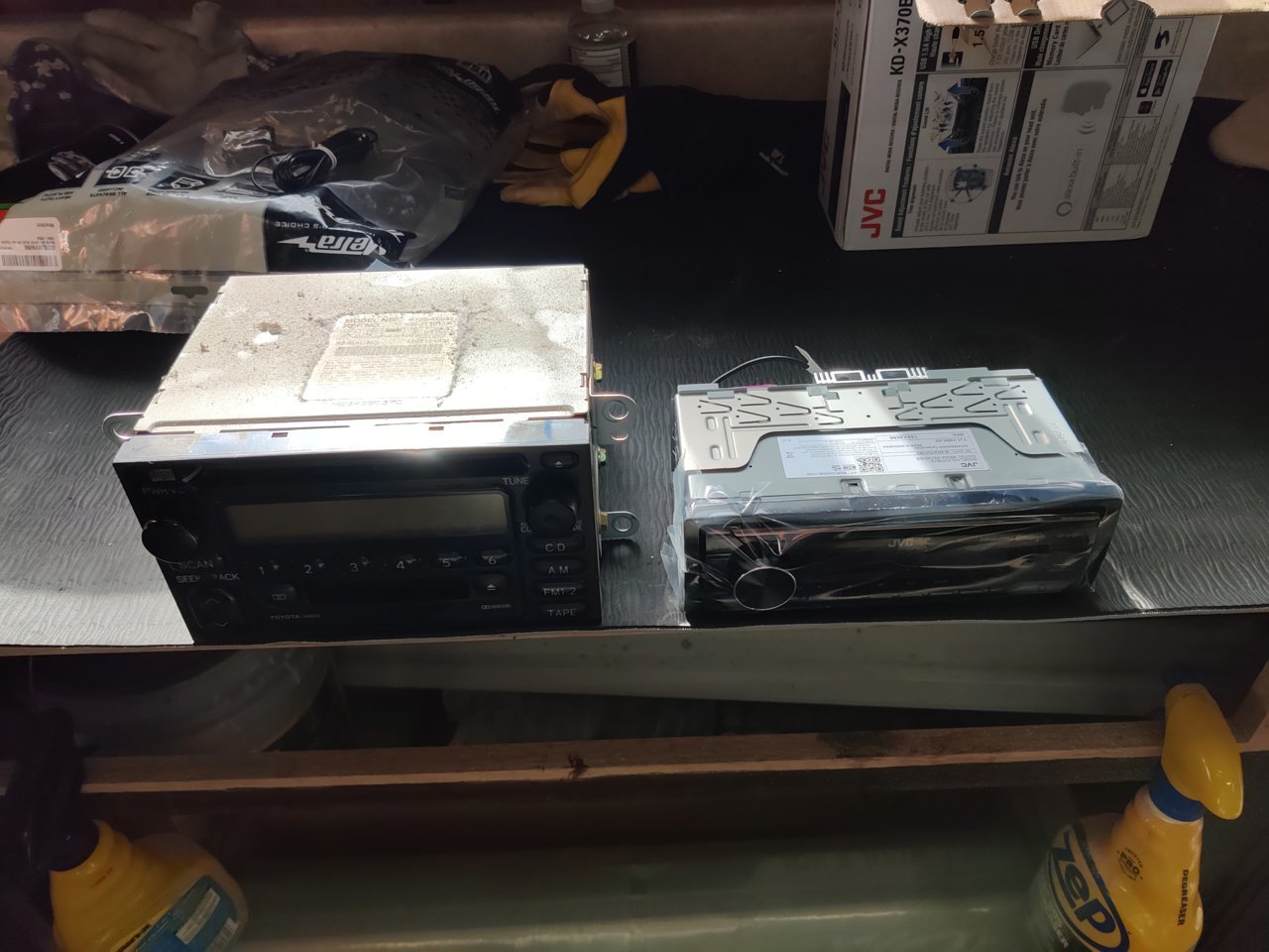

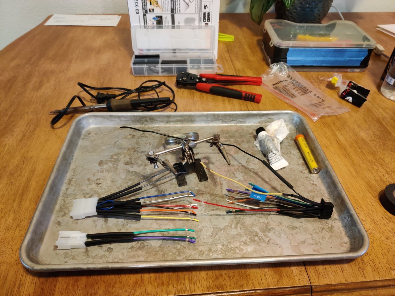

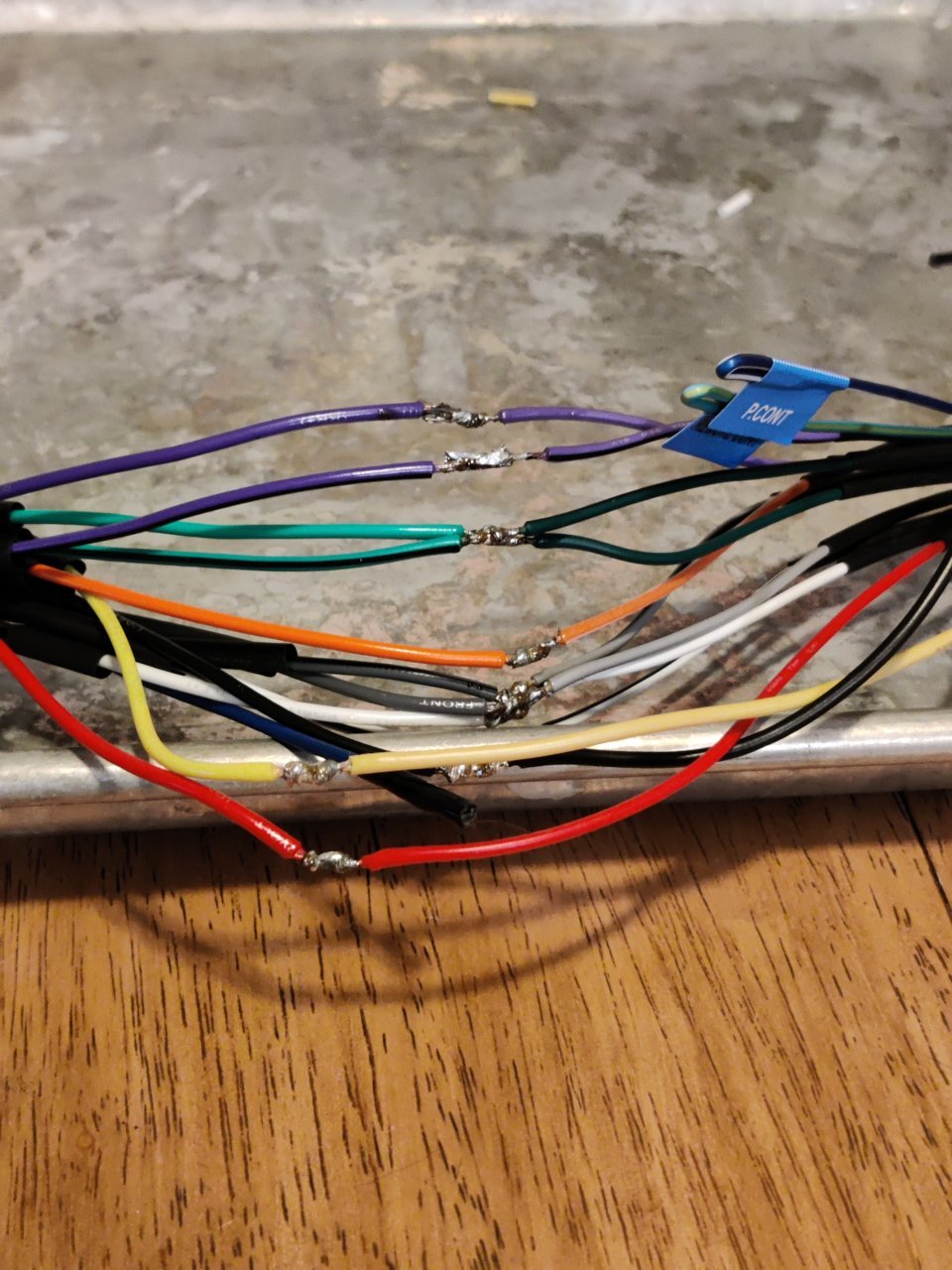

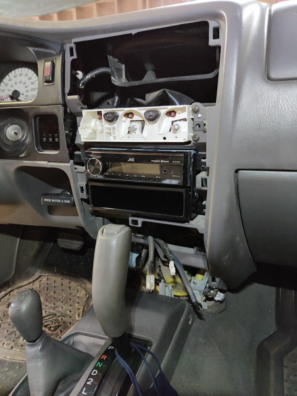

    Removing the big ol' double din stereo is an obvious choice for adding a little storage space to the cab. It's a must in my book and always among the first things I do to any vehicle I own
    It's probably enough weight reduction to save 3 miles per gallon. I'm a fan of the ultra small stereos that don't even have a CD player because let's face it CD's are as terrible as cassette tapes.
    I've done a handful of stereos over the years and this is my favorite part.

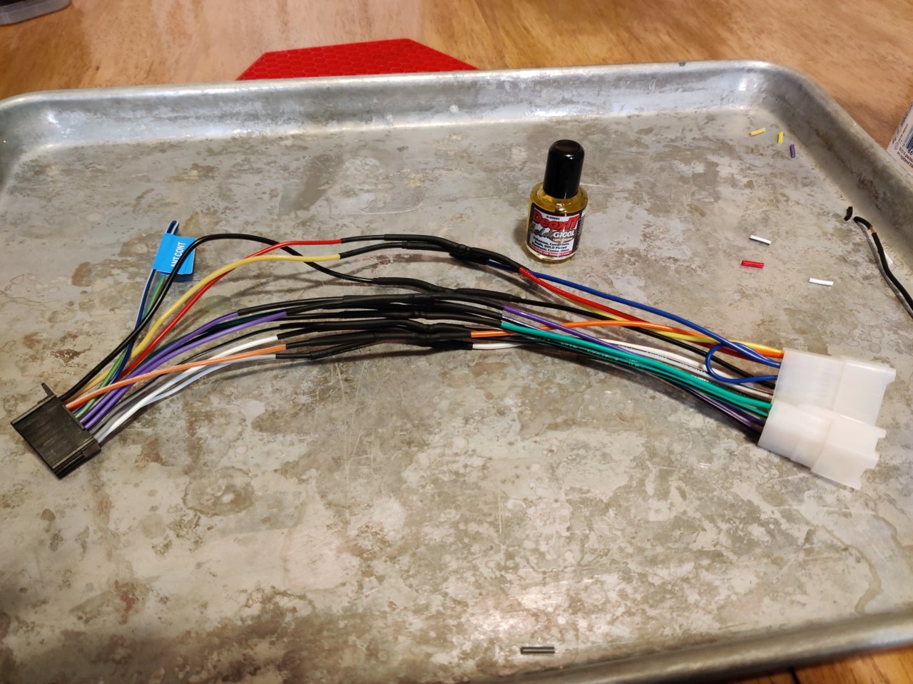

    I like soldering connections
    I can't stand a rats nest of wires and have always found it well worth the extra $15 to buy the correct wiring harness adapters

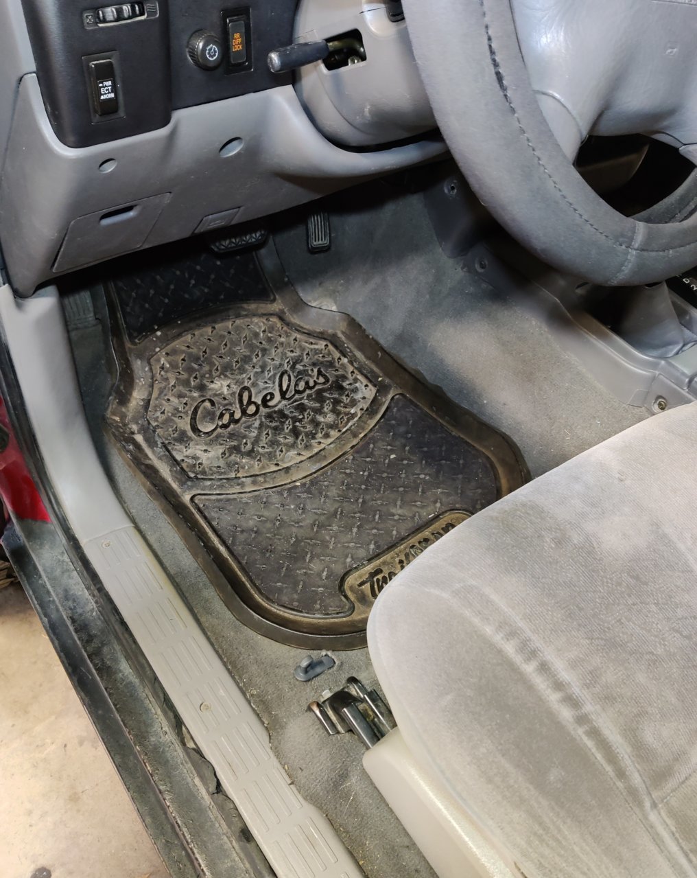

    These floor mats are terrible
  6. Jan 10, 2022 at 3:58 PM
    unstpible
    unstpible [OP] Well-Known Member
    Aug 16, 2012
    #84909
    3,870
    Derek
    Cedar City, Utah
    03 4x4 boosted V6 Auto 341k miles
    CX Racing Turbo kit. TransGo shift kit. All Pro Apex bumper and skids. Smittybilt XRC 9.5 winch. All Pro Upper control arm's. Bilstein 6112's with 600lb coils. Eimkeith's lower control arm reinforcement plates. Perry Parts bump stops. All Pro spindle gussets and alignment cam tabs. All Pro standard 3" leaf springs. Bilstein 5125's rear. Extended rear brake lines. Rear diff breather relocation. MagnaFlow catback with resonator. Bluetooth stereo. Memphis 6x9 door speakers. Diode Dynamics SS3 Pro Amber fog lights. Single piece headlights. aftermarket grille. Anzo taillights. LED 3rd brake light. 4runner sunglass holder and dome lights. Master Tailgaters rear view mirror with 3 directional cameras, G shock sensors, and anti theft system. Honda windshield washer nozzles. Stubby antenna. Scan Guage II. 2nd Gen Snowflake wheels powder coated black. Cooper Discoverer ST Maxx 235-75/16 Denso 210-0461 105 amp alternator. Speedytech7's big wire harness upgrade. Aeromotive 340 fuel pump. Haltech Elite 2500. Tacomaworld sticker. Tundra brakes with Adventure Taco's hardline kit

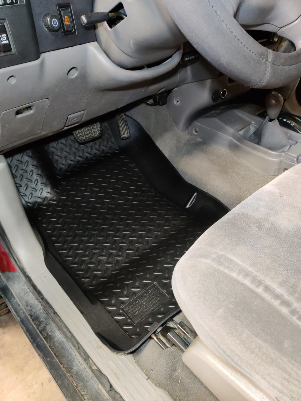

    These Husky floor liners are much better than the cabelas trash
    I think the weather techs are a little better personally but these are good enough for me

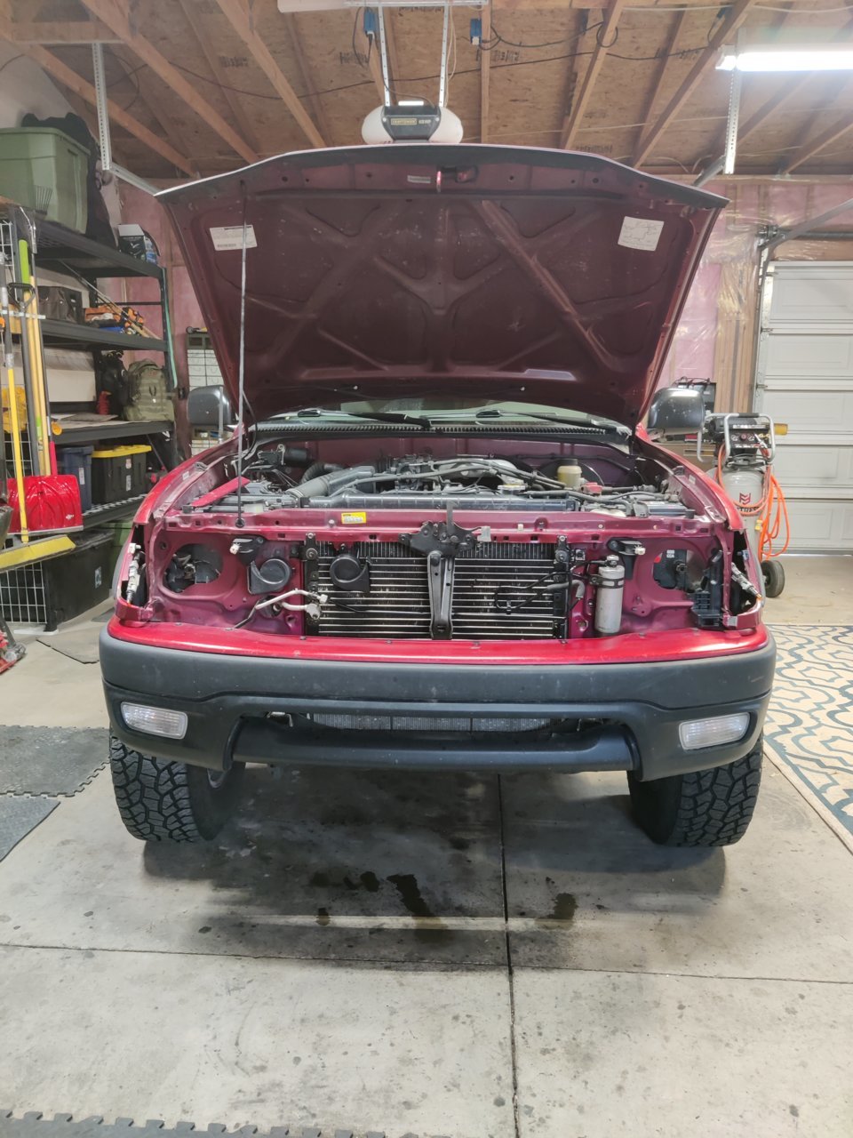

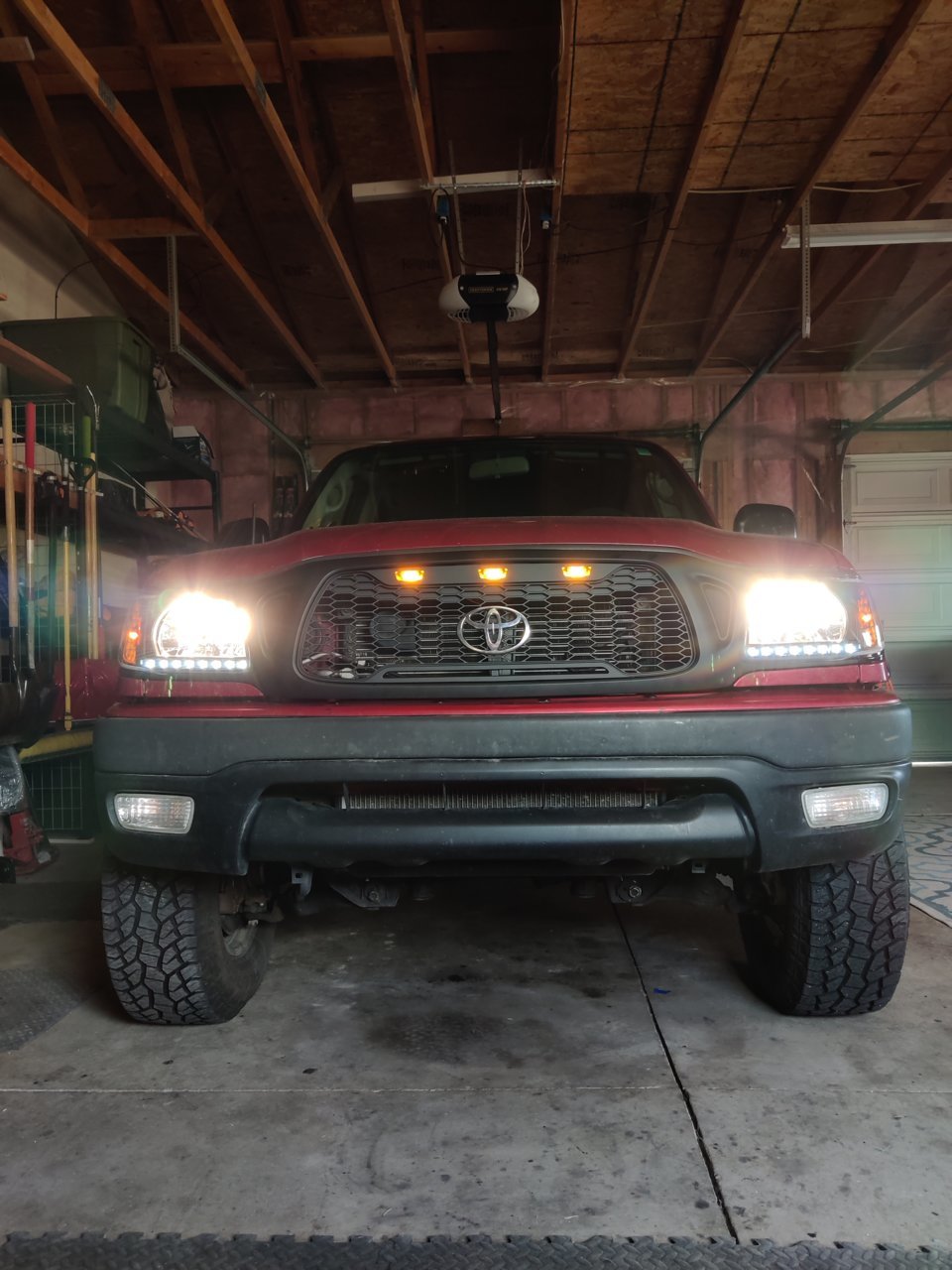

    When I purchased the truck the gentleman I bought it from mentioned there was a minor front end collision he stated it was "nothing more than a baseball bat to the bumper" the grill appeared to be fine but when you looked closer you could see cracks all over the grille. The chrome outer grille was separated from the black plastic and half the grille mounts were broken of and the marker light was a little flip floppy and the whole thing rattled a bit. I'm sure the automatic car wash would have removed it for me for a $5 fee
    Last picture with the OEM grille
    If only I had a transmission cooler to install it would have been the right time to do it (still on my list of things to order)
    Instead of replacing the OEM tacoma grille emblem I went ahead and used the slightly larger emblem off of the 09 tacoma I totalled. Small details add character and it just fits perfectly
    I will say I don't like what Toyota uses to hold these grilles in place. Seriously a zip tie is a better option in my opinion

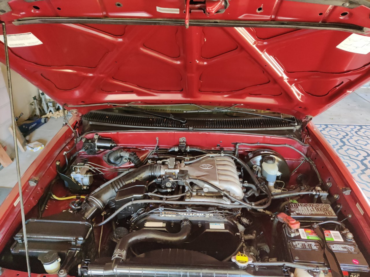

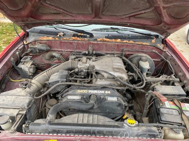

    Of course I went ahead and detailed the engine bay. I'm a bit OCD with certain things
    Here's how it looked at first
    Looks like it's seen a few puddles
    A little TLC goes a long way

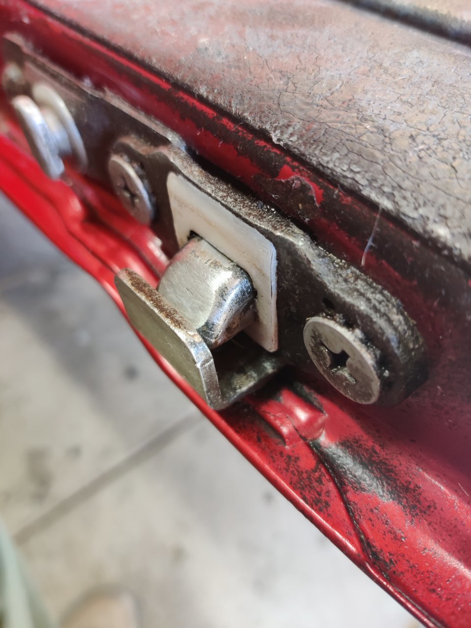

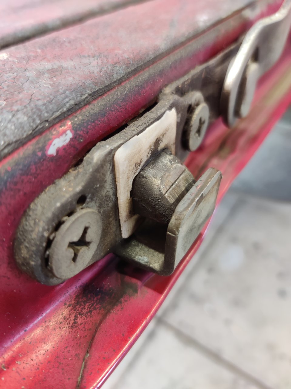

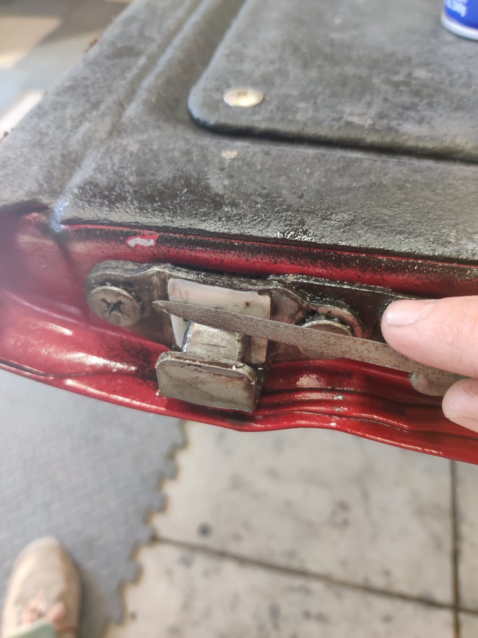

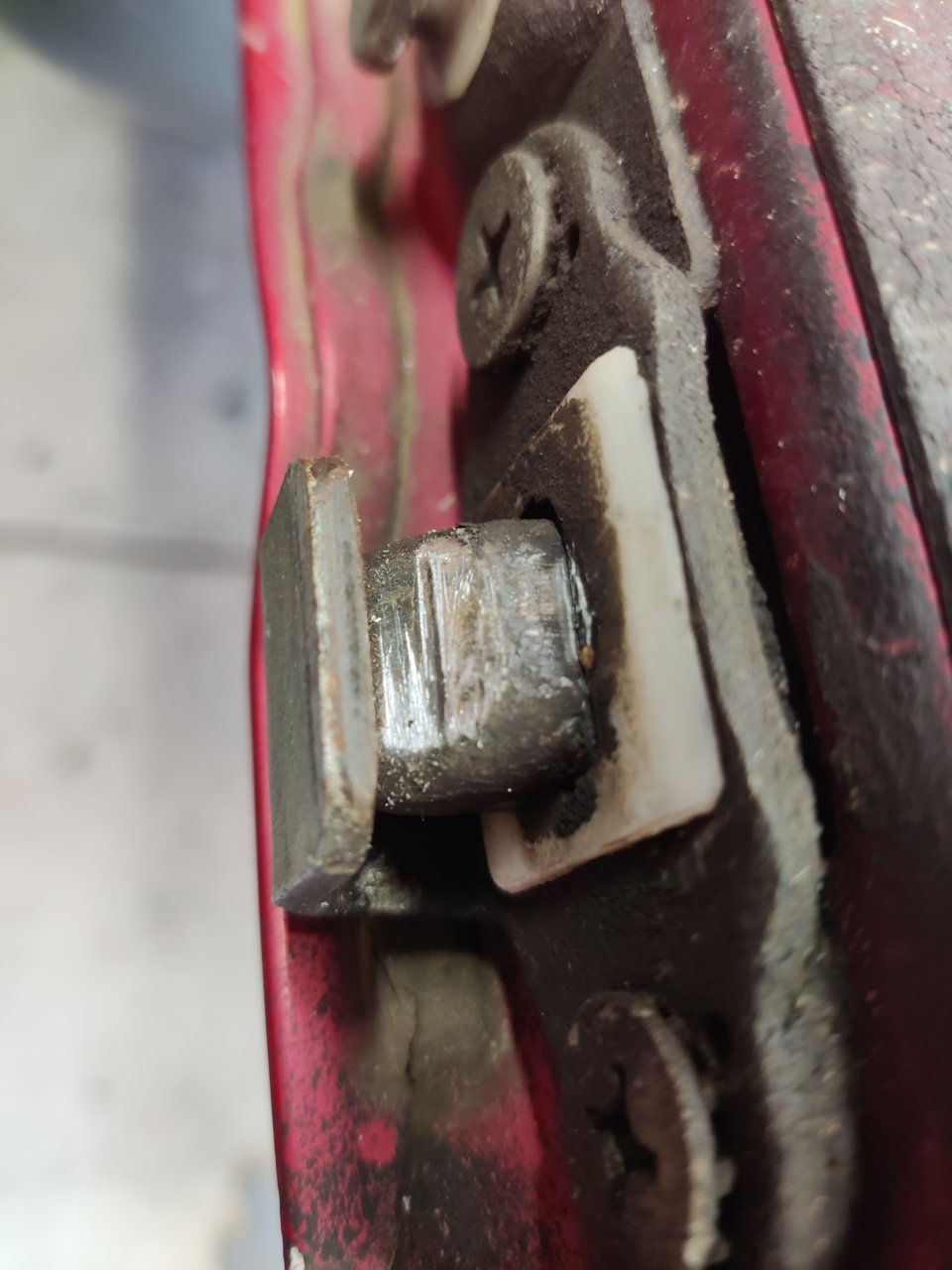

    Another small detail that was annoying me was the tailgate. I don't like to Slam things but this tailgate just seemed to bounce off the latches instead of closing. I guess it's been slammed enough that there's a dent running up the face of the latch
    On both sides
    Simple solution. File it smooth again
    Shuts smooth like butter now

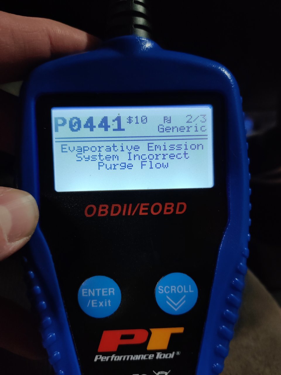

    We must have been visited by a leprechaun because some things turned green,
    I got a golden faucet
    and a Check Engine Light on St Patrick's day.
    I'll be chasing that one for a while.

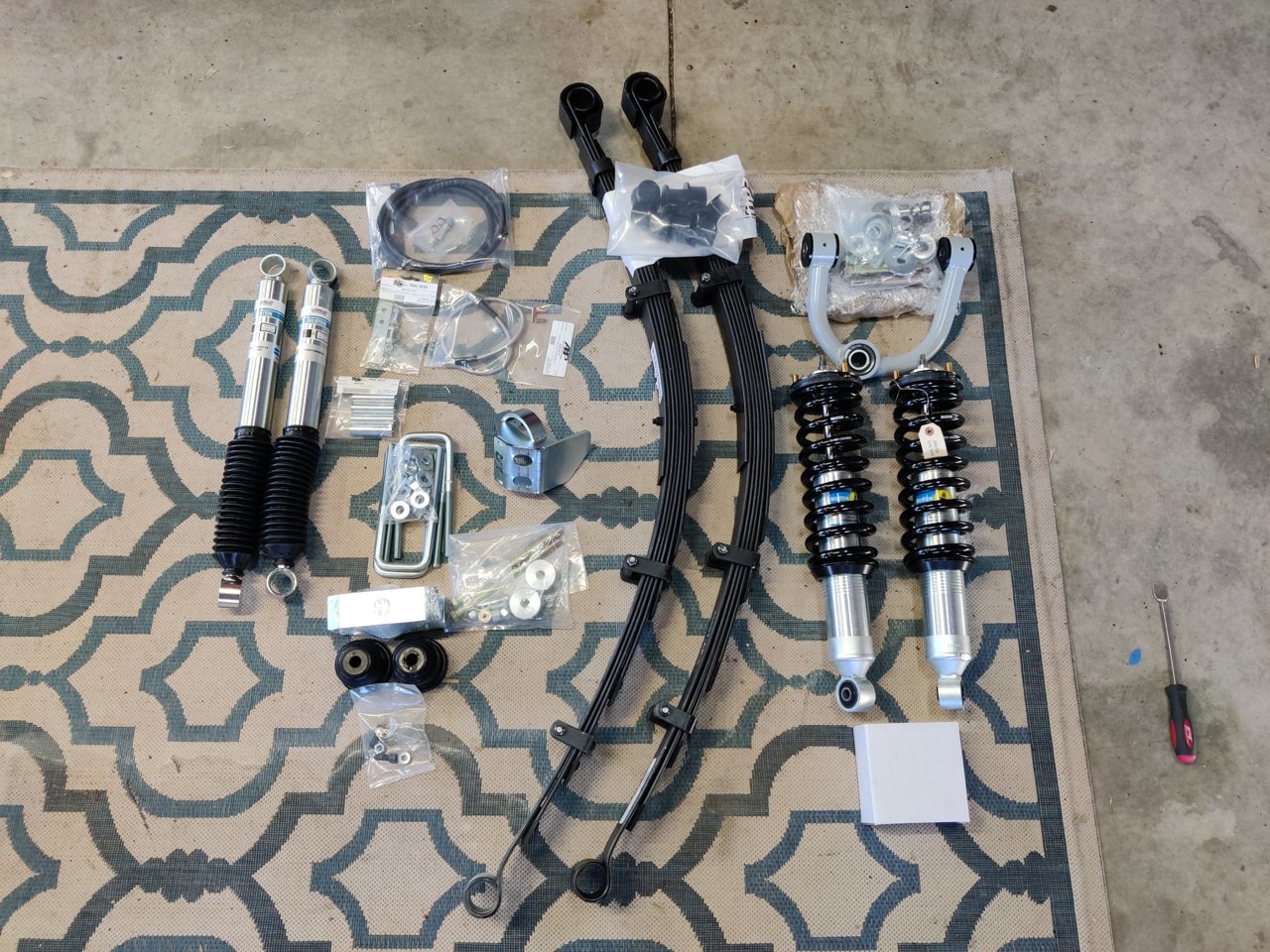

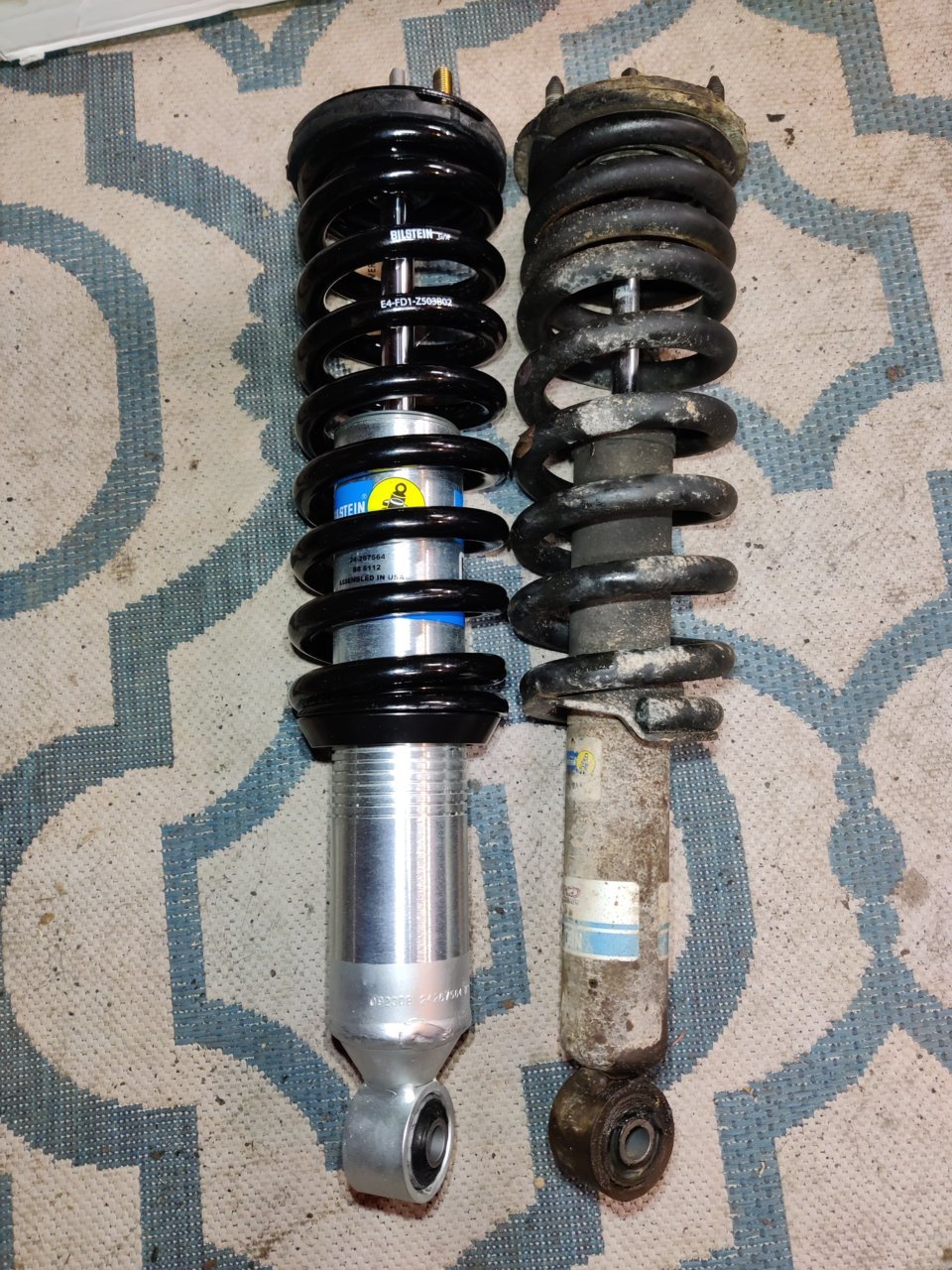

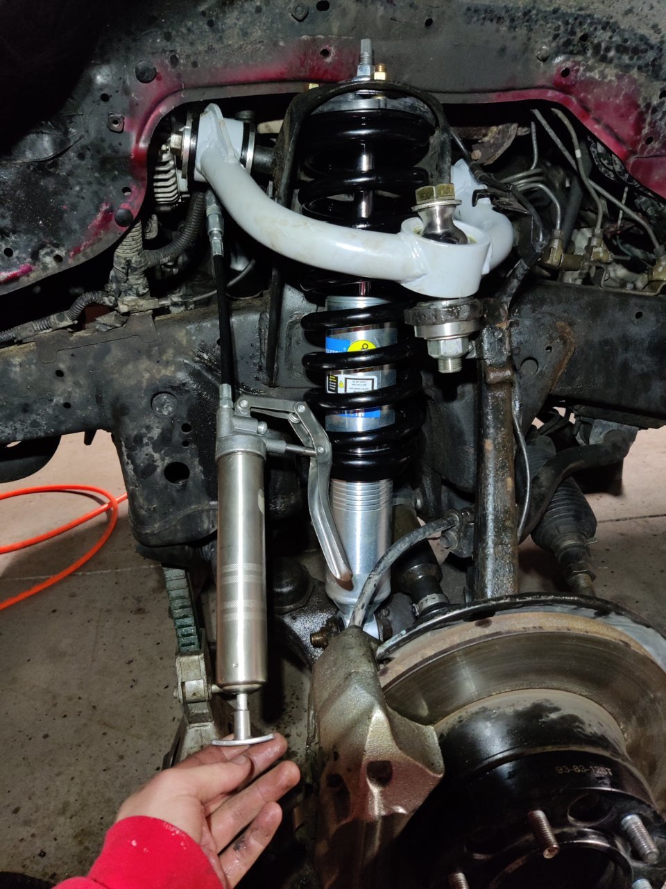

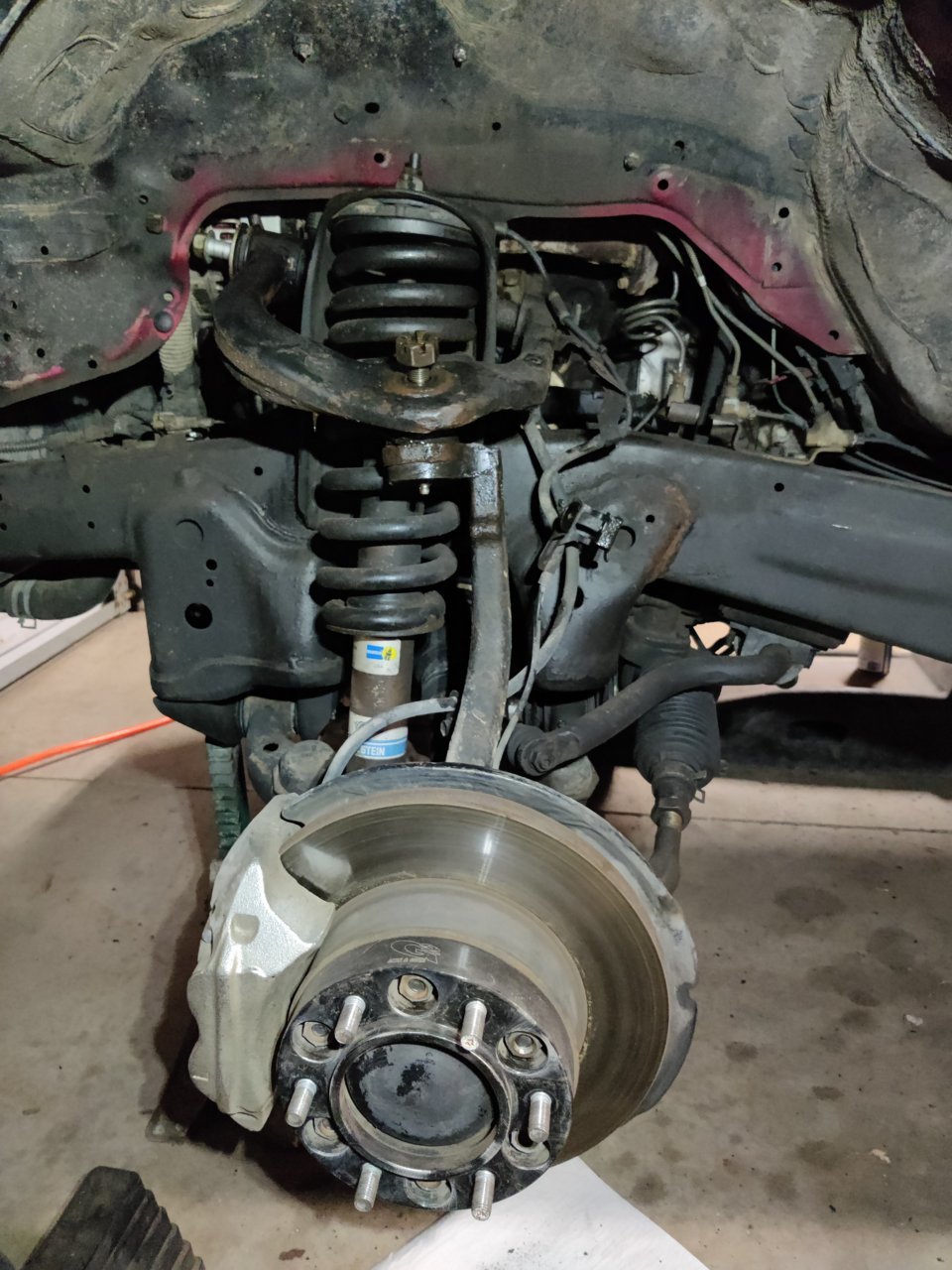

    Next on the list was to address the old warn out Bilstein 5100 lift kit, stock rear springs on aluminum lift blocks
    Can't have that
    Gotta get something new.
    :spending:
    This was the largest order I have ever placed and I was anxious from the very beginning
    :goingcrazy:
    This is the best representation of what I ordered that I could find.

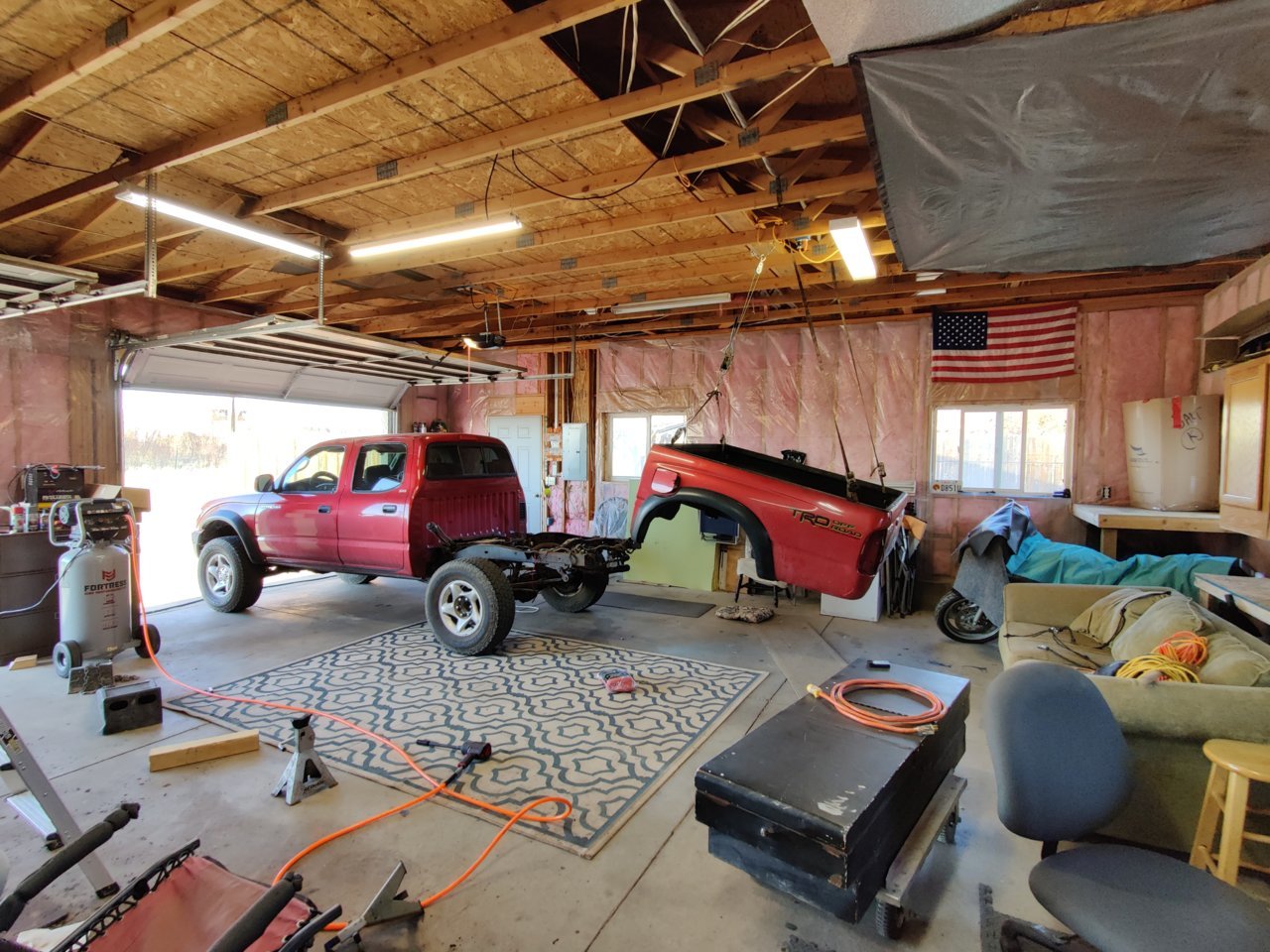

    I wanted to have the truck ready to go when the parts started arriving and wanted to make sure I got the most out of the work I was about to tackle and hopefully keep the rust to a minimum.
    :duh:
    The rear struts were supposed to be Bilstein 5165 remote reservoirs and i received the cheaper 5100's instead so I called and made them exchange it for what I actually paid for. After I got the 5165's I they were too short for the lifted truck and got back to customer service and ordered 5125's.
    Third times the charm
    The front struts are the fatty 6112's on a 600lb spring
    Leaf springs are the All Pro standard 3 inch pack with the military wrap in the front and the extra leaf for axle wrap prevention. So far it's a pretty good setup

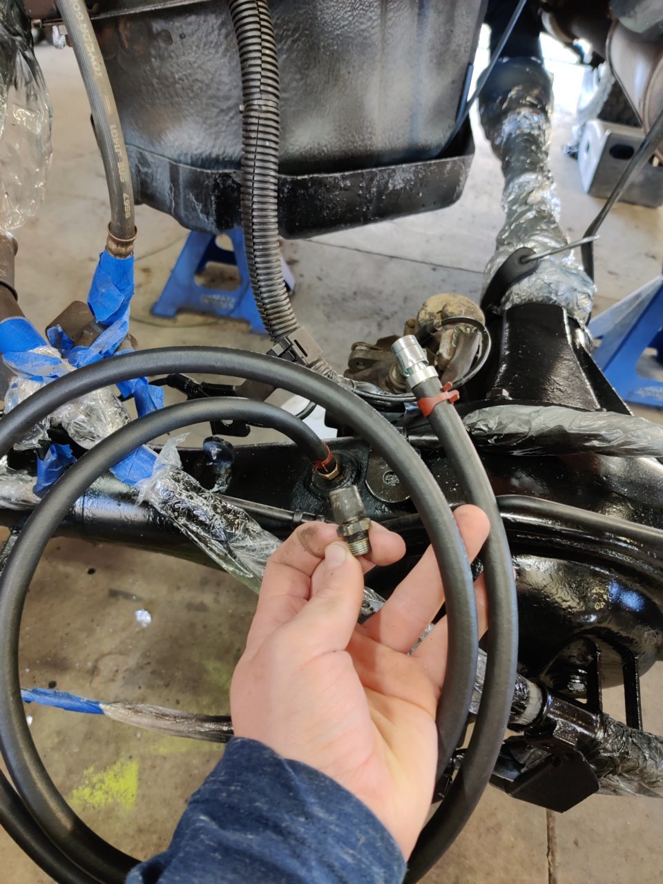

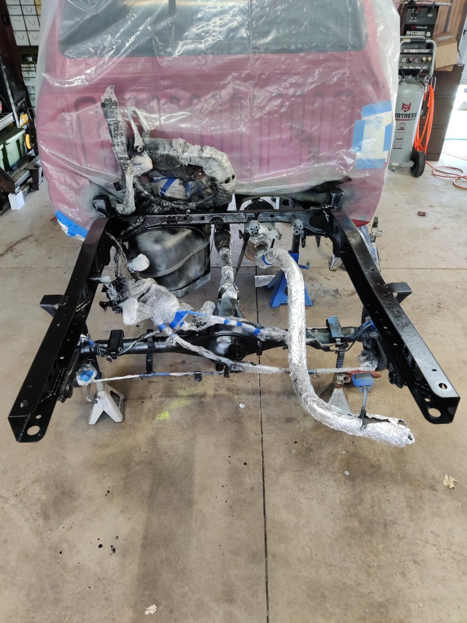

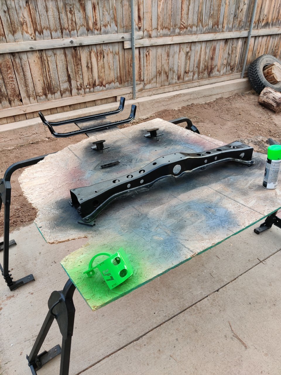

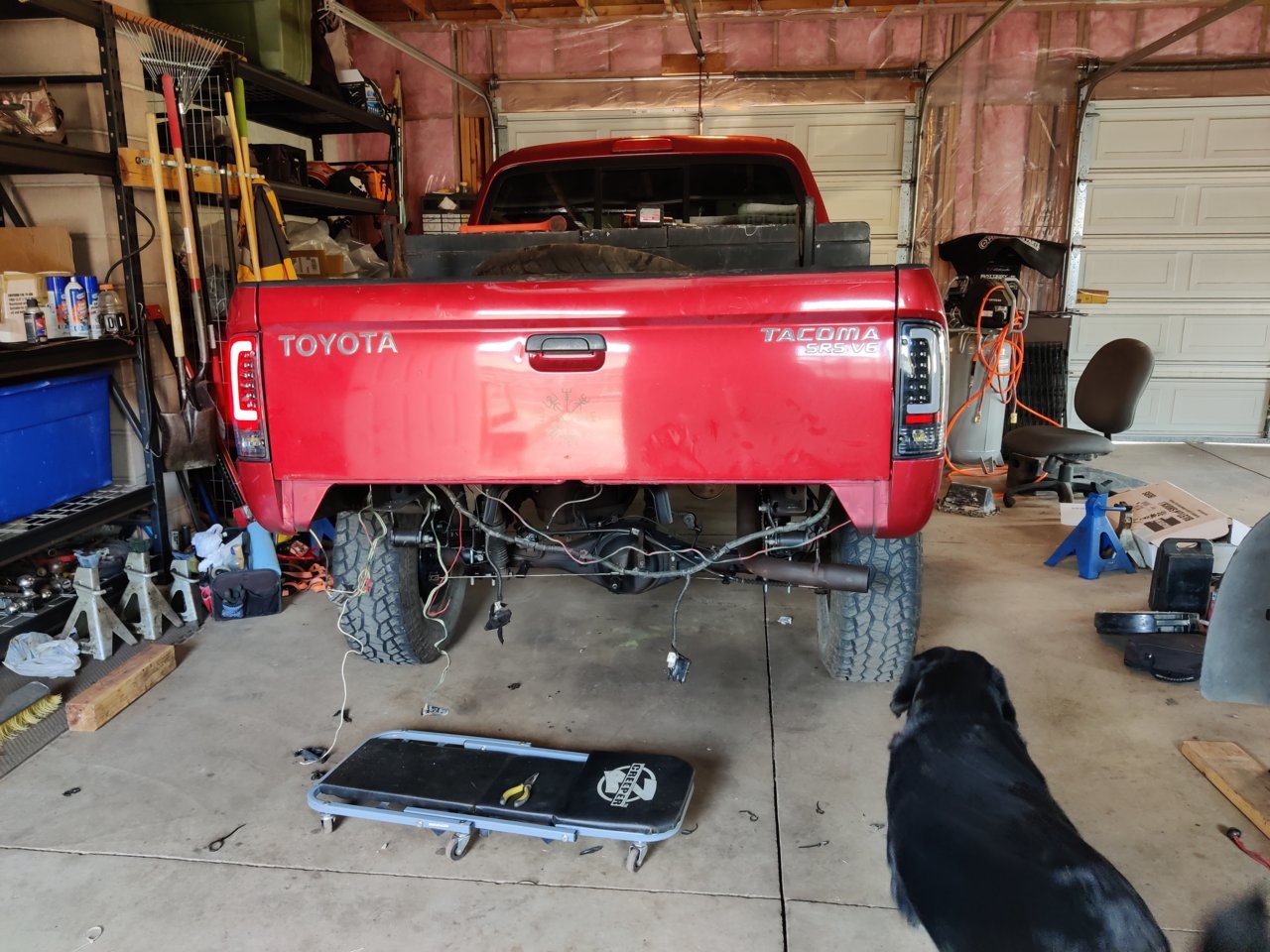

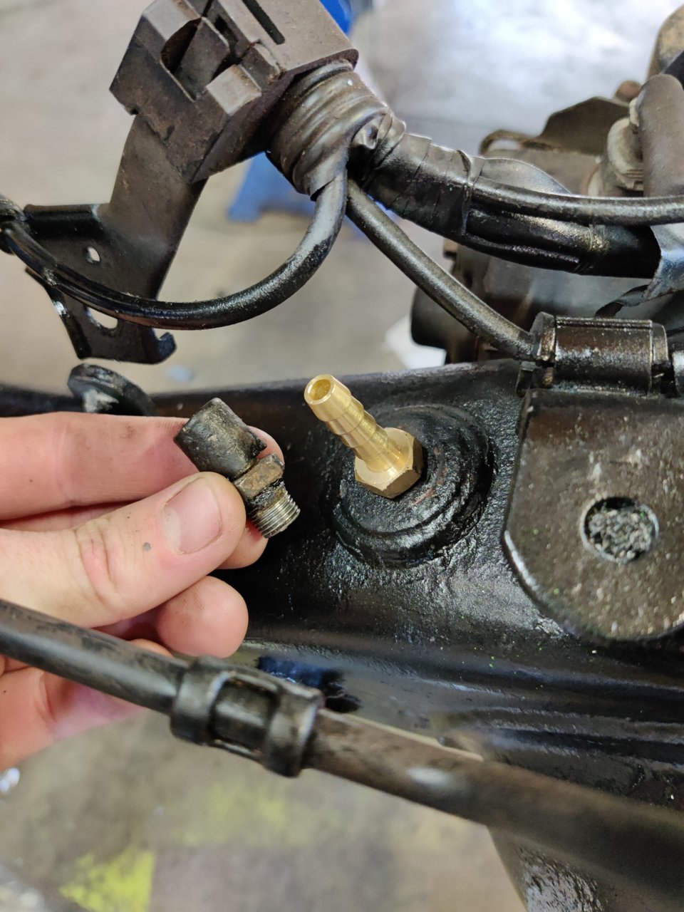

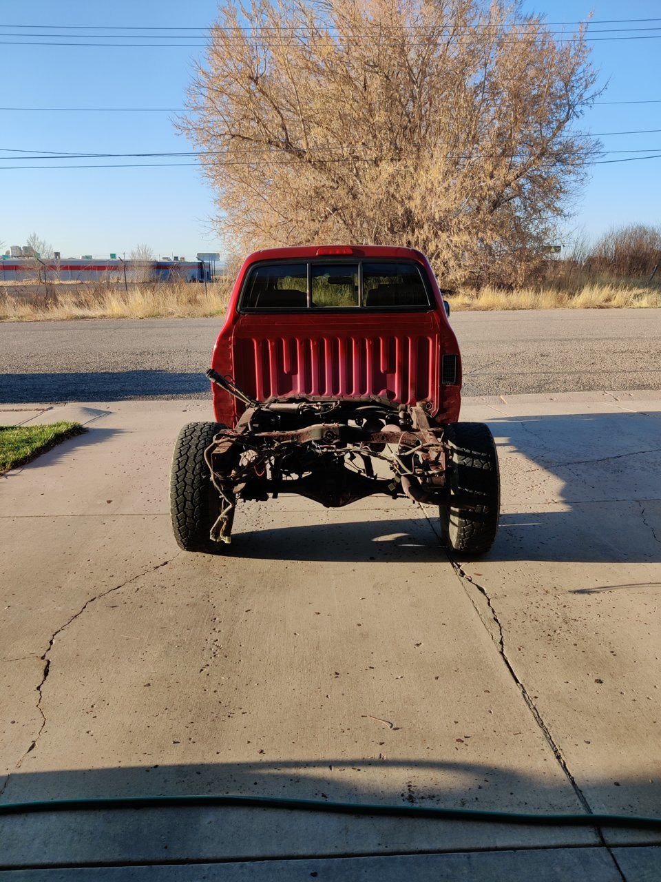

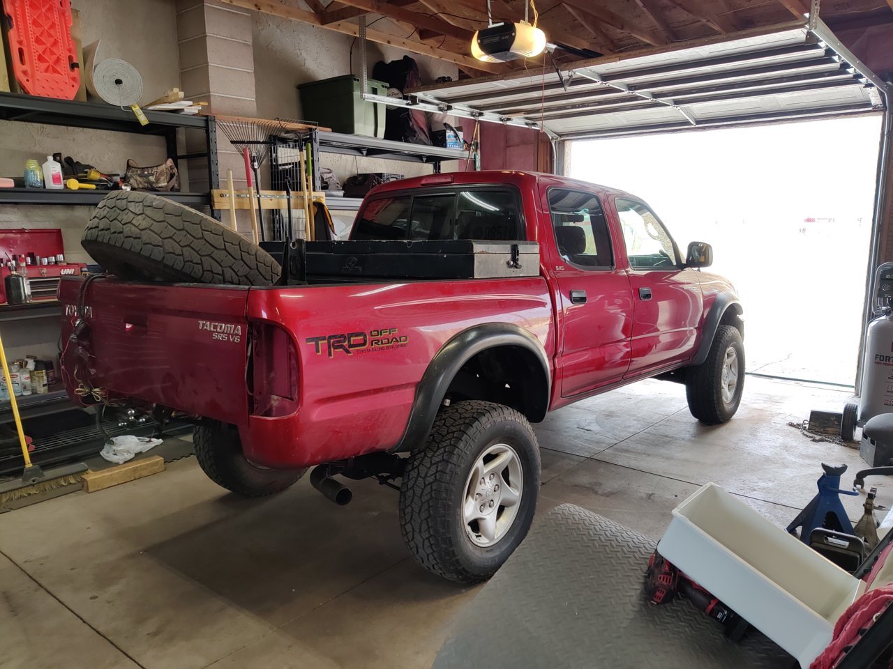

    Installed the extended brake line in the rear and added a dif breather relocation
    I ran this up behind the gas flap when I put the bed back on

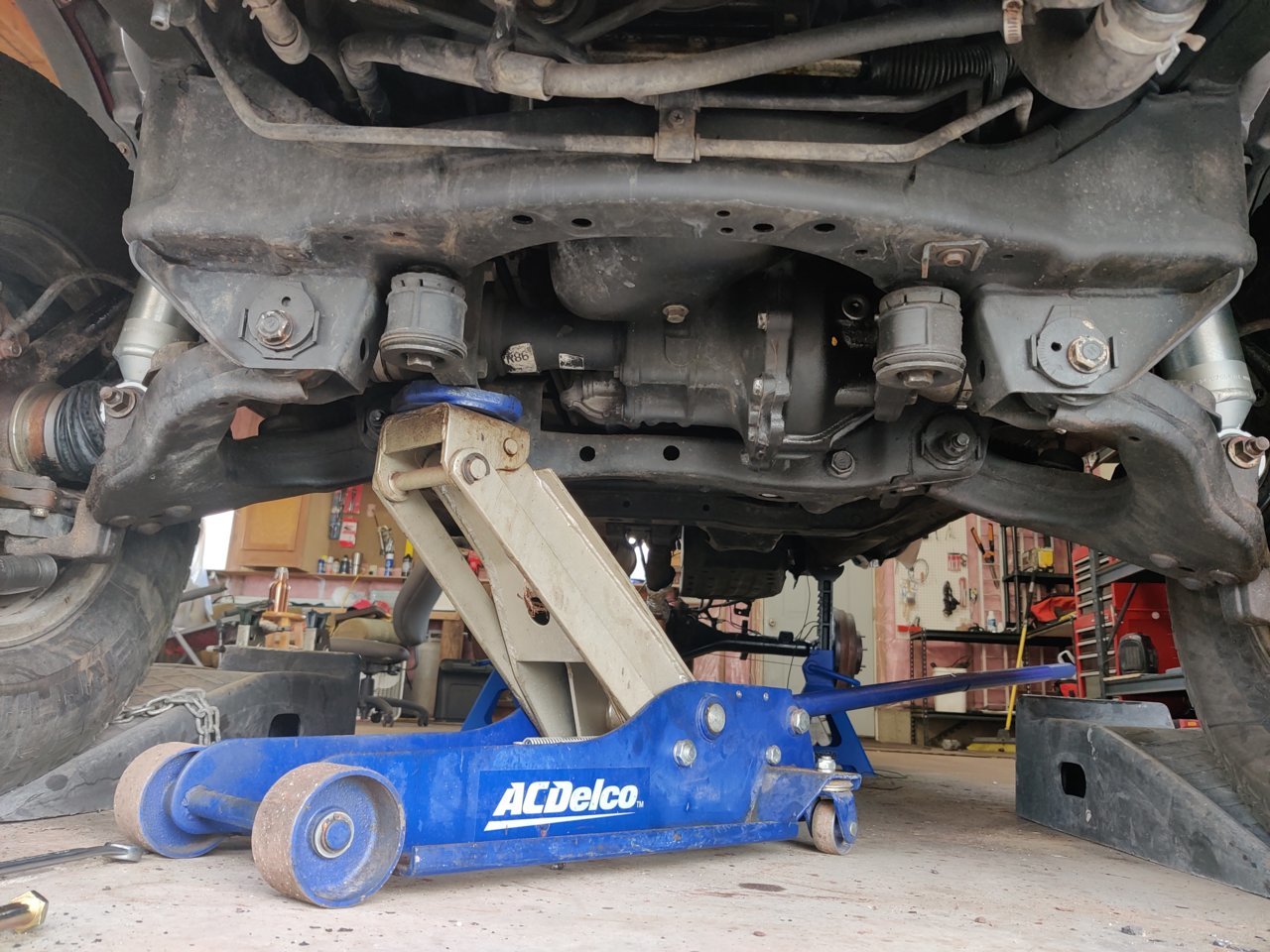

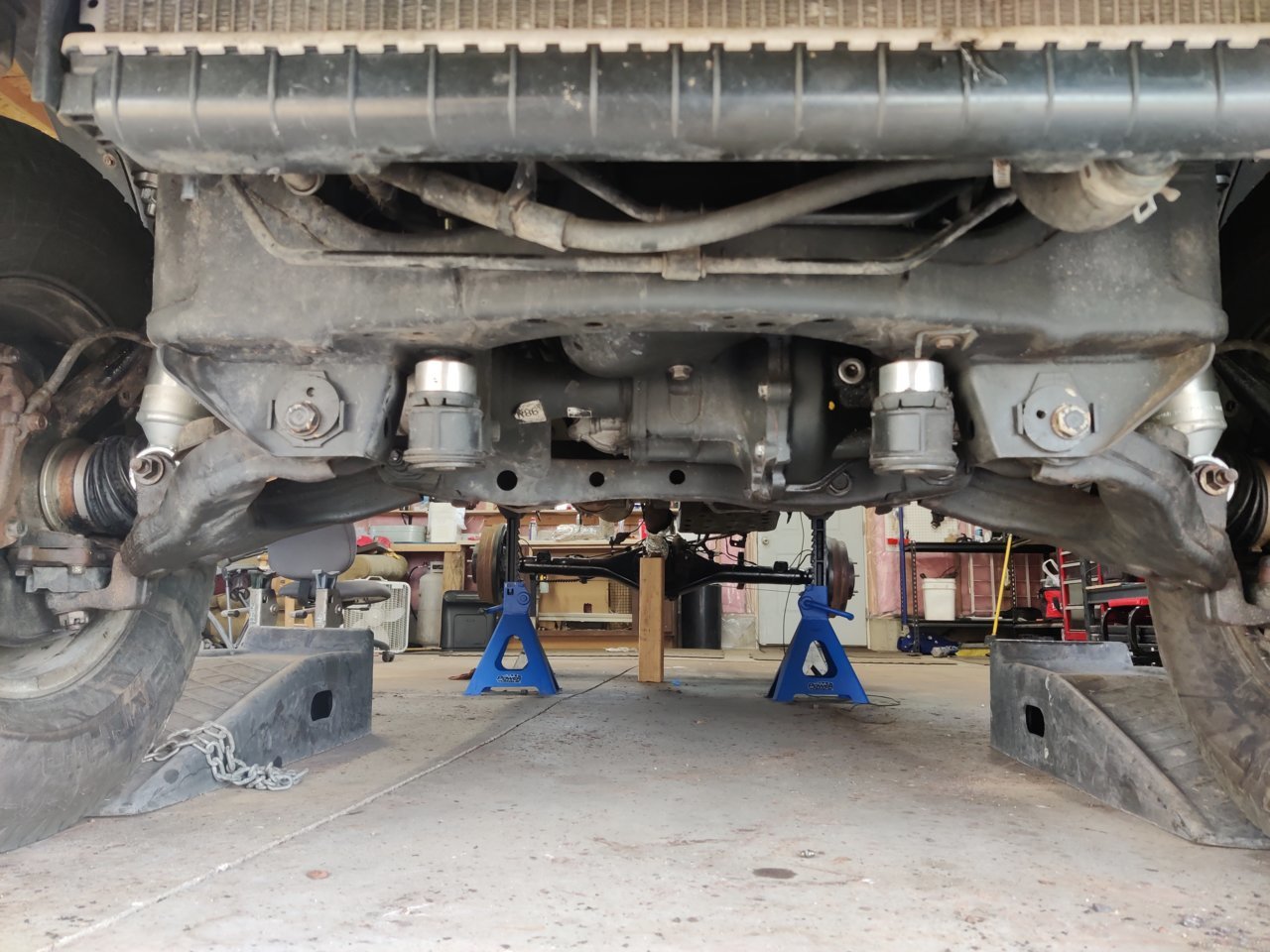

    Installed the front diff drop kit

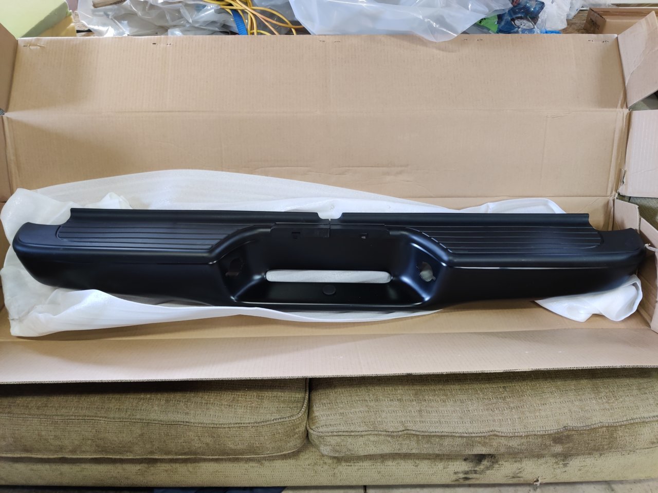

    Back together again. But I wasn't about to reinstall the rusty stock back bumper or trailer hitch receiver and I hadn't planned to use the stock taillights either
    The Anzo taillights said they would work for the later model Tacomas on ebay but all the listing on Amazon said they would only fit up to the year 1999.
    That was an obvious sign something might not work but the styling is just superior to other aftermarket options in my opinion. End of the day I stuck the stock taillights on and called it good enough for now. I also opted for an OEM clone bumper I found easily online that included mounting brackets and all new hardware including the license plate lights for a reasonable price

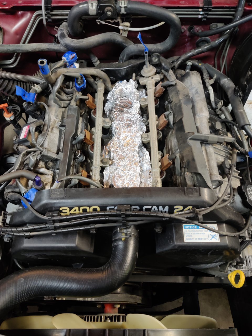

    The next thing I wanted to tackle was that valves cover gaskets because well they are starting to leak and if I'm going to be in there I might as well do some extra maintenance.

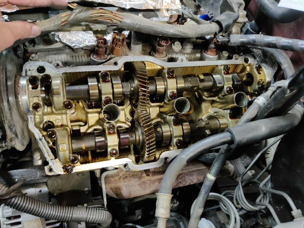

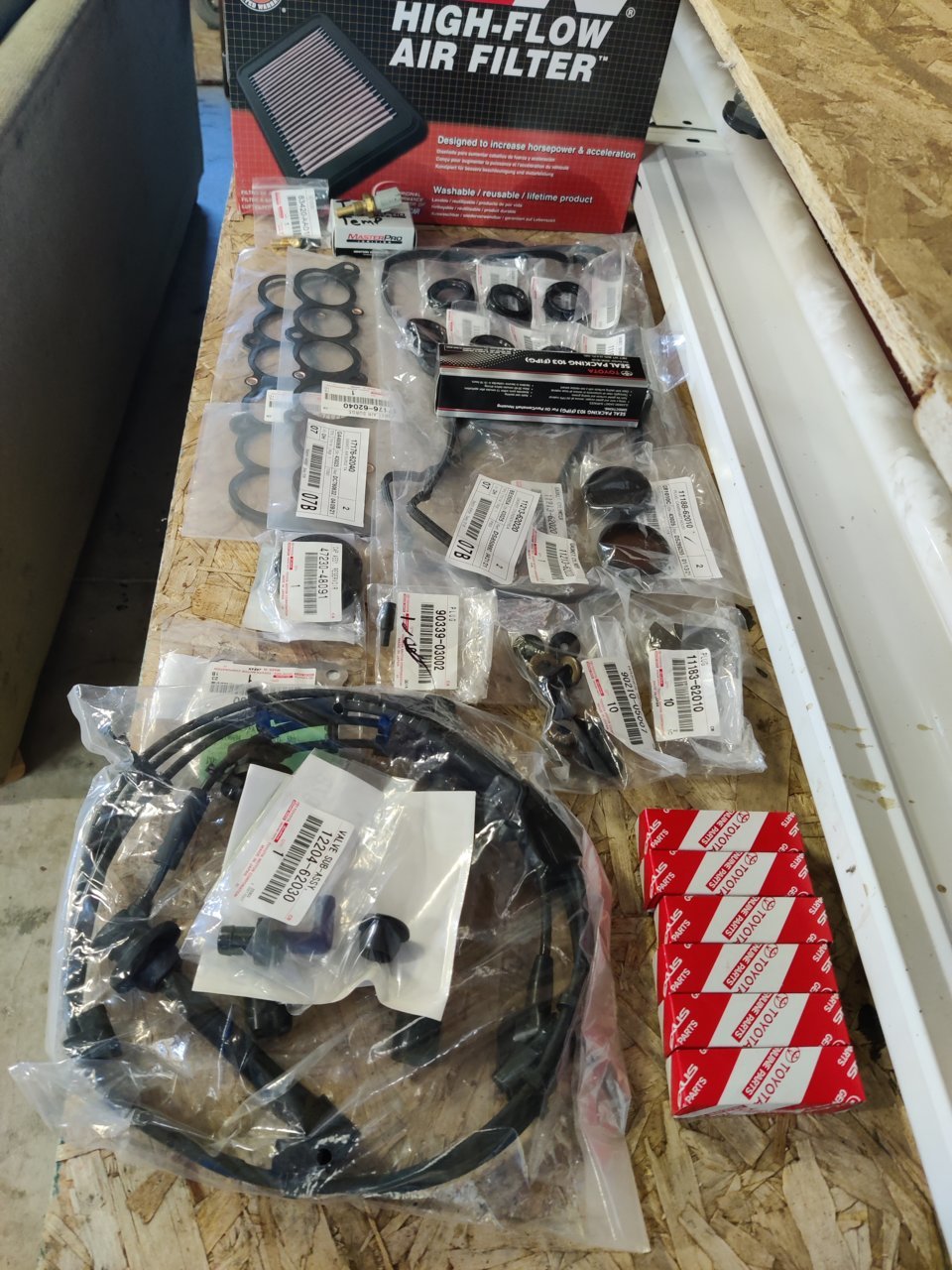

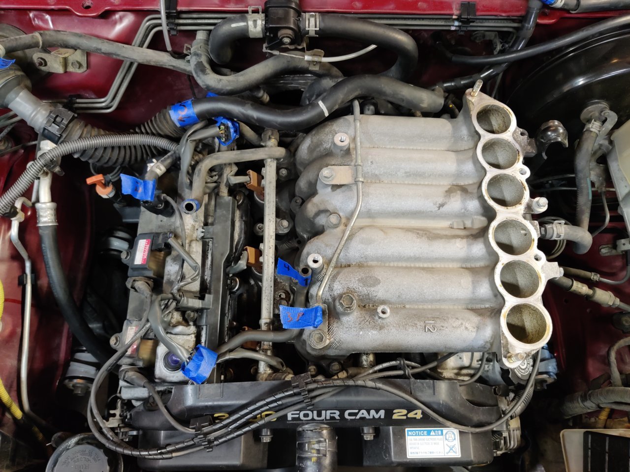

    Here's what I pieced together in preparation for the valve cover job
    I usually will take a few pictures of everything before I start working just so I can look back and make sure everything is where it originally was
    I followed Timmy‘s valve cover job video and also read some other writeups
    @El Taco Diablo has one that i read up on.
    It was also unbearably hot in the garage during this project so I pulled some windshield washing fluid out of the freezer and placed them in the engine bay. I soaked myself with a Sprinkler several times and ended up working until after 4am. Trying to avoid the heat of the day.
    Nice and clean for an engine with 320,00 miles. That was comforting
    This cabinet was thrifted from habitat for humanity and has come in very handy as I take things apart I put the parts in order and place the new seals or whatever next to the corresponding parts so everything stays organized and in order. Maybe I'm a little OCD.

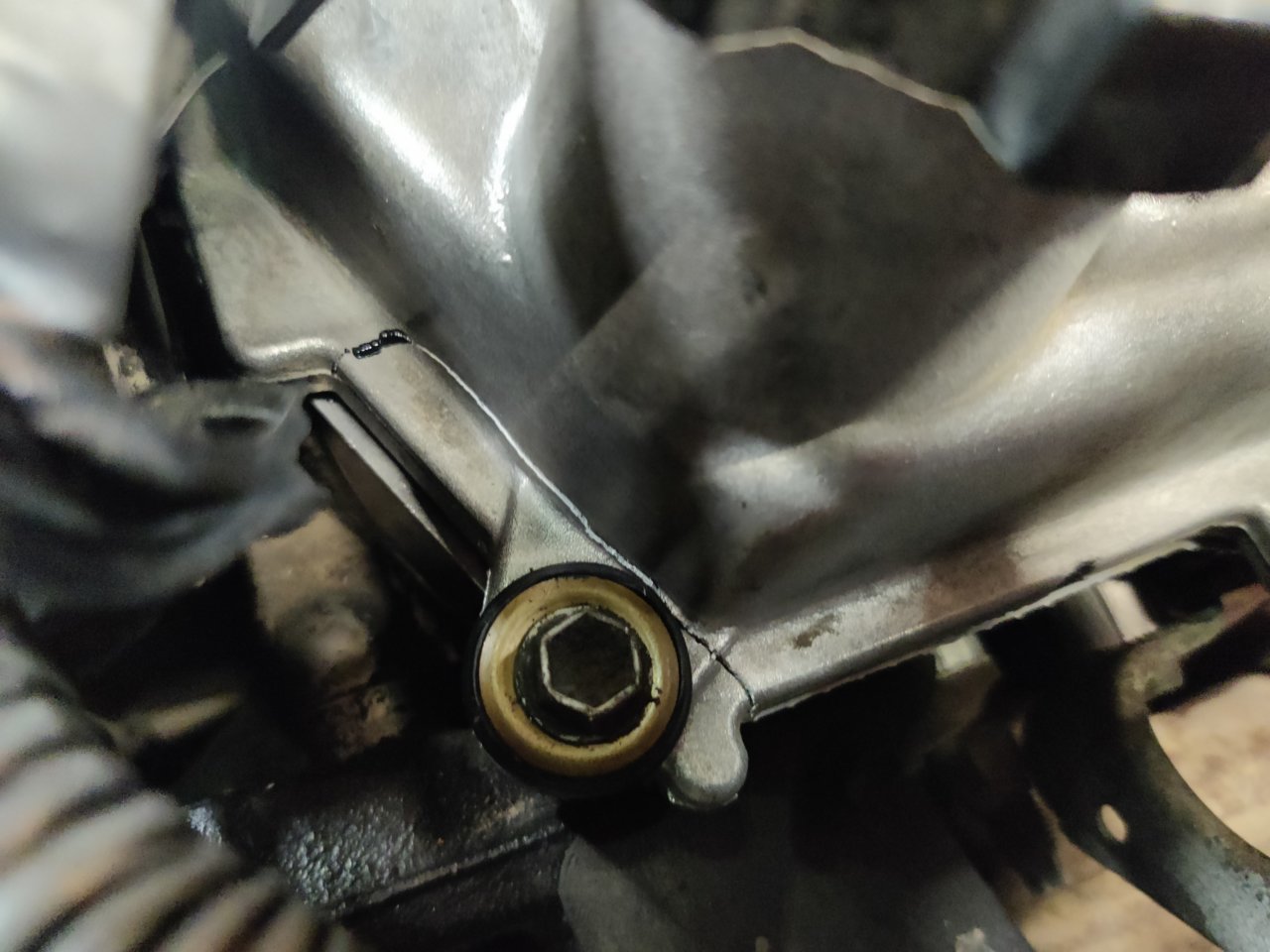

    I didn't get many pictures after this point as I got busy trying to have it back together before the sun came up so I could drive it to work at 10am
    Everything was going nice and smooth so obviously that's when I made a rookie mistake and over tightened the drivers side valve cover
    IMG_20210615_023812.jpg Oops
    First thought was throw on a little extra FIPG in the crack and hope for the best haha.
    Don't do this at home. Or do if that's what you have to do.
    Here's my rough check list I used to minimize errors and it worked pretty well
    it went out the window for a little while but that's just how I work sometimes haha. Maybe a little ADD mixed in with the OCD but I got the job done and the crack in the valve cover hardly even leaks, I do have a spare valve cover on the shelf for the next time I dive into the head.

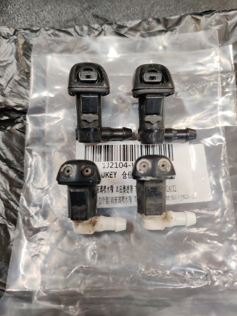

    Next was another simple easy and satisfying part swap that costs next to nothing.
    Honda Odyssey washer sprayers!
    If you haven't done this yet you are wrong.
    Just do it, or don't, you do you.
    I had a second gen in my garage.
    :gossip:

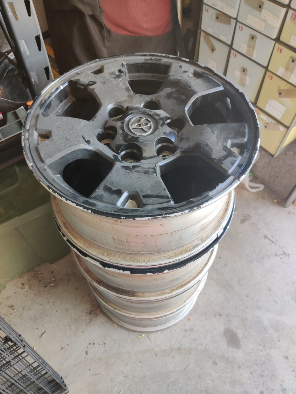

    Installed my used Bully Dog chip in her truck since they don't have programming available for the 1st Gens.
    She left her stock wheels behind for me as a trade for the chip so she didn't feel like she was ripping me off.
    I am a little partial to the wheels so I'm happy with it. Some TLC may be needed and some fresh rubber is in order
