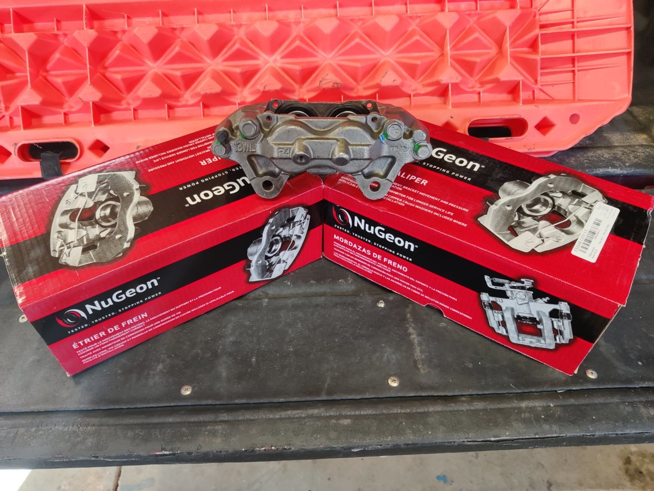

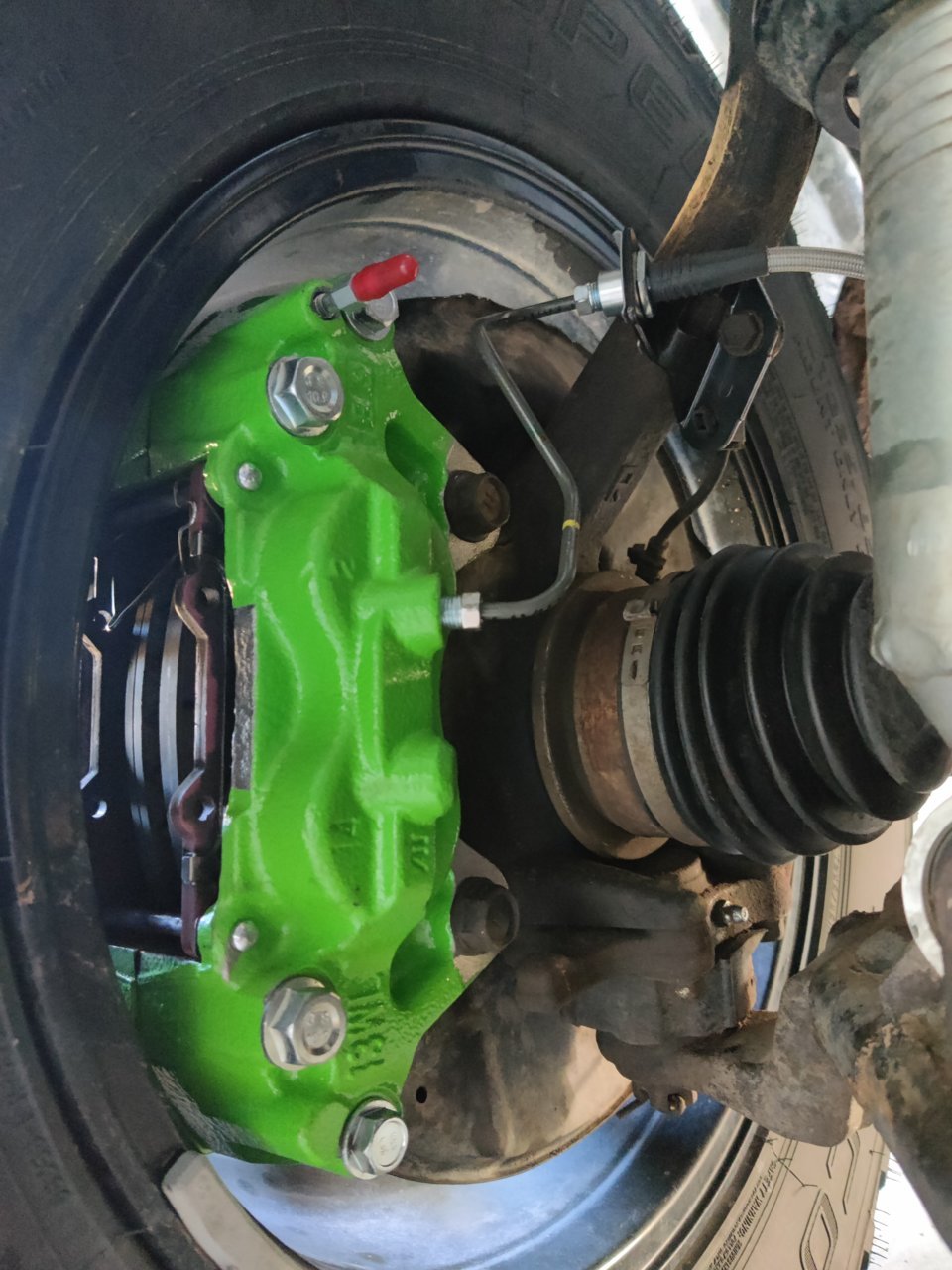

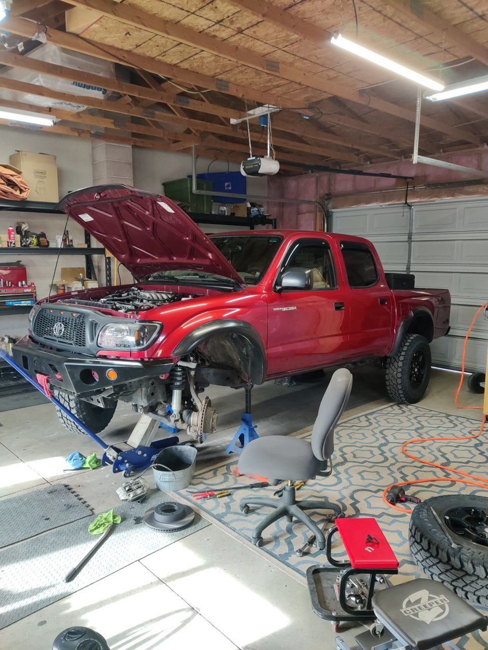

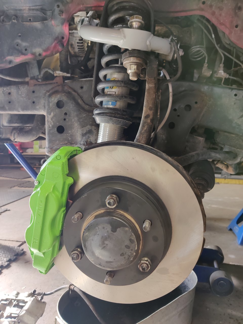

    CX Racing Turbo kit. TransGo shift kit. All Pro Apex bumper and skids. Smittybilt XRC 9.5 winch. All Pro Upper control arm's. Bilstein 6112's with 600lb coils. Eimkeith's lower control arm reinforcement plates. Perry Parts bump stops. All Pro spindle gussets and alignment cam tabs. All Pro standard 3" leaf springs. Bilstein 5125's rear. Extended rear brake lines. Rear diff breather relocation. MagnaFlow catback with resonator. Bluetooth stereo. Memphis 6x9 door speakers. Diode Dynamics SS3 Pro Amber fog lights. Single piece headlights. aftermarket grille. Anzo taillights. LED 3rd brake light. 4runner sunglass holder and dome lights. Master Tailgaters rear view mirror with 3 directional cameras, G shock sensors, and anti theft system. Honda windshield washer nozzles. Stubby antenna. Scan Guage II. 2nd Gen Snowflake wheels powder coated black. Cooper Discoverer ST Maxx 235-75/16 Denso 210-0461 105 amp alternator. Speedytech7's big wire harness upgrade. Aeromotive 340 fuel pump. Haltech Elite 2500. Tacomaworld sticker. Tundra brakes with Adventure Taco's hardline kit

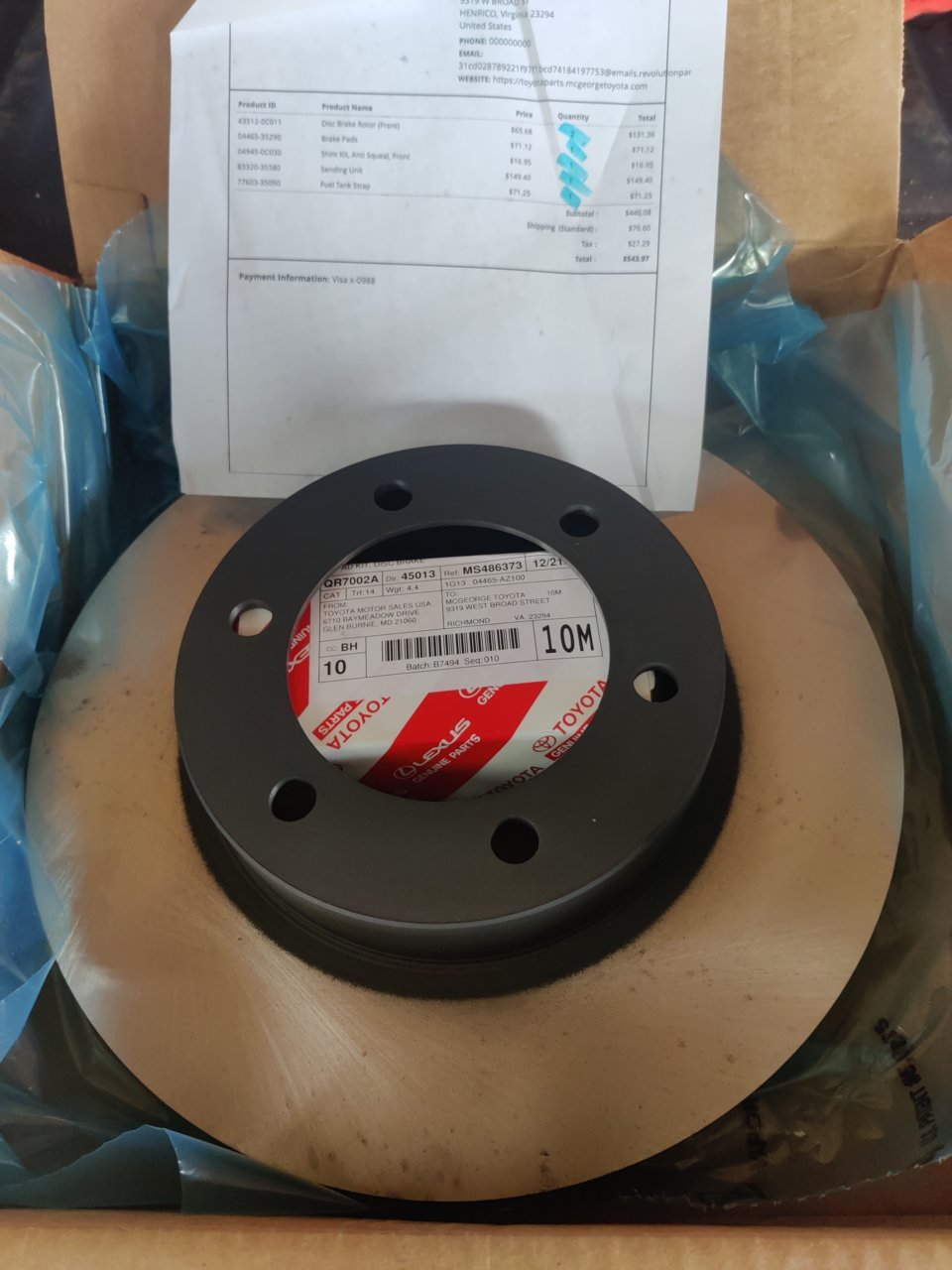

    13WL Calipers came from Napa.
    I think I payed around $300 but I traded my old ones in for a $120 core charge
    Rotors, pads and shims came from McGeorge Toyota for about $220

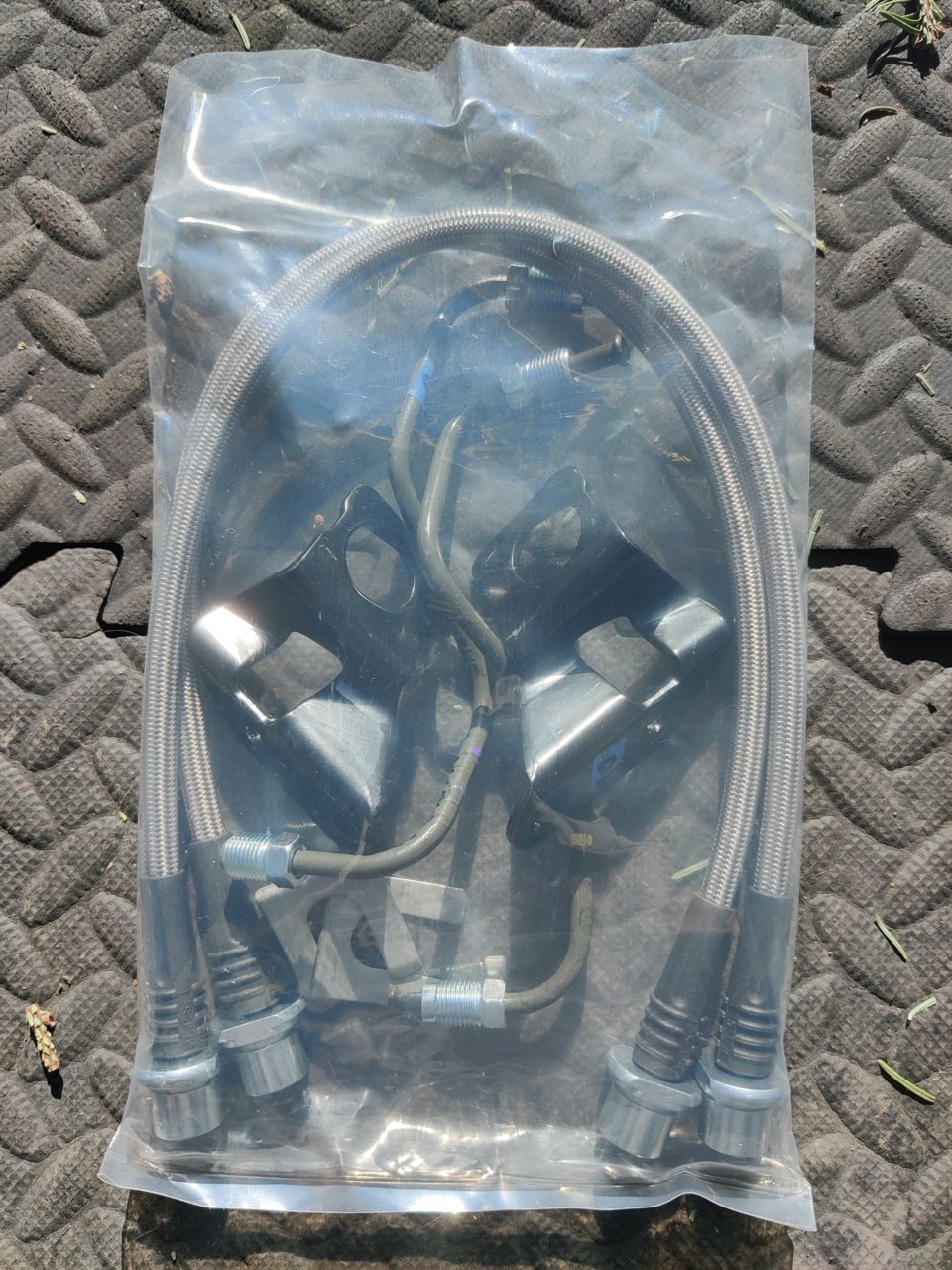

    Brake lines came from Dan at Adventure Taco for $120
    @turbodb
    Skin came from off my fingers at no additional charge
    Brice, MarX and Diablo169 like this.
  2. Jan 19, 2022 at 1:20 PM
    #62
    unstpible
    unstpible [OP] Well-Known Member
    Aug 16, 2012
    #84909
    3,844
    Derek
    Cedar City, Utah
    03 4x4 boosted V6 Auto 341k miles

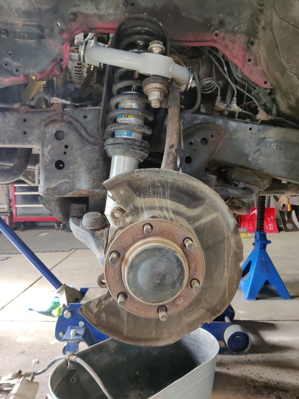

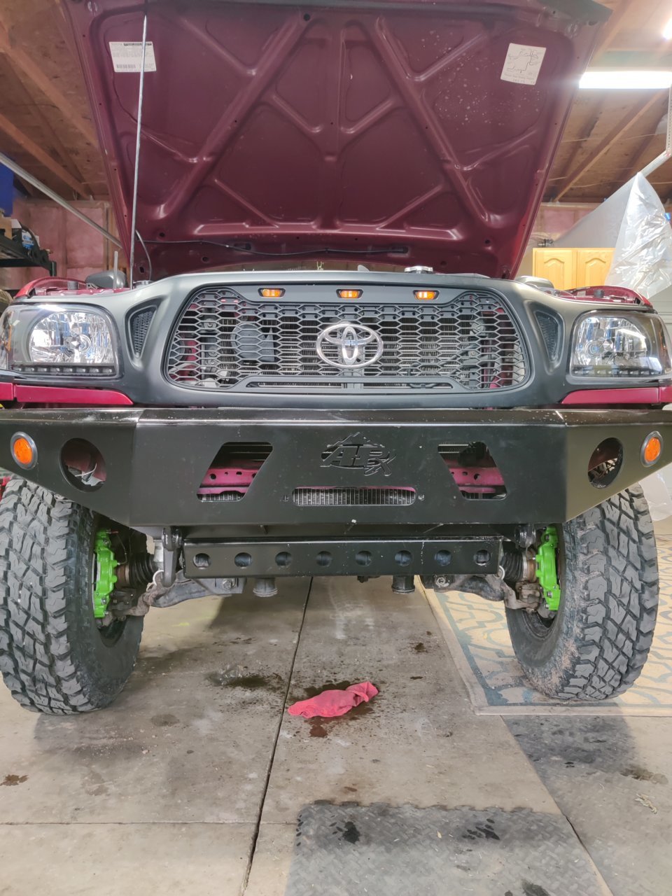

    The install is pretty straightforward and there are several detailed instructions available in other threads. :deadhorse:

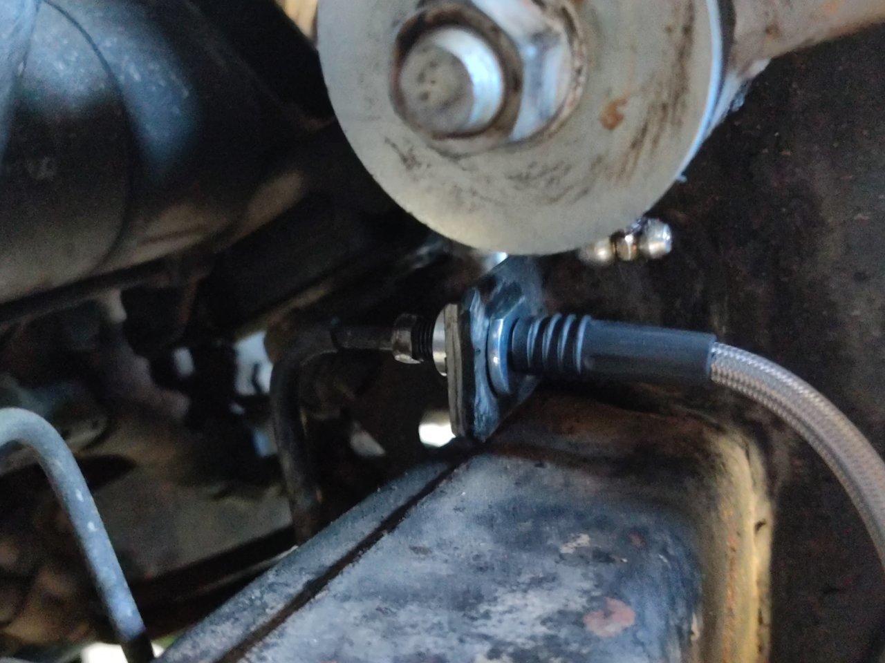

    Remove the tire
    Disconnect the brake line at the top of the frame.
    To remove the clip holding the brake line in place I reached down through the engine bay with a long pry bar and tapped it out with a hammer.
    Side note.
    Sometimes these hard lines can be difficult to remove and the heads strip easily.

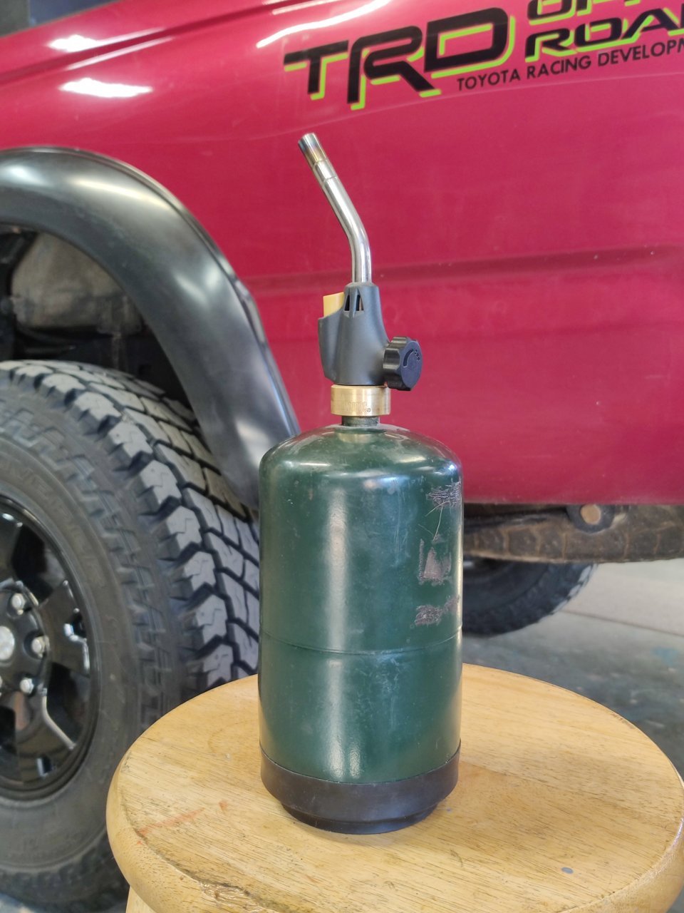

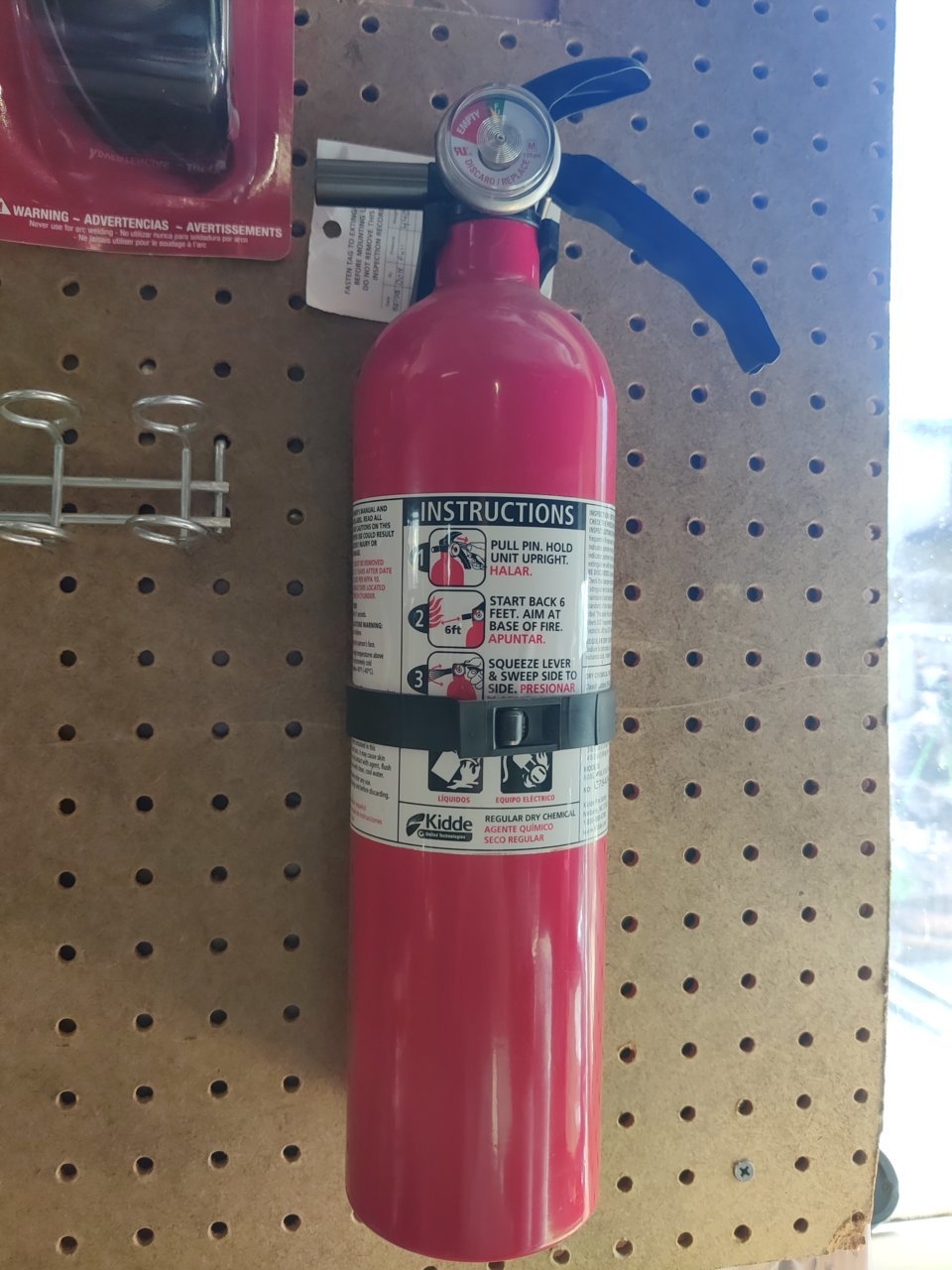

    If they don't want to move I go straight for the little camp torch
    Get it nice and warmed up and then hit it with a little WD-40. Sometimes it starts a small fire, usually just smokes a little. maybe don't try this at home (or do, you do you).
    I've used this method on some gnarly rusted out bolts and brake lines over the years with good success.
    Remember kids always play with fire safely
    I used a vacuum cap as Dan suggested to stop the hard line from leaking once it's disconnected.
    Remove the bracket attaching the brake line and ABS wire to the spindle.
    Remove the caliper with the brake line still attached

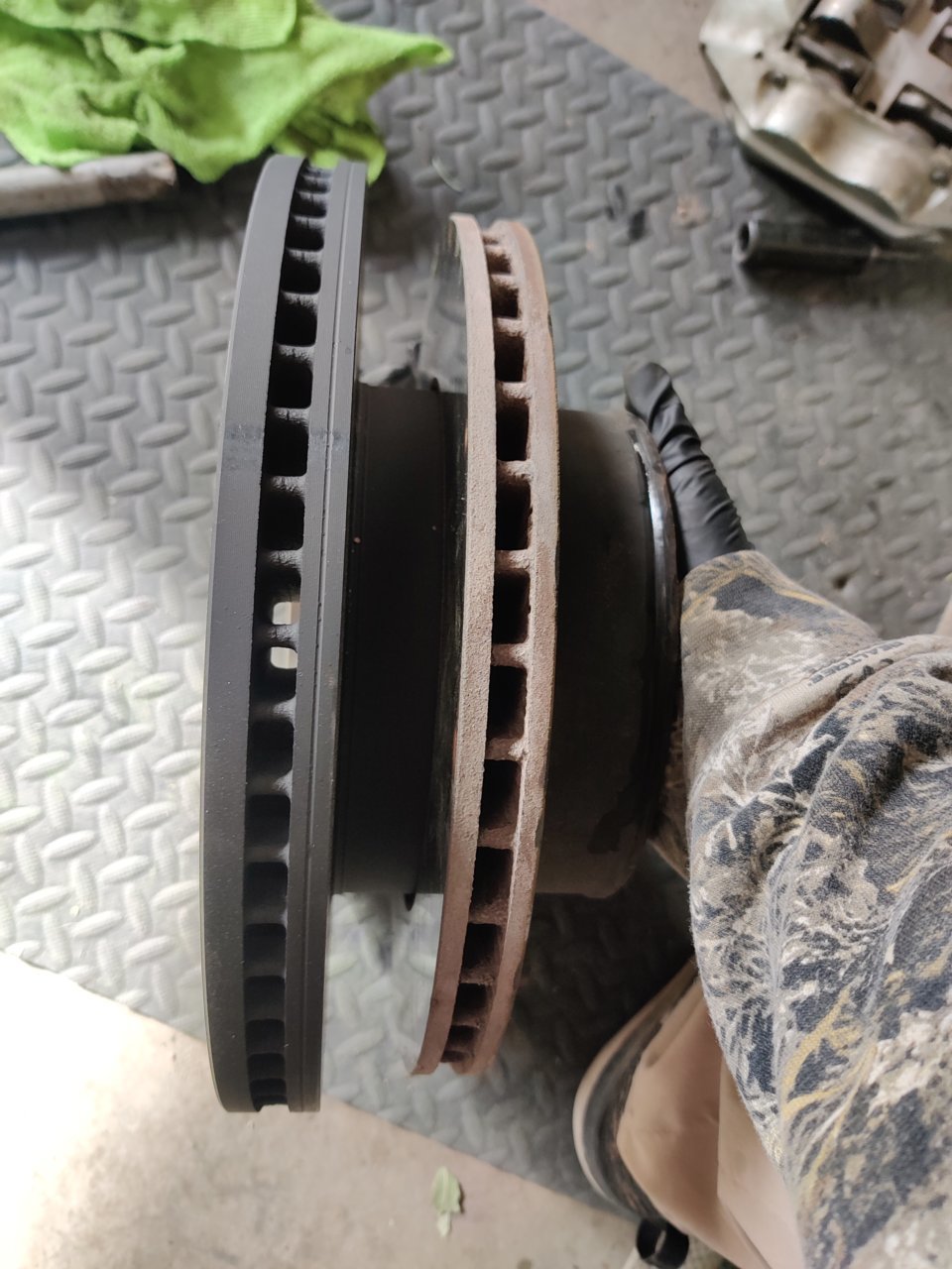

    Smack the rotor around for a bit and they pop off.
    Trim the corners off of the heat shield. I was almost able to do this with just some old tin snips but ended up using the grinder.
    Now put it back together with the new stuff
    My passenger side caliper didn't come with a dust cover for the bleeder value but at least I have that vacuum cap

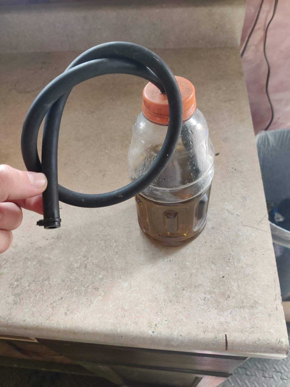

    I connect the brake line starting at the caliper and working towards the frame once the last line is connected I opened the bleeder valve and waited for fluid to start leaking out and then tighten it back down.
    For bleeding the brakes I use a home made Ghettoaid brake bleeder
    Got everything buttoned down and drove to St George and back making sure to take advantage of the drop in altitude and high speeds of I-15 to seat the brakes in nicely.
    I am very pleased with how the brakes feel and perform.

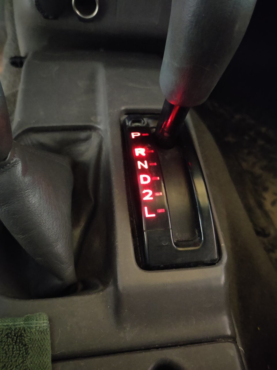

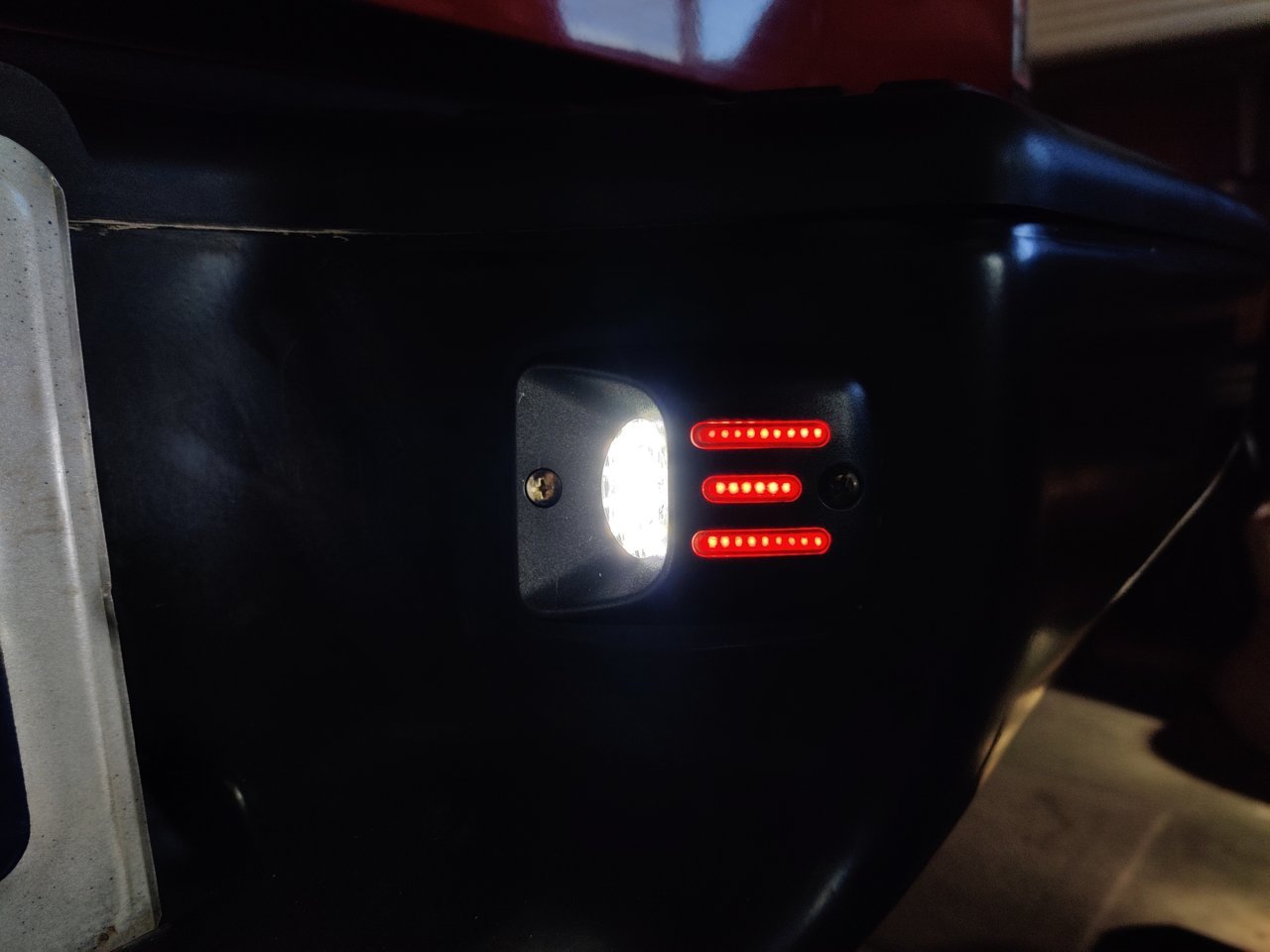

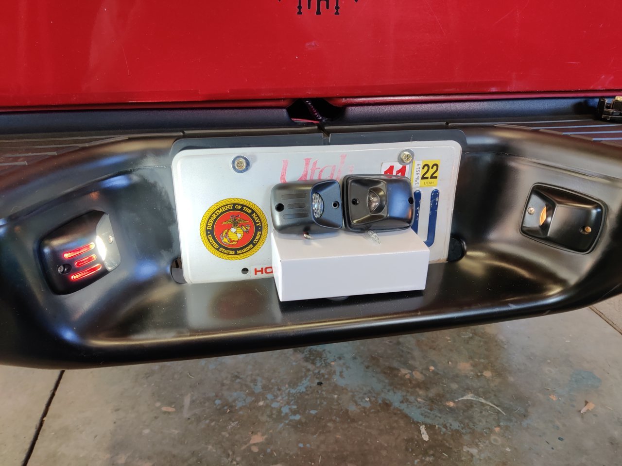

    Small simple project today
    I ordered these a while back
    So bright you could probably call them chase lights

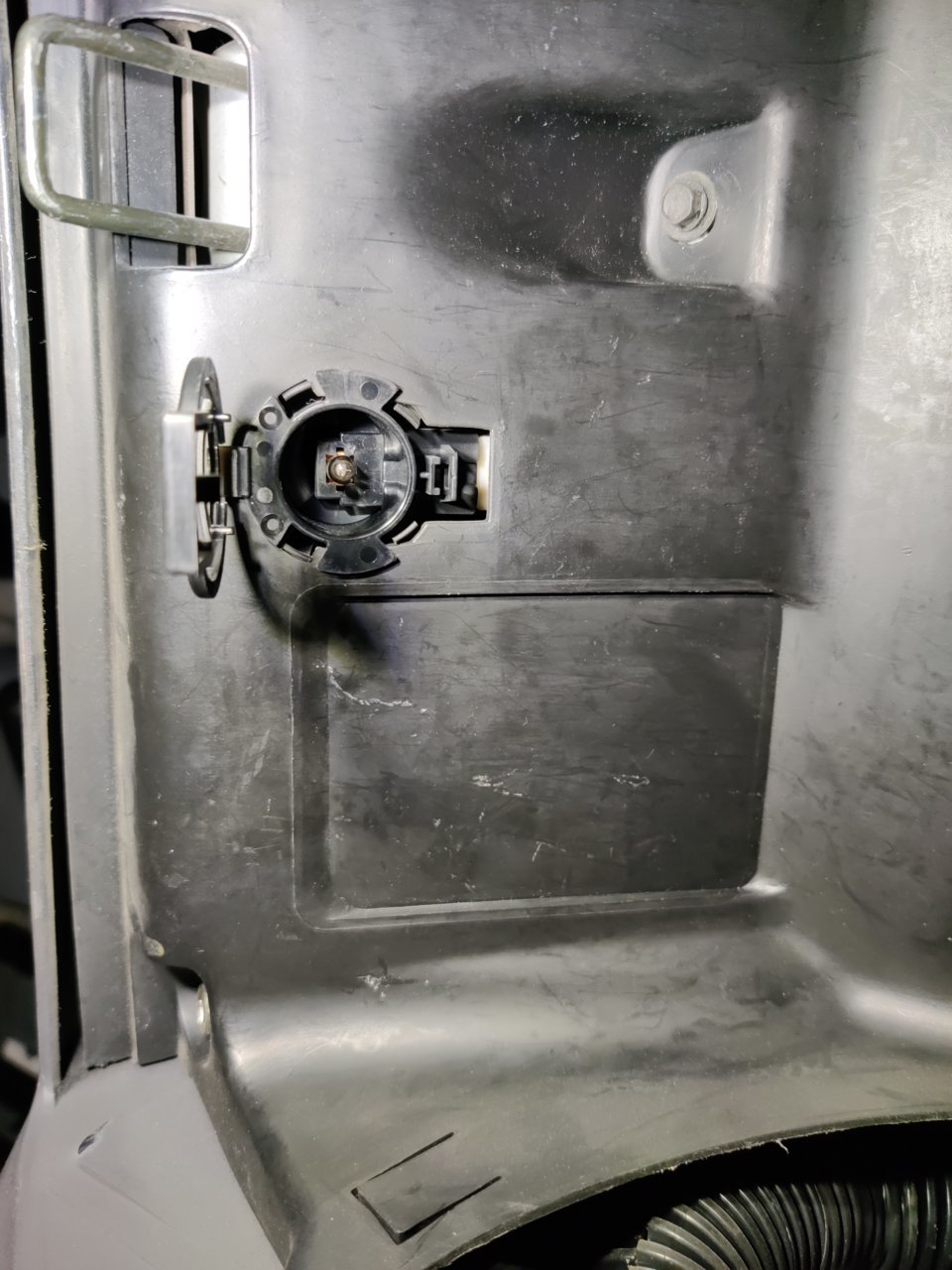

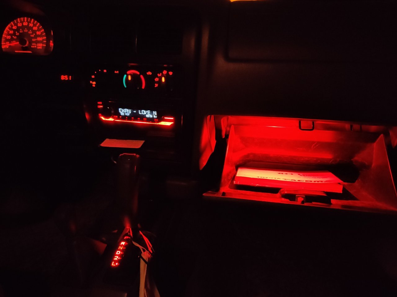

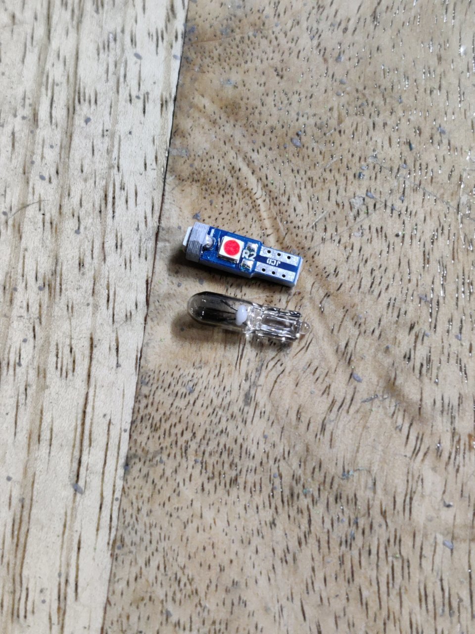

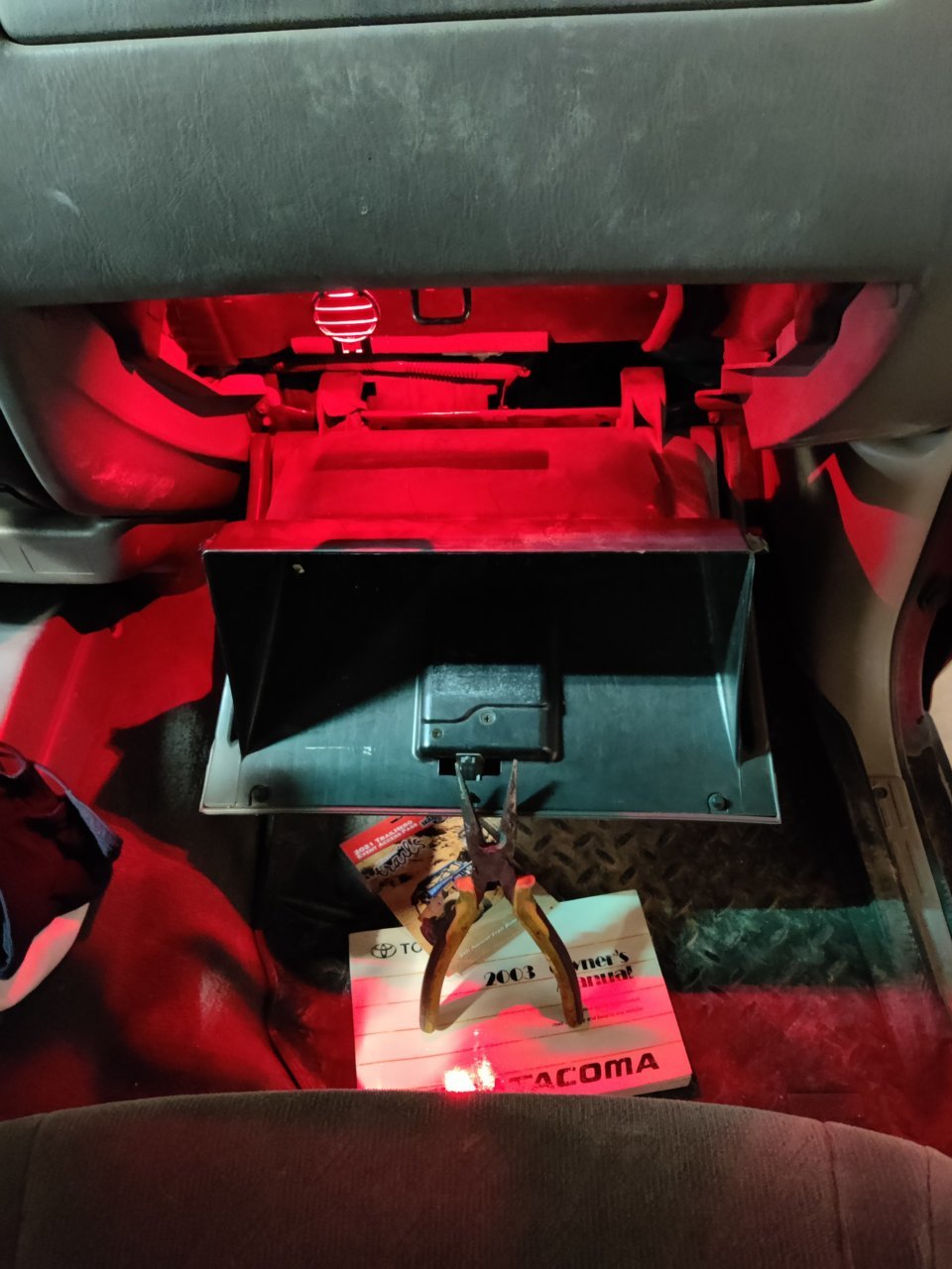

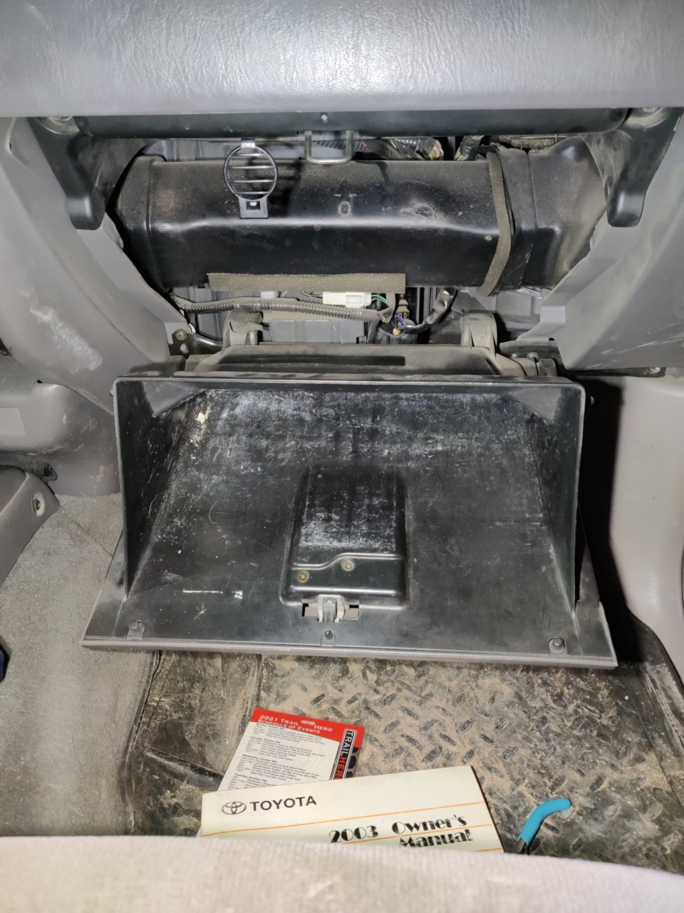

    Well @Sicyota04 was kind enough to point out that my glove box light was burnt out. I had no idea it even existed. Lucky me I bought a pack of T5 / #74 bulbs
    I used some needle nose plyers to gently pop the bulb out, I'm surprised it didn't break

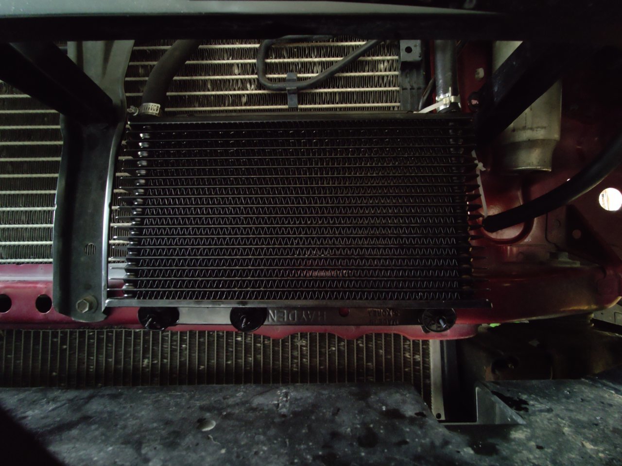

    Installed a Hayden 677 transmission cooler
    I still need to mess with the mounting a little but it's functional for now.

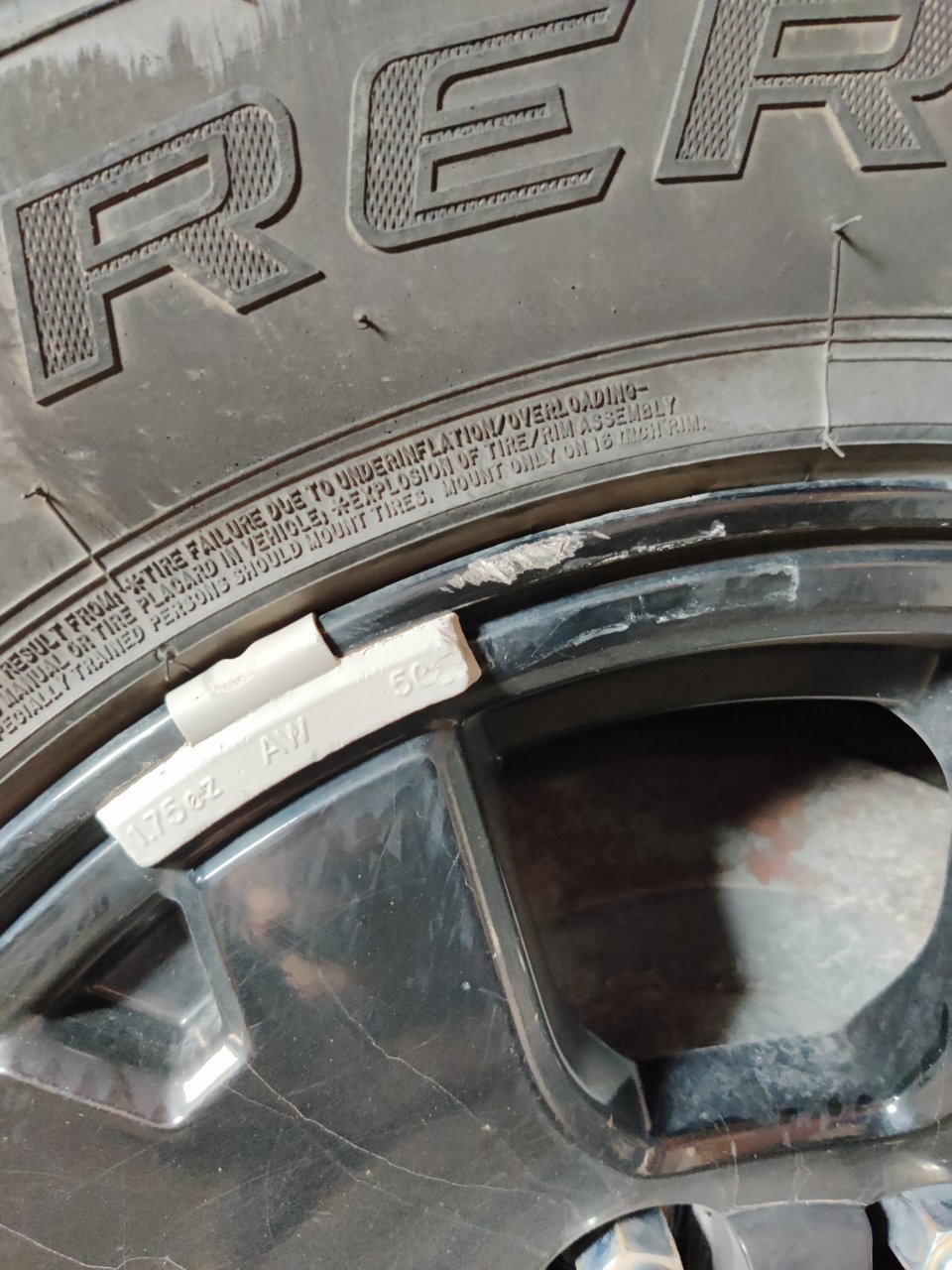

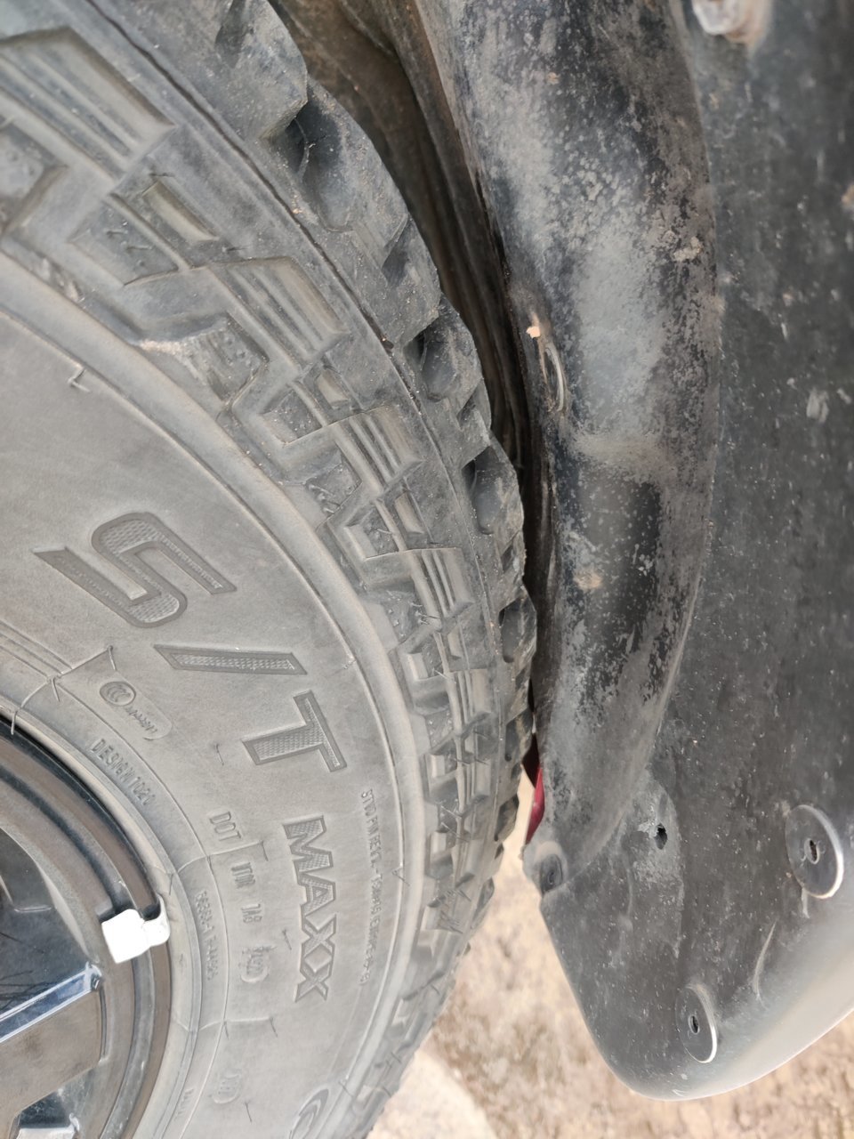

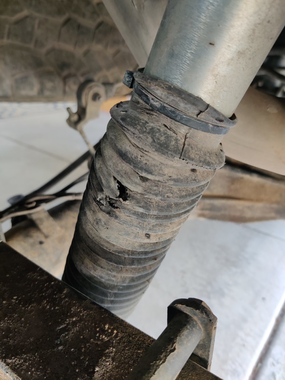

    Played around on some local rocks that the W.E. Rock crews use for the Cedar City series
    Probably one of my new favorite pictures of the truck
    Experience some slight rubbing
    And ripped a dust boot
    Nicklovin and MarX like this.

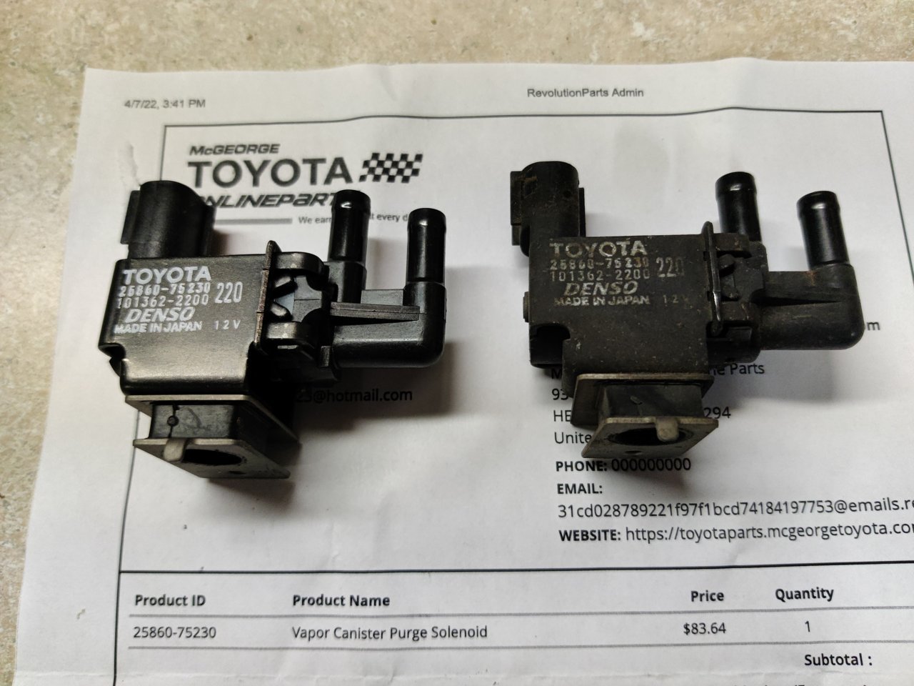

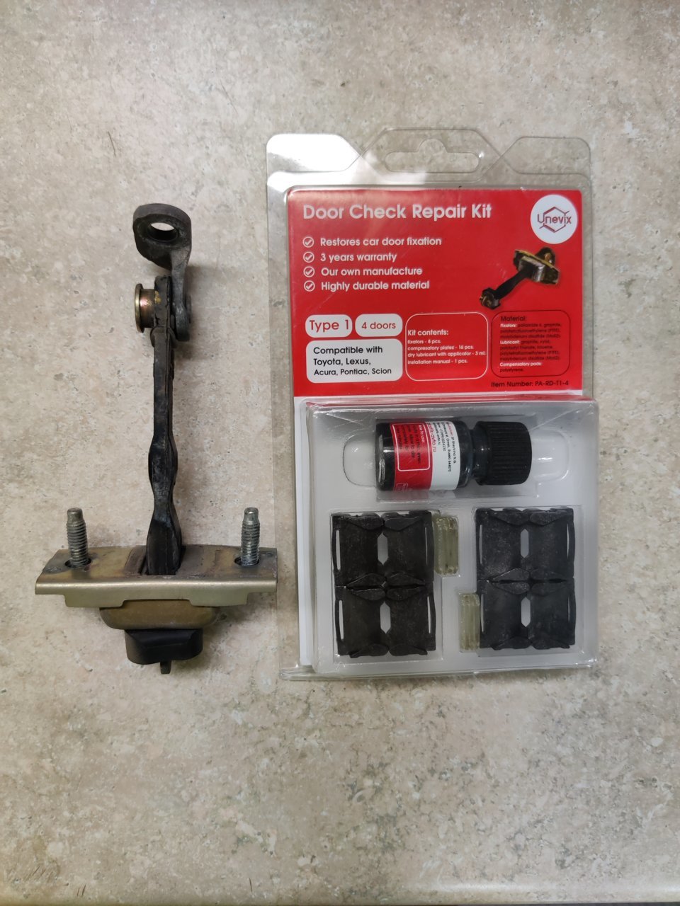

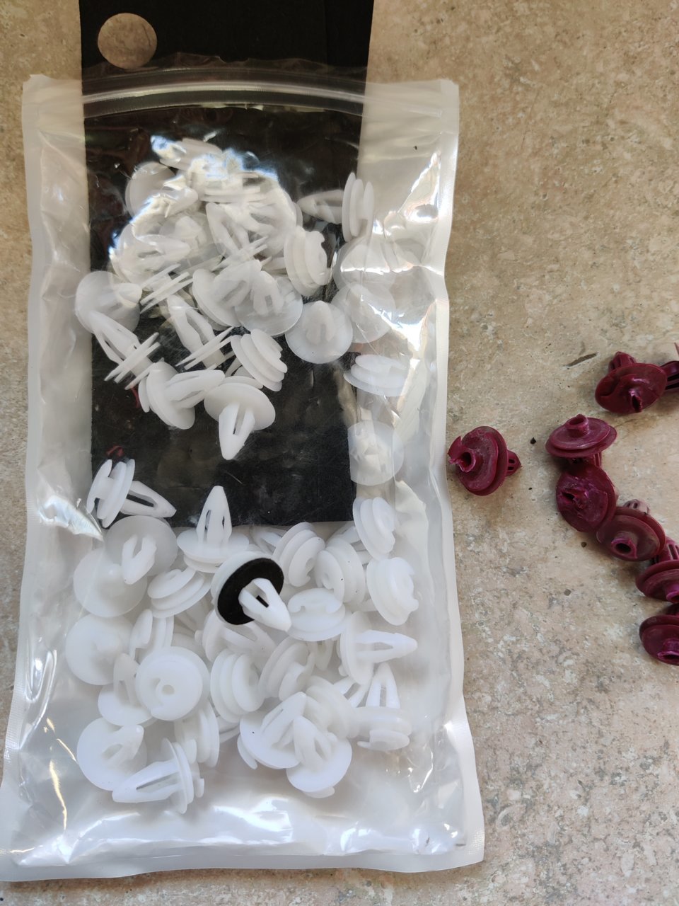

    Removed this for now
    Replaced a handful of door panel clips
    The door rattles less, confirmed by a little desert fun
    It's been a while since I swam in this little local man made puddle.
    There's a gate blocking the was most of the time now and honestly Im not surprised. I've dumped water on abandoned fires out here more than once. the most recent included a text book and someone's notes for nursing school.
    Oh and my P0442 check engine light came back on. :violent:
