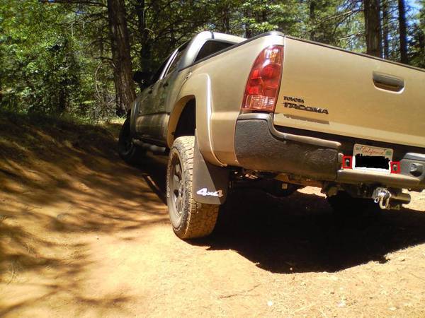

    [​IMG][​IMG]Mine are placed around the license plate(circled in red ;))
    I like them there very accessible for airing them up and really not too noticeable.
