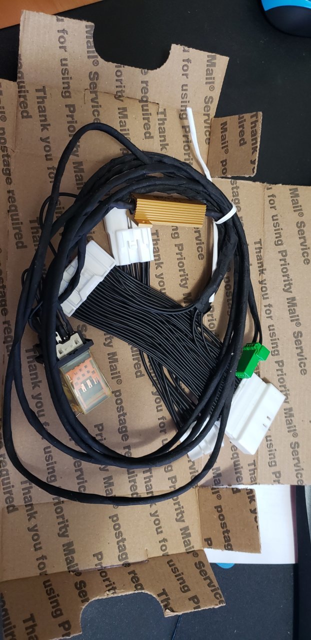

    You can do it yourself with the info in this thread, or you can buy one of my plug and play harnesses. Those are pretty much your two options.
    I have yet to hear a single complaint regardless of which way people have gone. It's a worthwhile and very useful modification if you regularly tow, have a heavy truck, or just hate having to slip your clutch all the time.

    Basically now that it is available in PnP, nobody does the DIY splice method here, instead just purchasing the PnP version... (this thread was developed before locating a source for mat connectors to make it PnP)

    Got my switch and PnP harness. Ready to go. I also ordered a fog light switch and rear light switch so I can pre wire those at the same time I take apart the dash for the switch installation.

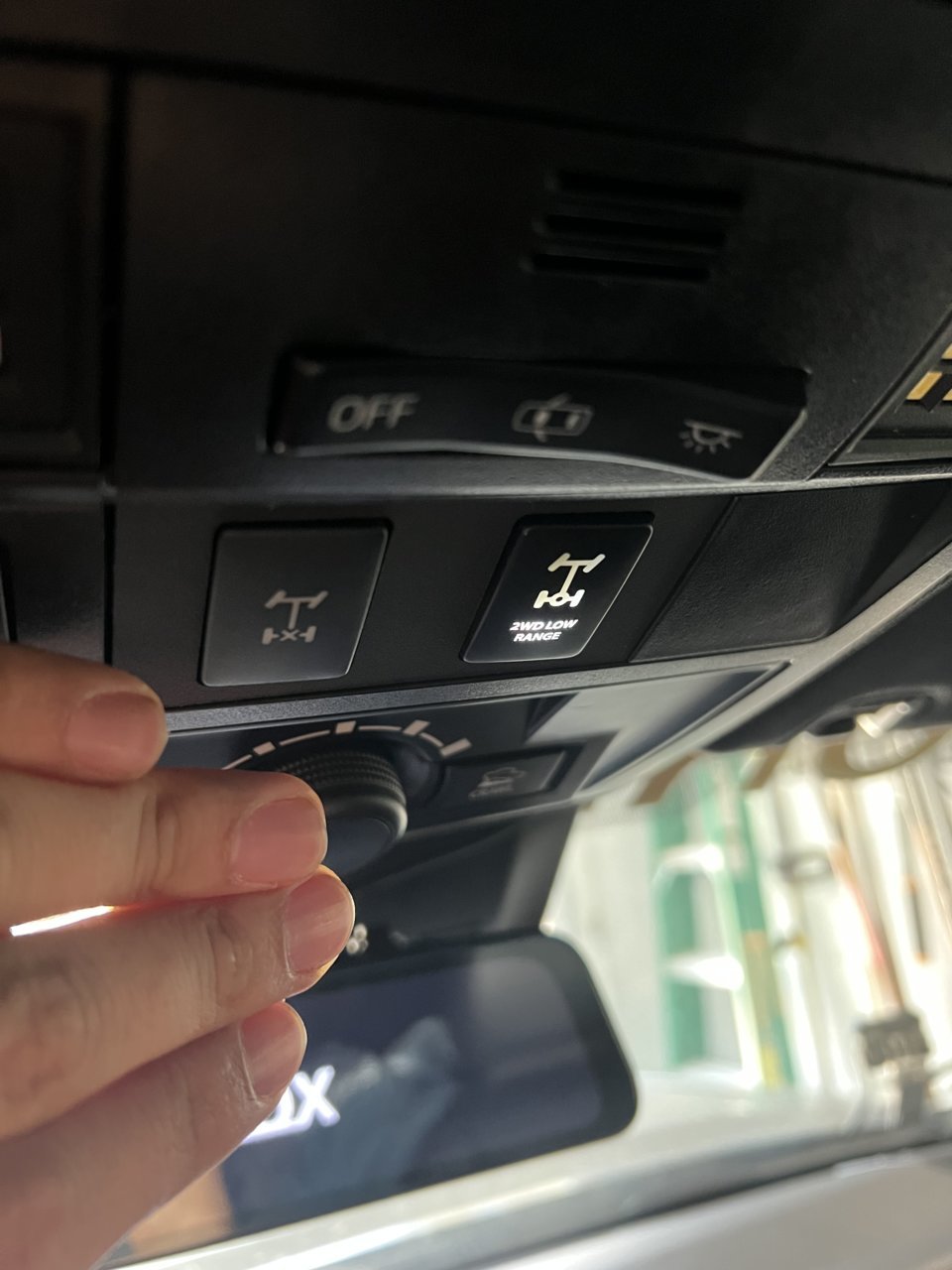

    So I hooked up the pnp system, and got a 2lo switch installed. The light on that switch is constantly illuminated.. anyone run into this and have a fix?

    This is normal. Text is always on. The symbol will light up when you activate the switch.

    got ya, I just read in the discussion post that a guy just taped over it.
    I suppose tapping into a different accessory line could change this?
    Not sure if worth it lol

    You can grab an Ill- wire from one of the nearby switches and connect it to the switch ground wire. That will get you OEM dimming and on/off with the headlights.
