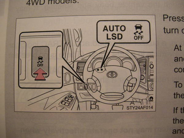

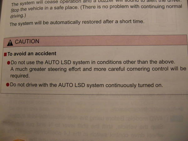

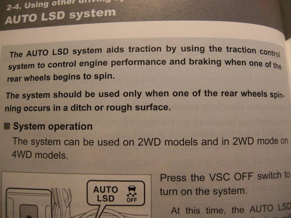

    Hi!
    No I don't have the TRD Off-Road, but the TRD-Sport version. As you can see in the owner's manuel, it's written explicitly not to drive with these system "off" all the time(LSD-VSC"Off"), just like you said. I guess it's not like the real "locker" system, but it's something close to it since they say a greater effort will be necessary to turn the steering wheel with these "off" (see "CAUTION" section). You're absolutely right about the warranty. Anyway, (like I said to my dealer!) they'll find anything to tell you that you are not coverted by the guarantee for this or that because you "played with it!".
    [​IMG][​IMG][​IMG]

    Yeah, the TRD Sport doesn't have the locker. The 'locker-on' mod wouldn't apply to your truck. The Auto LSD system is a totally different thing than the locker.
    But I definately learned something - I *thought* the Auto LSD was automatic and on constantly - kinda like the ABS/traction control/vsc. But according to that picture, they don't want you to use it unless you have to. Weird....
    I'm glad I got the mechanical LSD. All those electronic stuff is baffling.
