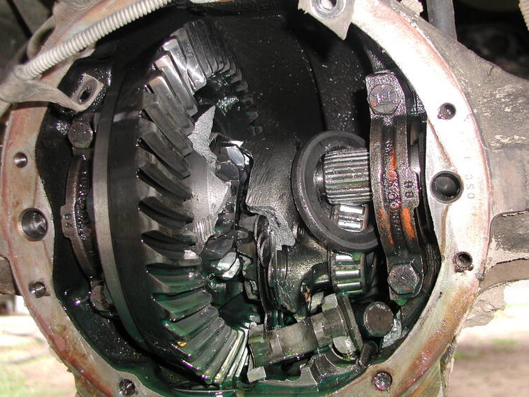

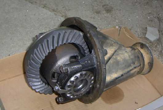

    This is not a new axle. It is simply new to the North American market. The locker that is used in them is made by an Eaton subsidiary for Toyota.
    Unless your uncle swapped in a Detroit locker his Sierra he has what is known as a "Gov lock" or "Gov bomb" which is the Eaton G80 centrifugal locker. They are weak, dangerous and tend to fail at the least opportune time. IMG_2901.jpg
    Eaton G80
    The reason they are called a "Gov bomb"

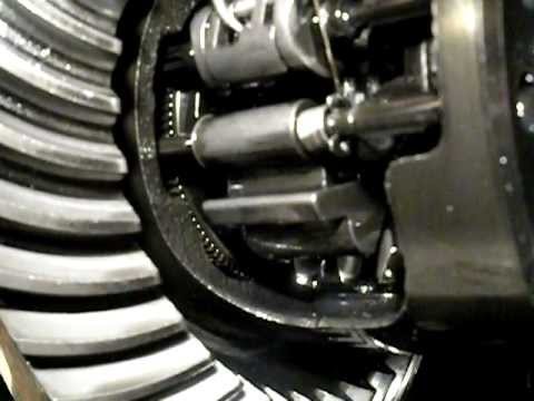

    Eaton Detroit lockers are as stout as they come but when they unload the tension on the lock plates and unlock in a turn it can get tricky/spooky. Not to mention that they are noisy.
    IMG_2904.jpg Eaton Detroit locker in a Toyota 8" 4cyl diff housing.
