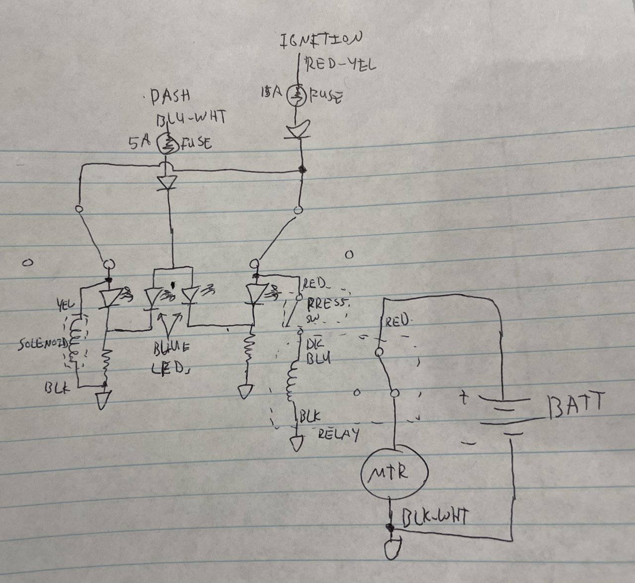

    @ClassyTacos inwatched your video. I also used a ch4x4 switch and my air compressor works flawlessly
    my front locker switch I think fried when it got turned on the first time since it locked then wouldn’t unlock. Sounds like a failed short scenario. Did you add a relay for the lockers?

    I ran continuity nothing in the loom is shorted to ground or to any other wire in the loom. The only issue I can find is the switch which is shorted.
    When I have the switch installed I immediately get the full voltage on the pressure solenoid before I even turn the compressor switch on. I was getting the pressure release when turning off the compressor, which makes sense if that switch for the locker is shorted.
    The top switch with the compressor activation has worked perfectly for months and still works. Just now that the second switch is welded shut the locker is also activated and I can smell a burning smell. I think this was the illumination diode.
    I posted my wiring here, look correct?

    Got it working now. I had to add a relay. The inductive solenoid load was frying both illumination diodes for the bottom switch by forcing current in the reverse bias direction (inductors don’t allow step current changes). Put together a detailed schematic. This is what caused the failure.
    the key difference in dual vs single switch is that the ARB harness has a protection by providing switched power from the isolation switch to switch 1 (my front locker). Using a dual switch both switches are always powered. In theory it would work since you need air to turn on the locker anyways but there must be some circuitry I wasn’t able to reverse engineer that causes the failure.
    Adding a relay restores that relationship and bought one from CH4x4 with a resistor to protect against surge voltages. All that it definitely is ok now. Only weird thing now is the bottom switch turns on blue and green leds when on. I’ll have to think why that happens but it seems not to be a problem at this point.
    overall the dual switches definitely seem to have some nuances to them vs the singles since yours haven’t failed. If someone ships me one I can rip open and destroy I’ll post the schematic up. :thumbsup:
